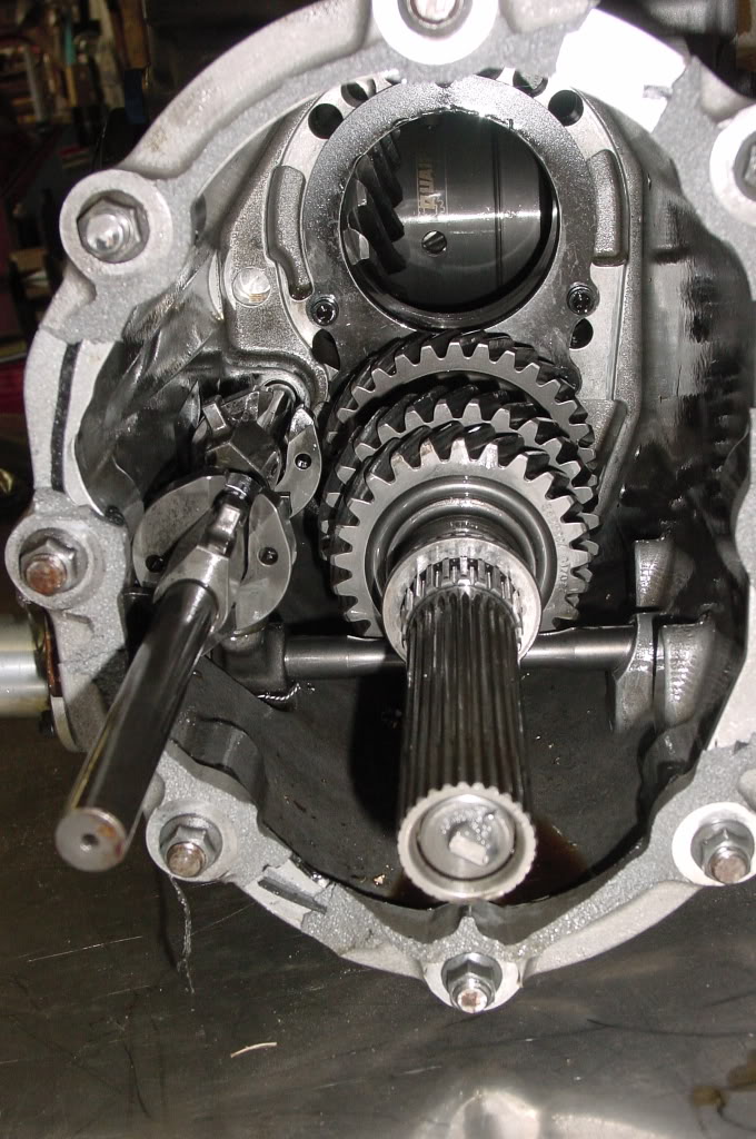

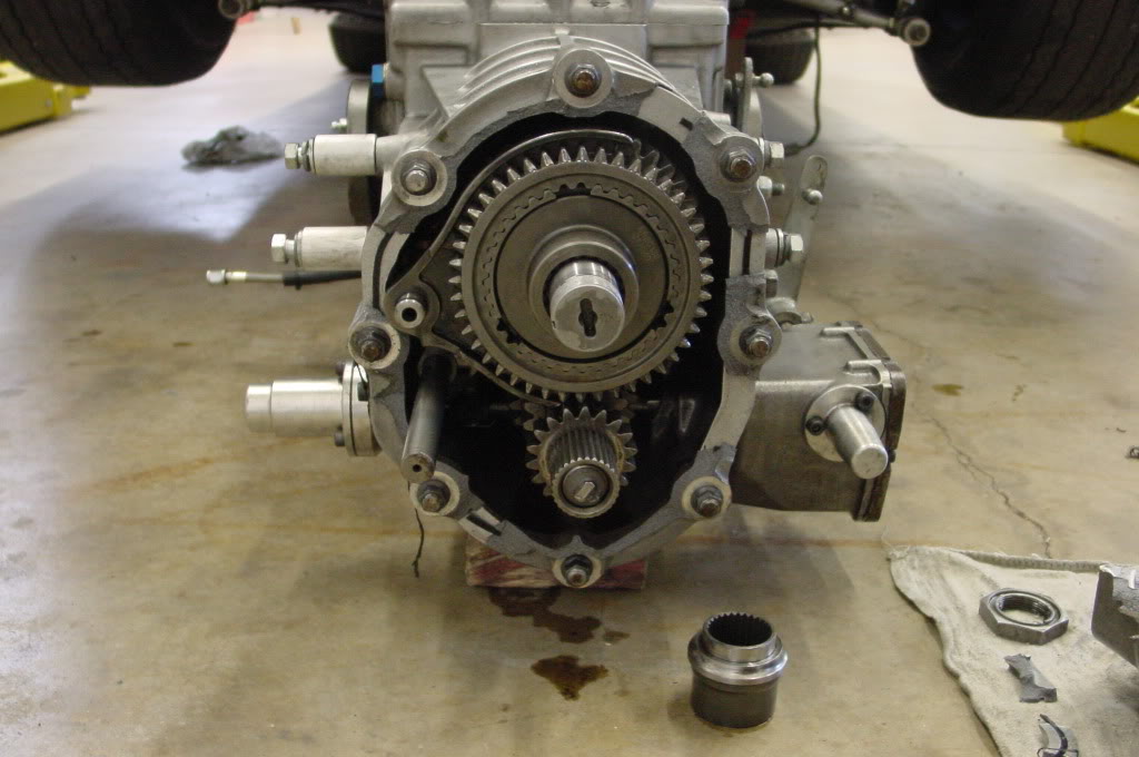

ZFQ did have some early problems with the nut at rear failing under heavy load which allowed shaft end play & bearing preload to relax. I believe there was a change made to help fix this. Attached pics of lower shaft breakage, this trans may have been subjected to some large forces imposed by the nut behind steering wheel and should not necessarily be seen as a ZFQ fault, however IIRC there has been more than one instance of this type of failure, not necessarily to the same amount of distruction.
