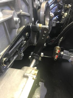

Getting ready to start setting up shifter and cables. I know little about these transaxles and would like some info on the gear selector on these and what position designates 1st thru 5th gear and reverse and how they are selected. Hopefully one of the transaxles guys can educate me.
reverse, second and fourth gear are toward the front of the car as pictured. Obviously reverse is fully anti clockwise on the selector when viewed from the rear as per your photo.
