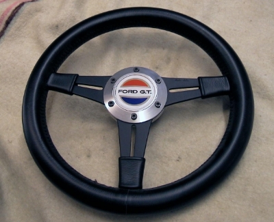

I have decided that my car will have a quick-release steering wheel as a safety feature to facilitate ingress/egress and as a theft deterrent. The quick release will use spline drive rather than a hex drive, and ring release rather than pin release. It will also be as short as possible. Hershal had recommended that I look into the products made by these guys but their bolt pattern is for Momo and Sparco wheels and isn't available for 9-hole Moto Lita bolt pattern.
By the way, maybe I misrepresented the Moto-Lita bolt pattern to these guys in my email. My steering wheel has three pieces: (1) the wheel itself, which is attached to (2) an aluminum hub with 9 cap screws, and (3) a steel adapter with female splines which mates with the steering column on one side and which attaches on the other side to the aluminum hub via 6 cap screws. When I talk to a vendor of quick disconnects, do I give them the 9-hole bolt circle or do I give them the 6-hole bolt circle? Am I mis-naming any of the steering wheel parts?
The link that Andrew provided in the OEM steering wheel post does not work. Both Demon Tweeks and SUmmit offer a variety of quick disconmnects but I don't know which one, if any, will work best with my RF-supplied column and Moto-Lita wheel. Do I need to ask Frank Catt to machine a special adapter for my setup? Thanks in advance for any recommendations you may have.

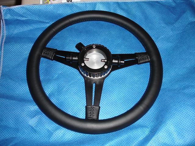

Mark / Peter, See attached pic of finished front of unit, the quick release unit is designed to fit the standard Mota Lita steering wheel, has custom made front and rear adaptors to fit to a SPA quck release steering mechanism, with a splined spigot shaft that is welded onto the end of your existing column, not useing the splines you already have. About $500 not including the badge, or carriage.

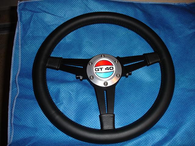

My RF-supplied Moto Lita wheel has 9 bolts rather than the six on yours, Frank. Is this an unusual variant? Peter, does your RF Moto Lita wheel look like mine?

I did not dissasemble the wheel on RF80 but it seems to be the unit Frank shows in his picture with 6 screws. This caused me to look back on my build site for RF90 because I throught it had more screws. As it turns out the wheel on RF90 was like yours Mark with 9 screws.

Hi Mark, I recently modified my same wheel(last Month). I ordered a fine spline quick release hub from Summit Racing and enlarged the splined hole. Then drilled the mating holes through the modified hub being carefull to center. Then removed (chop saw)the threaded portion of the steering shaft and welded the male splined portion of the quick release. Works beautifully!
I can provide more details if you like. Regards, Jim
