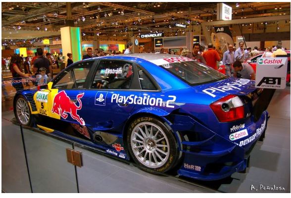

Your thinking to high. Do the DTM thing and put the vents at the bottom:thumbsup:
Sure, you may need to fab a shorter door.

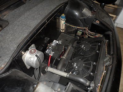

Thats OK Tom! A pictures worth a thousand words! I've found 914 V8 conversions that vent the hot air from the radiator into the wheel well. Talked to a conversion guy about it too. He said even though the air is hot its still much cooler than the brakes. So brake cooling is not an issue.
For an all out race car im sure that wouldnt be great though. Seems theres always vents on top of the wheel wells. So adding pressure to that area probably wouldnt be advantageous either. Maybe vent it just behind the front wheels like the picture Doug posted. Was considering Has anyone ever shaped the wheel spokes into a high efficiency fan for drawing air from underneath the car? I think i've seen porsche wheels that function that way or was for brake cooling.... not sure. Anyways....def want a high pressure source of air for cooling. Thanks for the input!
I like it! Looks like the driver would be in a super reclined position. I once saw an article about the GT40 and how the air was originally routed through the car was costing them "x" number of horsepower. It was a good amount! Someone came in and made it much more efficient.

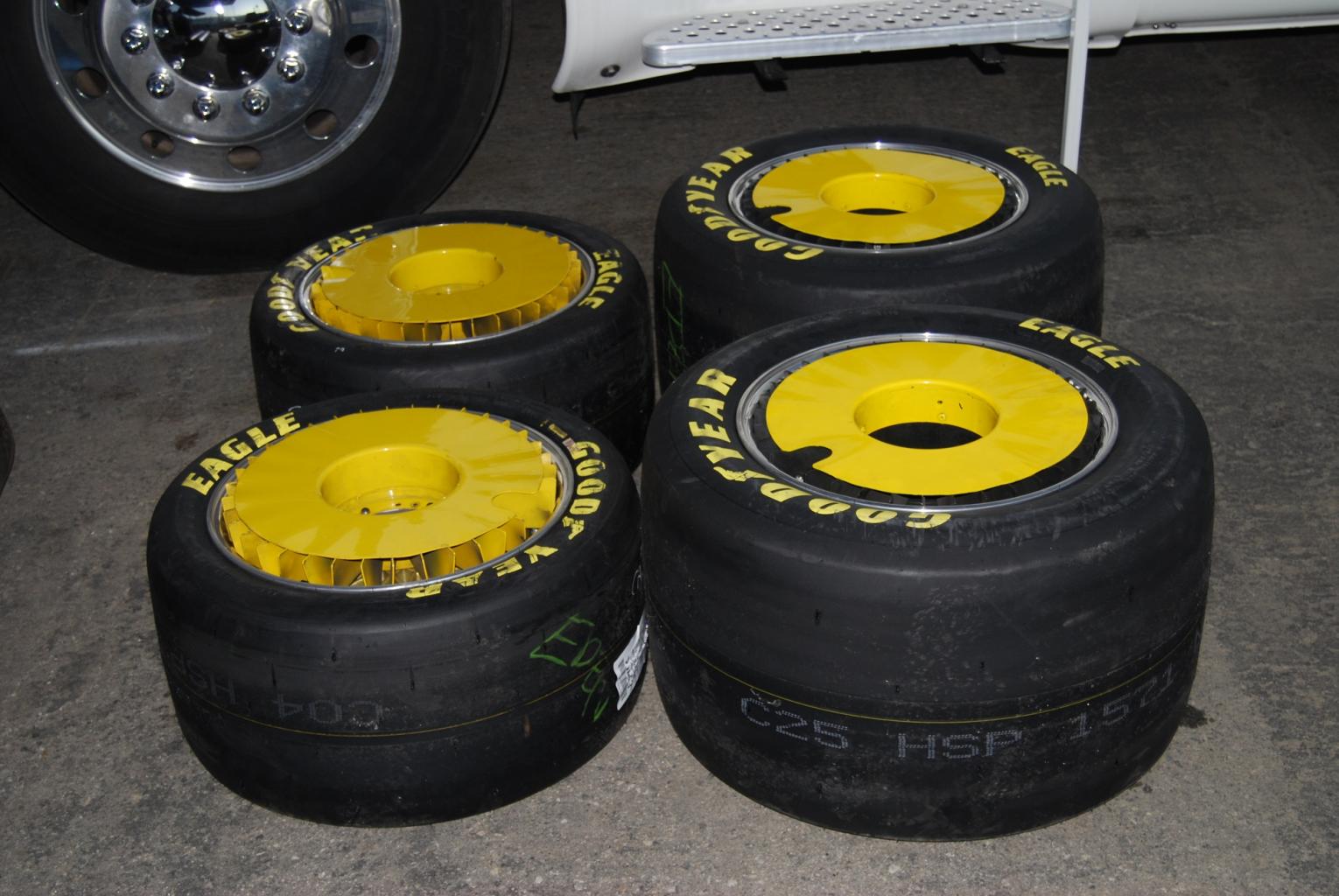

The Corvette C4 for one had them. I loved the idea and I am not sure why it fell out of favor.
If you are using a front mount radiator, I did like the thing the Porshe 911 was doing for a time. They had the radiator vents directly in front of the front wheels. The worked great as a aero front air dam that only worked at speed. I think it fell out of favor because you tried to get the air to turn a sharp corner to get to the exits, and air does not like to turn sharp corners.
Like a read once (paraphrased): without a fan you cant make air go anywhere, you can only suggest where you want it to go.

my old M5 has directional wheel covers to help extract air out of the rim, and pull air across the disc I think.
I know the Gardner Douglas guys had a wheel with a fan shaped center section, don't know if they are still producing them.

Spud I know what you mean about mounting complexities. Im trying to stick with the KISS principle. Keep it simple stupid. It seems the simplest design is usually the most elegant and efficient way of doing things. Found a picture of 956 wheels that look like they're designed to extract air from a wheel well. Doug....thanks for the pictures and the input. I think your right about the nature of air and fans. Many Jet engines designs make the air go around some very sharp corners! Garrett TFE731 is a good example.
