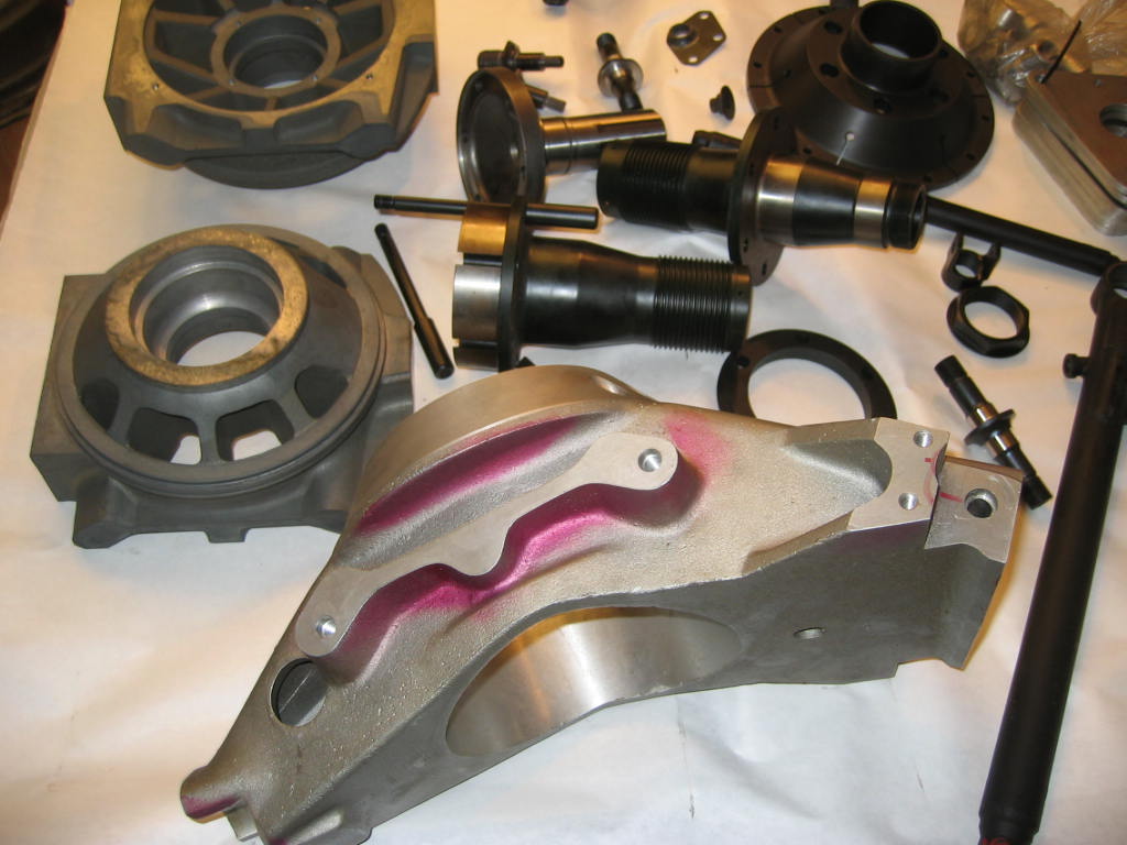

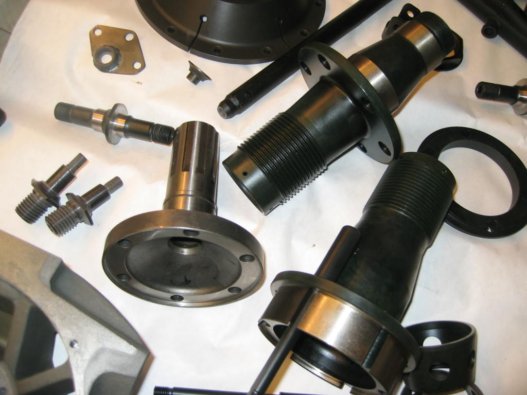

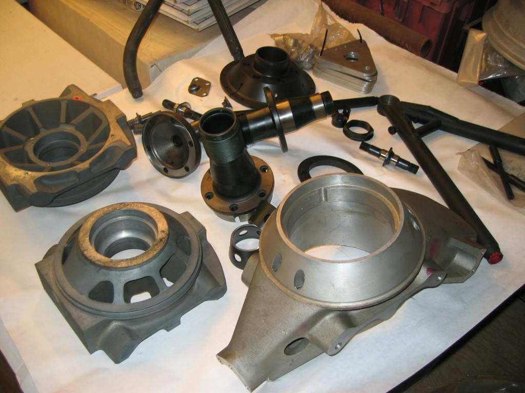

If you are up to adapting these rear uprights to your chassis, they might be suitable. They are a pair of cast aluminum uprights that were spares for a Ferrari GTU race car. I bought them from Joe Huffaker in California for my black Mirage homebuilt but I wound up using 5- link Porsche 996 rear uprights instead. The uprights are NOS and the hubs use Porsche-style Rzeppa CV joints. I can supply a set of Timken hub bearings as well.

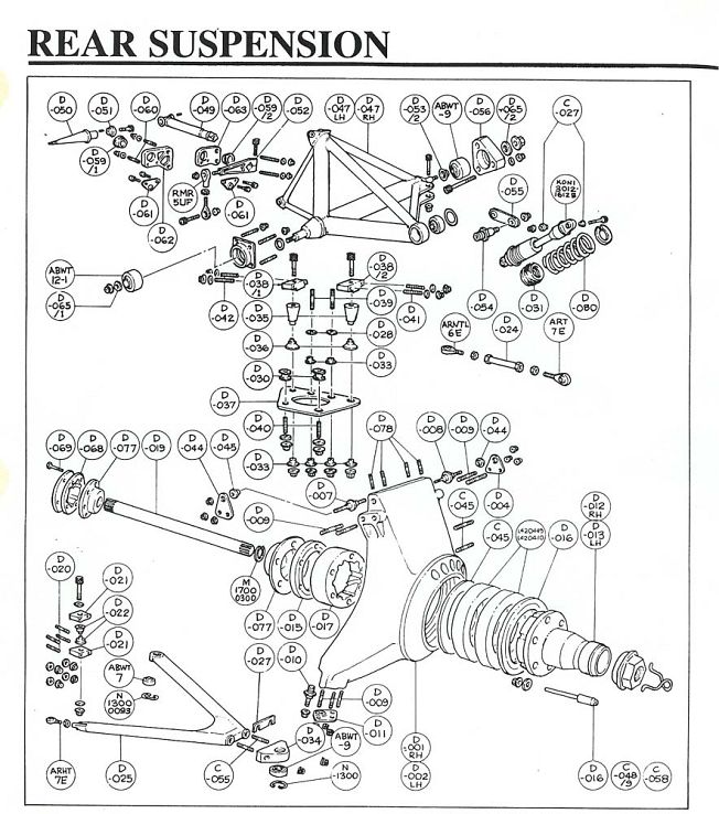

These drawings and photos show the rear uprights and ancillary items but there are also other items such as front uprights, suspension arms, rod-ends, etc that are NOT included. I will try to find better photos of the the rear uprights. $925 for uprights, hubs, & misc but not including the bearings.
