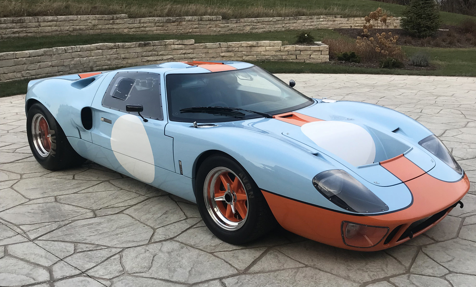

Is there a generally accepted/optimal ride height for the Superformance MKI? If so, how is it measured (center of . I just took delivery of P2388. Perfect timing as 2 hours after rolling it out of the trailer, the snow came. So I now have to wait until Spring for the real fun to start.

That is a stunning paint scheme, its what I want on my 40, was in two minds as to which way to go but having seen this beauty my mind is made up, cracking car Cameron. Love the wheels as well, well frankly love it all :)
