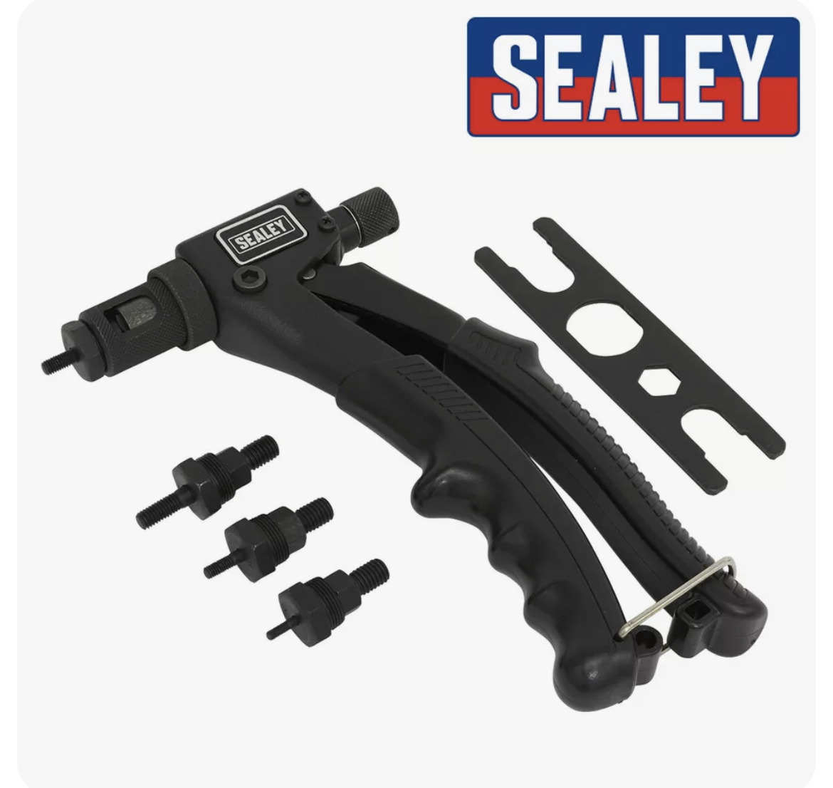

I have been using this one for my car build. It’s available in standard or metric versions. I use 10-24,10-32 and 1/4-20 riv nuts.

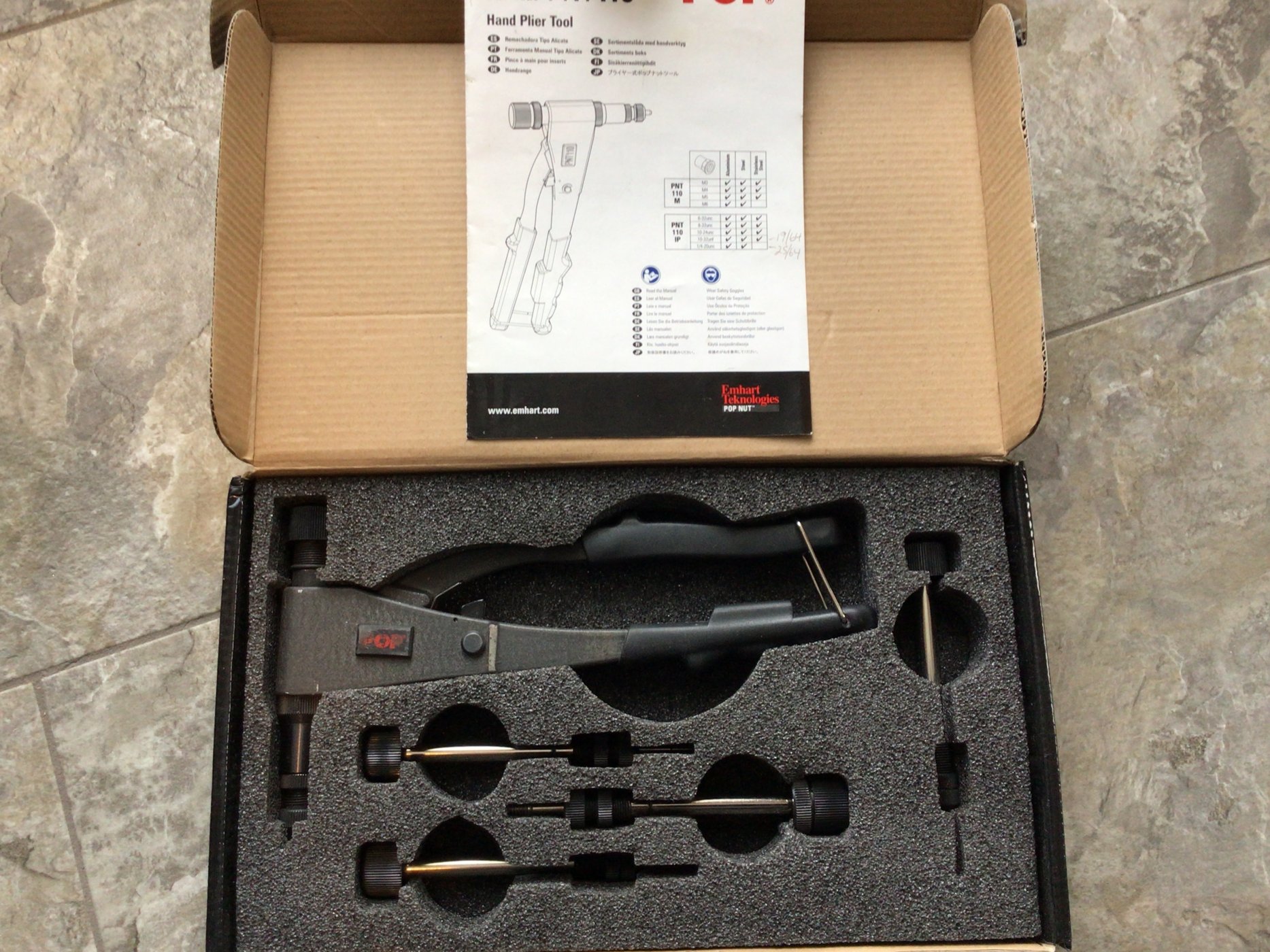

The rivnut tools I’ve found working well.
The small one is good for up to M5, the bigger for the rest.

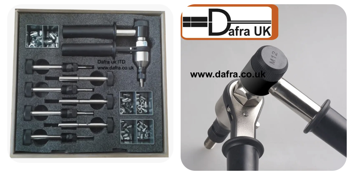

Wurth also have a nice ratchet one.

What about accessing areas? It seems like the smaller ones would allow for use in tighter areas, but you wouldn't have as much leverage?

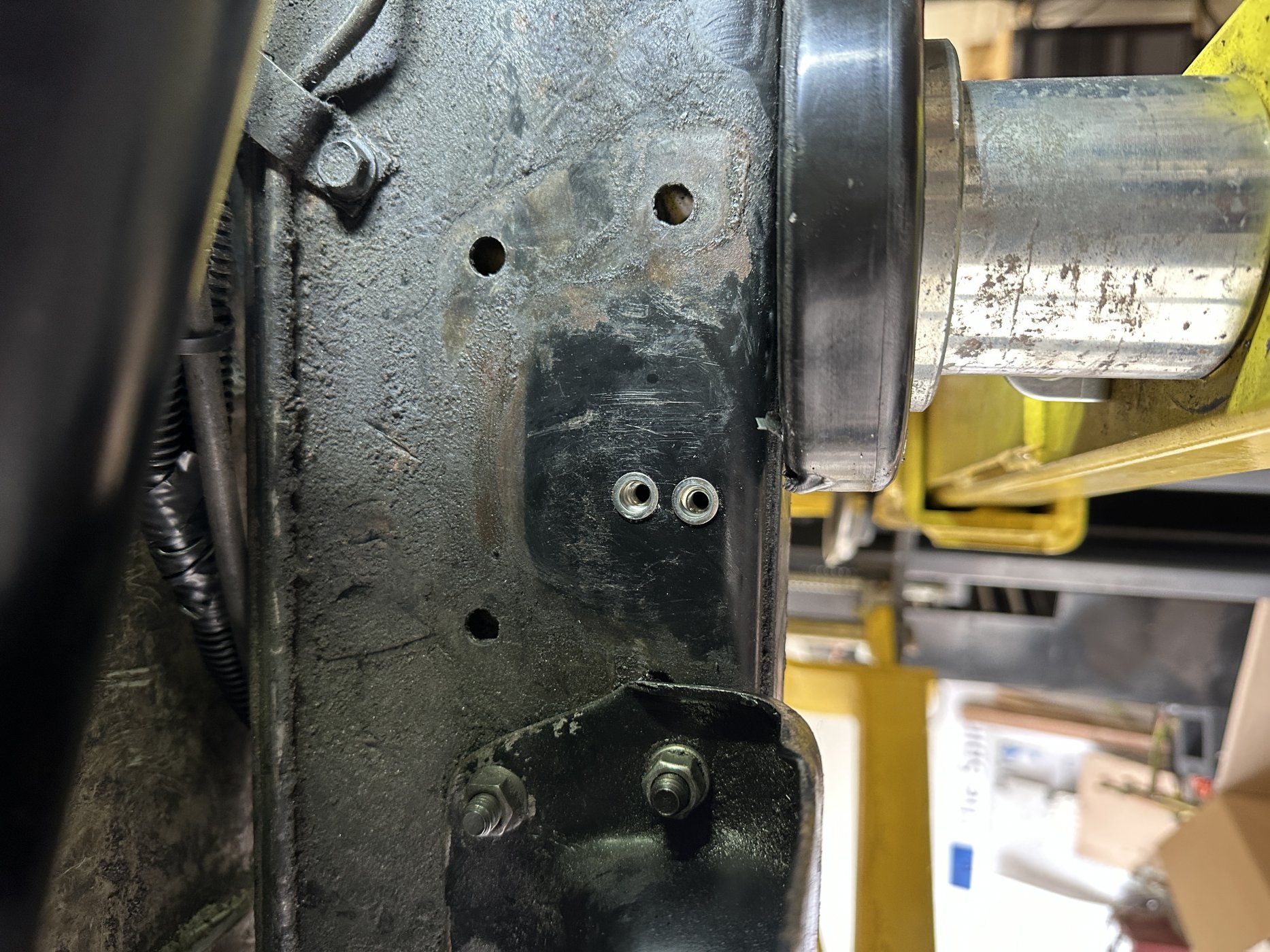

You would also not be able to use the larger rivnut as the small gun is limited. The small stuff i drill and tap if need be. I like having the more variety of sizes/use. But for the most part im able to get where it needs
Not sure how i feel about that personally but everyone different lol. For my use im happy with my choice. I have yet to use a rivnut on my 40 build though. The chassis and aluminum thickness is plenty to drill and tap.
