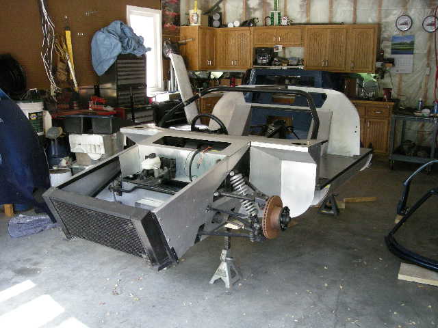

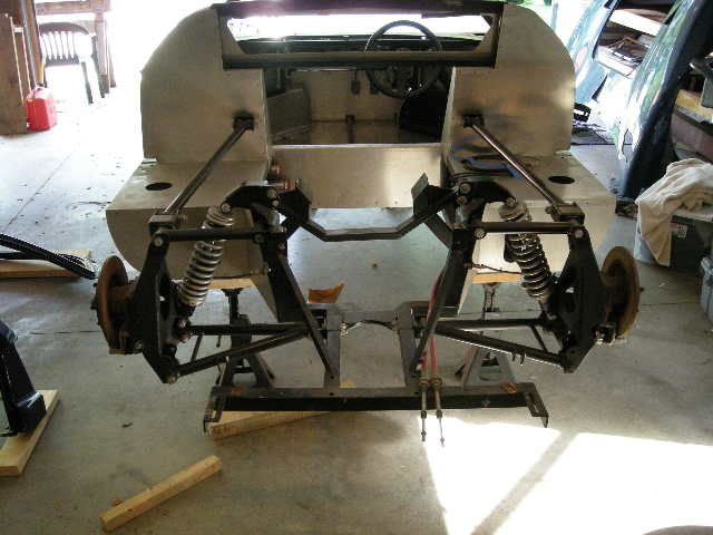

These are from my build ! I had a lot of experience putting mine up and down on Jack stands. The best advice I can give you is do it in steps not all the way up in one attempt! Also make sure you put your 1st set in perpendicular to the frame that way when you raise the other end your not pivoting on just one leg of the tee on top of your jack stands !!!
