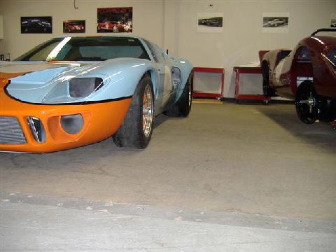

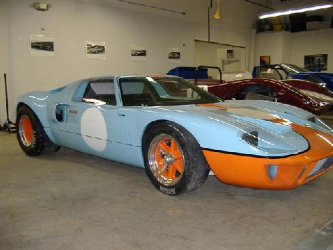

Here is the start of the build thread for my RCR-40. The car is currently being built by Fran to the Rolling Chassis stage with the body and gulf paint being completed. I'll post what I got from Fran. Some things are still pending, roll bar and some of the fastners for the plastic amongst some of the visible.
The are presented in random order, some with the single and dual snorkle hood.

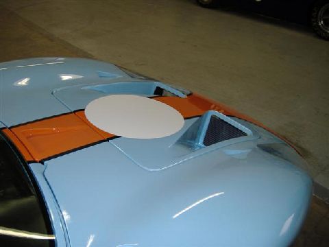

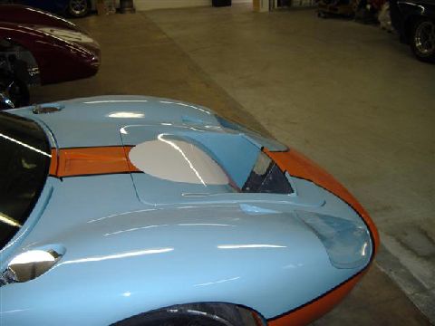

A couple of the different hoods.

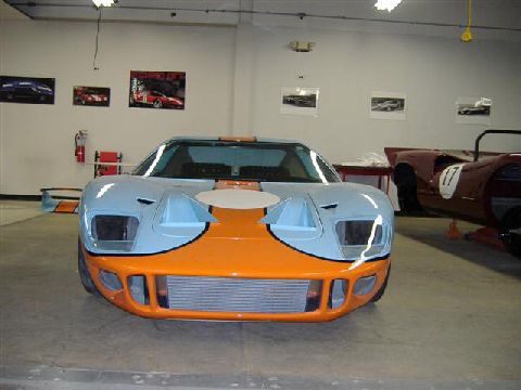

Sandy
Gulf GT40

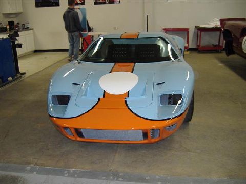

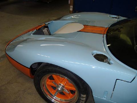

Front and side views

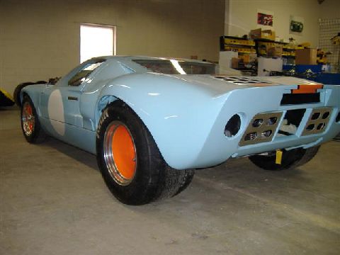

Sandy
Gulf GT40

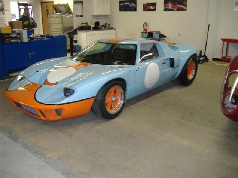

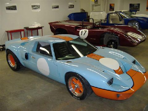

Side views.. Ignore non-Gulf car in background :)

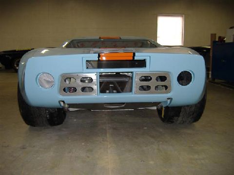

Front and Rear (No engine in car as yet)

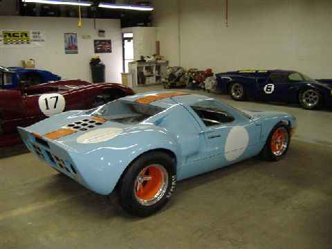

Sandy
Gulf GT40
Back and Front

BuzzMarr said:
hey there.... is that the 17" flare package?
I don't know if they are 17", but they are Gulf size. The tires are 14" wide Avons and they look like just about right. I think I can squeeze a 15" width tire, but then the diameter goes down a bit, and my gearing in the 930 box is low enough.

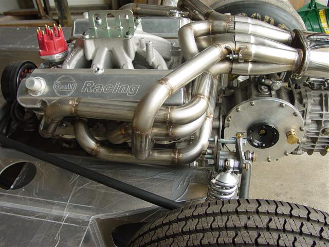

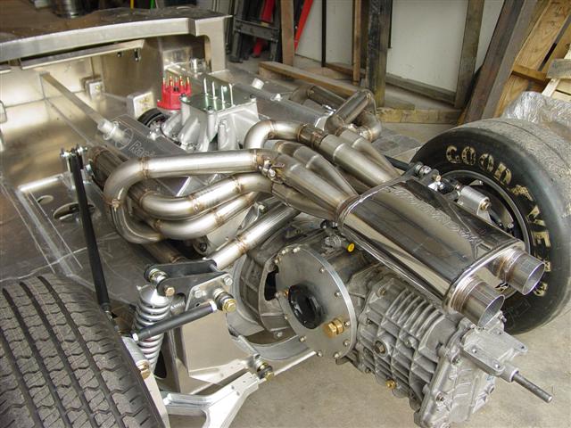

I am copying a couple of the engine/trans images here to start to keep things together.
These are the custom 2" SS headers that Fran came up with. I had them made more like the 427 style (squared off looking) as that is what I favor.
The trans is a PowerHausII 930 box with modified 3rd/4th gear ratios, full oiler, and some other nice things to hopefully keep it together.
The engine specs, from the orig thread
(http://www.gt40s.com/forum/tech-engines-induction/17165-numbers-just.html)
Peak 618Hp/468lbsTq at 7400rpm

347cu Motor, Edelbrock Victor heads/Intake, Dart alloy block, Bryant crank 3.255", Dyers top rods, Comp Camp solid roller, Jessel shaft rockers, 850cfm worked over carb, dry sump.

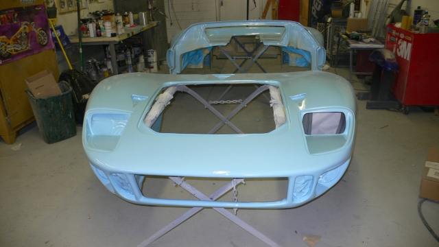

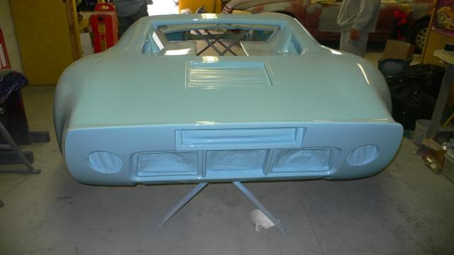

Here are a couple sections of the body in the paint shop. The thread is running in reverse as it seems :)
