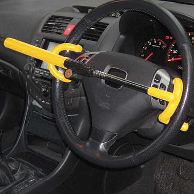

Is the steering wheel lock required for anti-theft reasons? I'm trying to figure out the logic - even though if those are the rules... so be it.
Could you somehow present the case that you use one of these - picture below and or the steering wheel gets removed - if it's a theft thing.
They must really go over that car if they could see the marks on that lower control arm/knuckle area.
Locking columns are over-rated. Look at the recent rash of accidents/deaths here in the USA related to the failed ignition switches that locked the steering.... while the cars were driving down the road!
