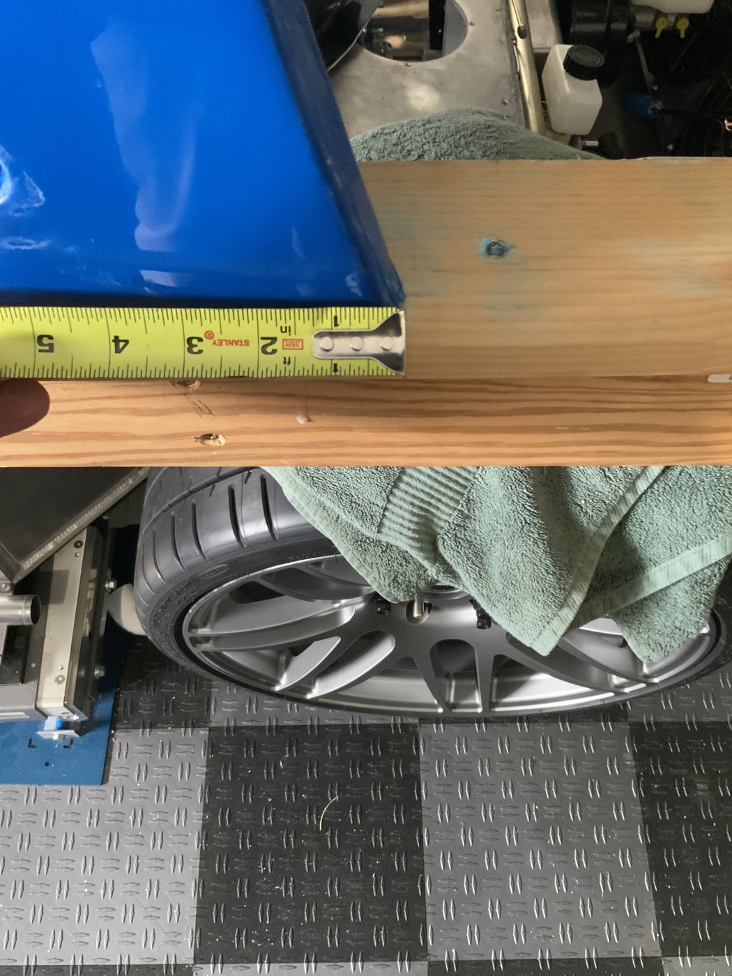

Joel provided me with the actual measurements that I was looking for. Thanks sooo much Joel.
Unfortunately, the side skirts above that I like so much are 3 inches too short. The search goes on....
