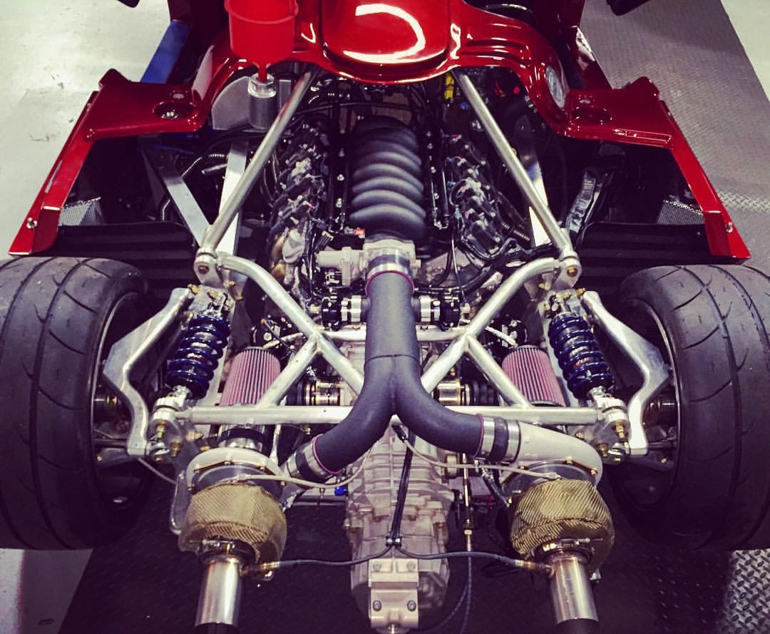

Odd turbo orientation - the exhaust must have quite a hard turn entering them. It must work though. The asymmetry of the turbos would drive me nuts, but that's just me (and expensive to change for virtually no gain).

This setup is the temporary build using the LS376 crate motor that was installed prior to their recent acquisition: they installed twin 67mm precision turbos, 1300cc injectors running C85 and an AMS 2000 boost controller to get the project going and on the road. Currently being built is a 427 Dart II tall block, inter-coolers etc.....
Anyone have more insight as to what the actual HP was as run, if adding more boost/power was an option (and if so, why wasn't more added), how much traction became a limiting factor, how the car handled, etc?
