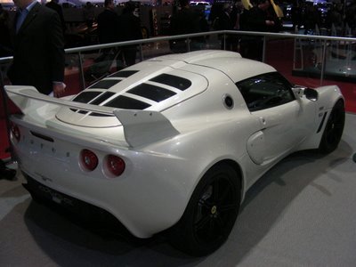

Here is the engine cover of a Lotus Exige. I am contemplating something like this though the vent shapes may be different to better match the contours of the SLC.
EFNFAST - that is definitely an option, just not what I am personally looking for.
Dave L

Hmmm, I dunno, something about the exige's back just doesn't flow for me - kind of looks like somebody just slapped it on there without much thought *shrug*
This looks like it flows much better =)
Dave Lindemann
I agree about the Exige. My plan is to redesign the vent pattern/layout to better fit the SLC. The challenge with the F40 style deck is that on the F40 it is "basically" a flat piece while the SLC rear deck lid has some major curves. Not that it couldn't be formed, I just think the look would be totally different.

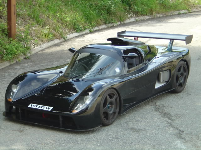

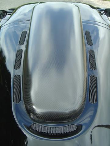

Well, if you can come up with some way to do something similar to an f40 (i.e., slotted lexan), let me know, I'd definitely be interested in that.
I suppose another solution would be just to have no rear lexan/glass in place. Enginebay might get a bit dirty, but atleast it'd have plenty of room to breath :D
Incorporate a scoop for fresh air to an IC that may even double as a fresh air intake for you boingers and I'd consider it.

Dave Lindemann
A few thoughts -
I'm stating the obvious here but everyone has their own sense of style and no engine cover design is going to appeal to everyone. I really appreciate all of the different ideas. My personal goal is to keep the design simple, functional and in keeping with the sleekness of the SLC body. I don't plan on doing fans - too much weight and takes away from the idea of keeping things simple. I wouldn't mind doing Lexan if I could come up with a vent design that I think would look good - so far I haven't been able to come up with one that "I" like - the challenge is the curvature of the cover. If anyone has a design specific to the SLC they like please post a picture or drawing. Though the design I have in mind doesn't involve Lexan, it may still offer some "glimpses" of the engine through the cover. No big scoops for me - sorry RX-Heven - though I plan to use the roof scoop to feed the engine bay on my car.
I'm close to starting on the prototype and here is my plan - it may work for some of you. CF structure with polished stainless steel vent material that is open enough to see through (obviously, not as transparent as Lexan). I'll be laying out the vent design this weekend and I'll post a picture or two.
