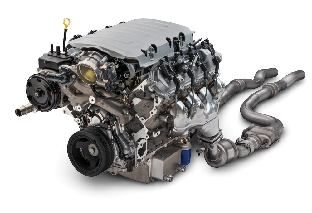

1)LS3 E-rod - 430 HP and 425 lb-ft of torque

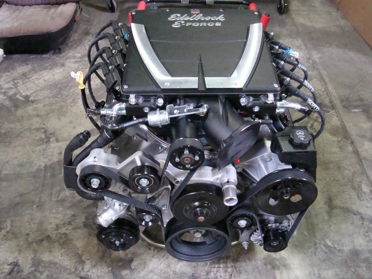

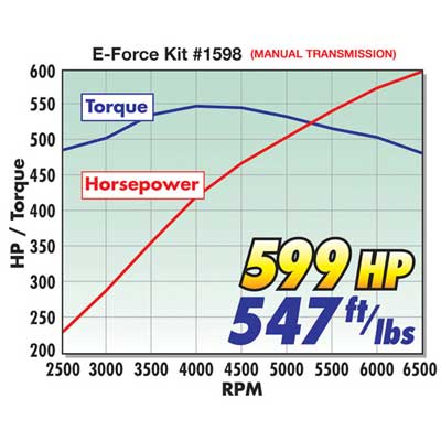

2)LS3 E-rod & Edelbrock E-Rod emissions legal Supercharger - 599HP and 550lb-ft of torque

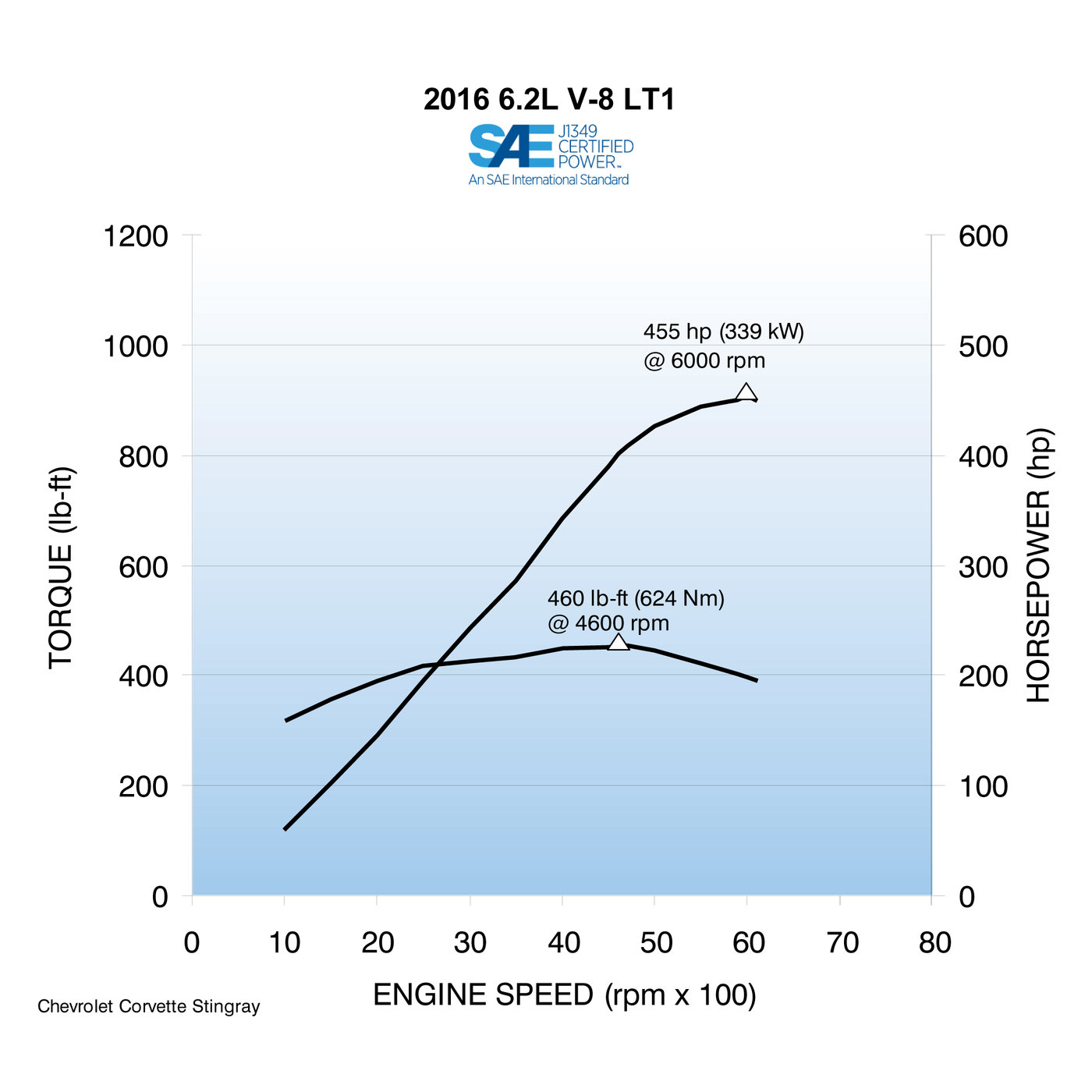

3)LT1 E-rod - 455 HP and 465 lb-ft of torque, pretty flat torque curve, deliver 400 lb-ft at 2000 RPM

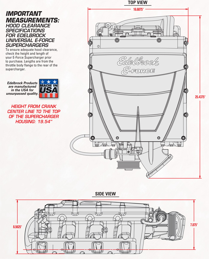

My original thinking was to go with the LS-3 and Edelbrock supercharger since that would for sure be a thrilling experience and I think the packaging into the SLC is very do-able. But now I'm thinking going with the LT1 E-Rod since it is probably a 100 pounds lighter and has a nice flat torque curve which would work very well in an SLC and save myself the install issues of getting the Edelbrock Supercharger installed(pin crank, upload the emissions legal tune, and install a separate inter-cooler radiator and pump etc.).
I also don't really don't know if the LT 1 will have any packaging issues. Both engines would come with a wet sump and I'd have to convert to the shallower Corvette Oil Pan. which is an easy mode. They also have low mounted AC Compressor and Alternator brackets available so I am thinking both LT1 and LS3 should fit pretty easily.

For a modern engine, it needs to pass ODB2 and they would need to see all the emissions equiptment. I think pulling an actual engine from an existing car would work, but I’d prefer to buy something new so I think E-Rod will do it and be classified something like a 2010 for LS3 and 2015 for an LT1. They have an Evap System and two sets of O2 Sensors and cats and are certified to pass low emissions tailpipe test if necessary. But, in reality I’m probably three years away from having to get it inspected and maybe the laws change for the better in the meantime like California SB100 rule.

Consider clearances in your engine bay, but otherwise lots of power to be made. You can always re-write/upload the tune if you require an emissions test and swap a pulley (or two) if needed!
