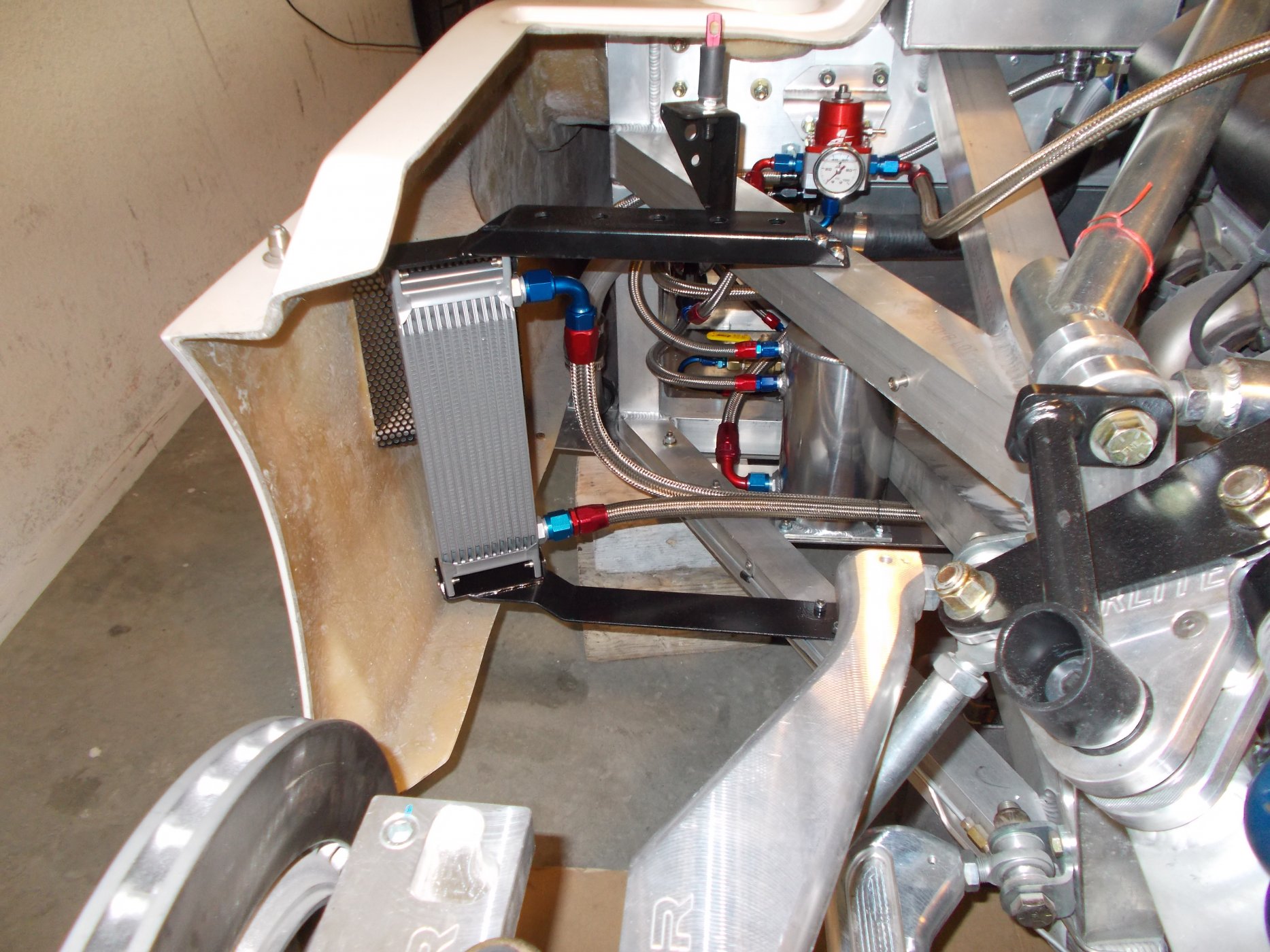

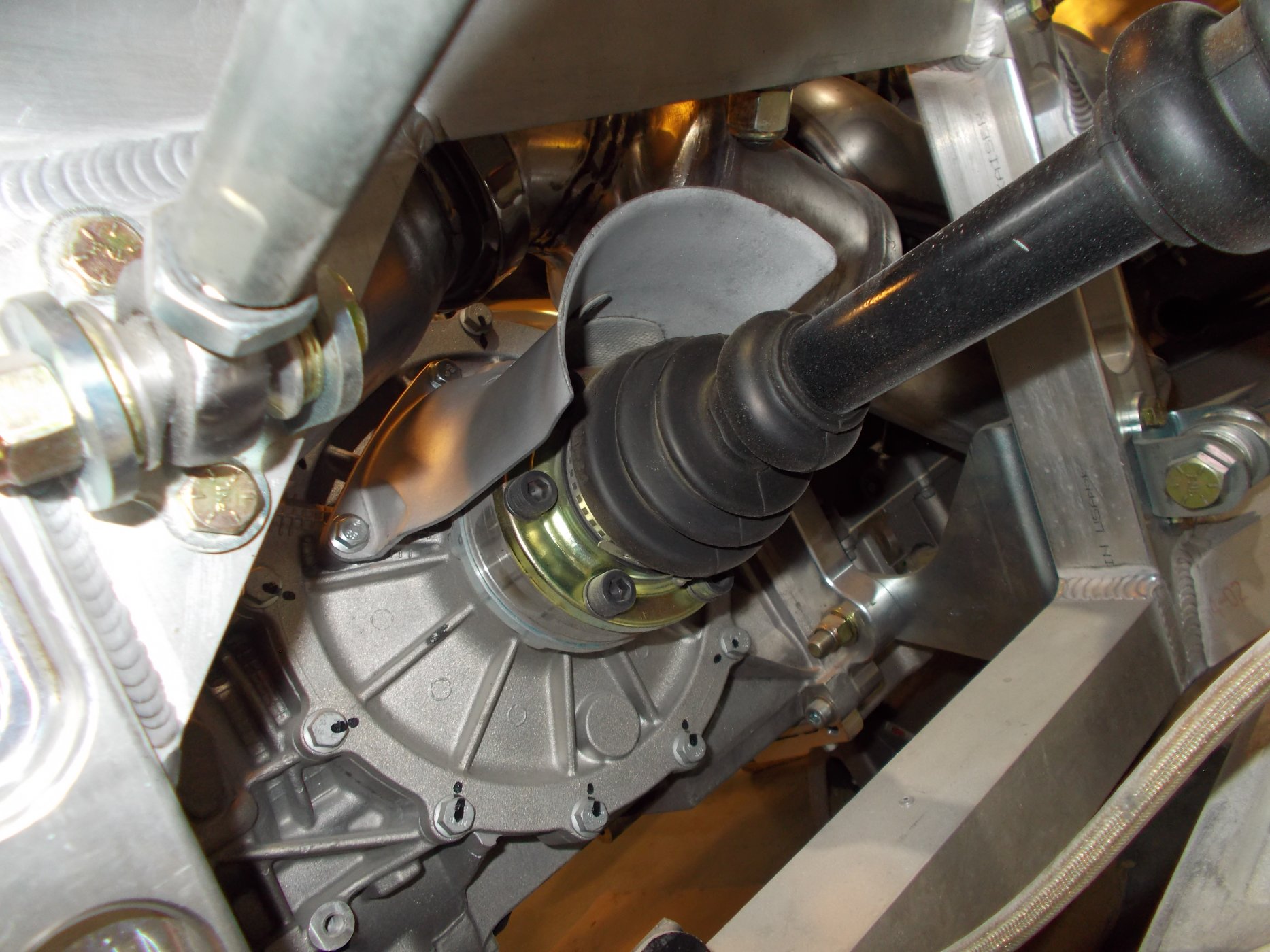

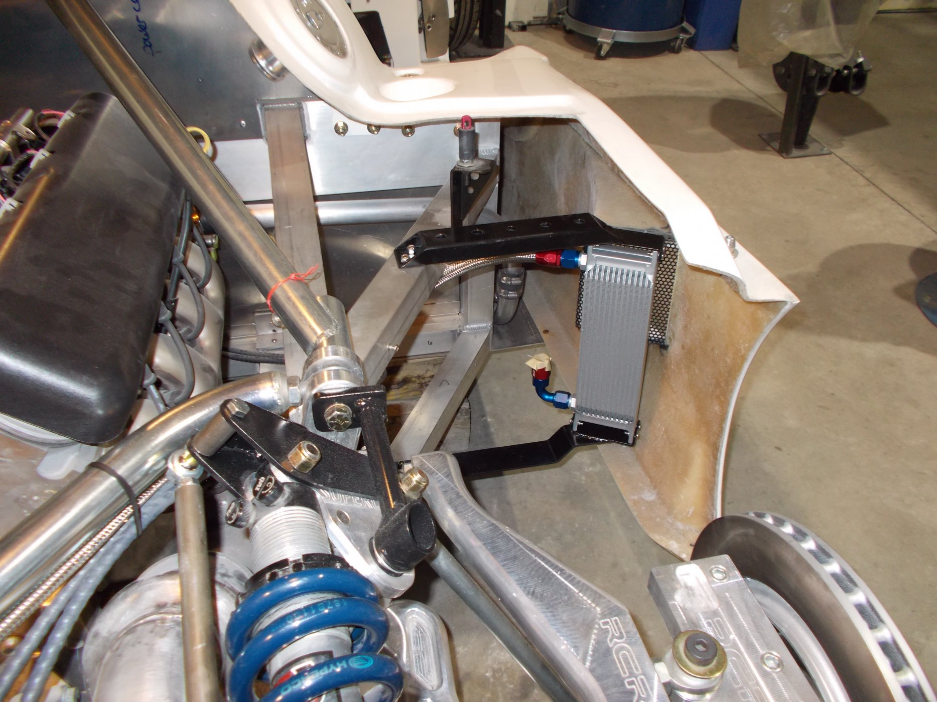

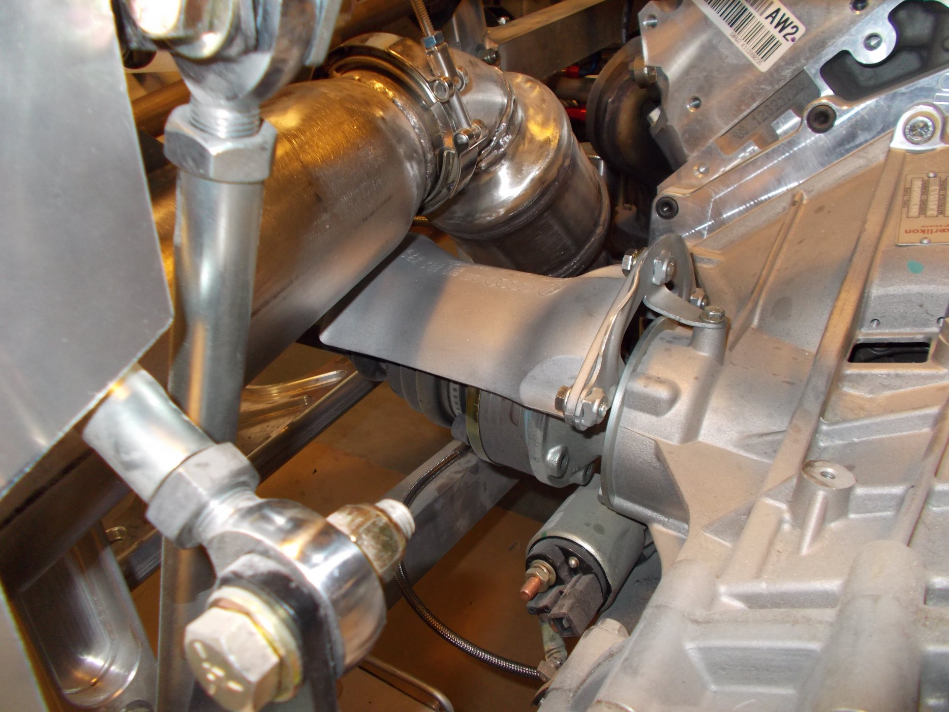

I used the same coolers as use on my 427 cobras. Thanks to a cue from Cam for 27 dollars I got shields from ebay for the grazziano, blasted them and they are like new. I am waiting on a 120 degree fitting for the transaxle cooler.slc 003.JPGslc 004.JPGslc 002.JPGslc 001.JPG
clean and simple. I see so many put massive coolers on these cars yet OE transaxle coolers are so small (or non existant).
