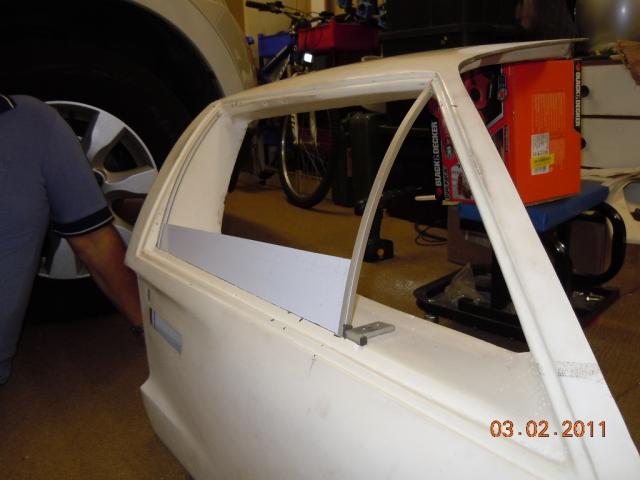

I have started on a project to install sliding down glass windows. This is as a result of changing my doors to Gullwing type - see separate thread.<?xml:namespace prefix = o ns = "urn:schemas-microsoft-com
P><P><FONT color=black><FONT face=Verdana>With all the door locks removed space in the door is now more usable. The radius of the glass is 545mm and we have done the first
</o:p>
<o:p></o:p>
After Draft 1 – we found that we can extend the glass to the front – thus removing the new up right and only leave a small triangle to the front in order to have the glass still on sufficient channel – this “triangle” will then house the side mirror.<o:p></o:p>
<o:p></o:p>
As can be seen from Draft 1 – the window opens up some 80-90% of the opening – with “glass” spare at the bottom to fix the closing mechanism. <o:p></o:p>
<o:p></o:p>
On the body, it does mean that a nicely worked of cill will be required where the original windows screwed into at the bottom and about 2/3 up from the bottom at the back. In the front we anticipate that the side window moulding will blend in to fit accordingly.<o:p></o:p>
<o:p></o:p>
Will keep you posted on “Draft 2” and my search for a small window winding “scissor” action as it seems as if this will have the least space required below the window – a channel only with sliding rails on the side. Any suggestions?<o:p></o:p>
<o:p></o:p>
Then the glass – I have had discussions with a company who will be able to do 4mm toughened glass – in he odd shape required – seems as if they can do.<o:p></o:p>
<o:p></o:p>
Regards<o:p></o:p>
Heinrich<o:p></o:p>

looks nice...but I don't see much room for the doorhandle system...
is it possible to make the biggest part fixed so you can use lightweight "plastic" glass, and the a little winddown window within it...say if you want to use that doorhandle then the Delorean way...and if its possible the Mclaren F1 way...the window in a window so you only need little space, but enough to stick your hand out etc.
ofcorse you can use a see through H profile instead of that black me thinks.
or which can look better but could intefair with the doorhandle? the Mc F1 way type
nice project.
by the way, I also can remember seeing a mk1 GT40 replica with other sort side windows, a bit in shape as yours with a seperate triangel.

Keep up the good work, Heinrich. I think the largest possible wind-down window is great for people wanting a usable road car without requiring super authenticity. What aur you using for the guide channels? Presumably you have rolled these yourself to the same radius.

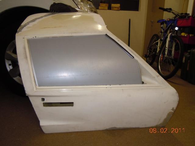

Hi Guys

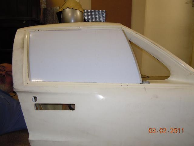

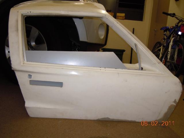

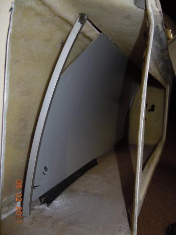

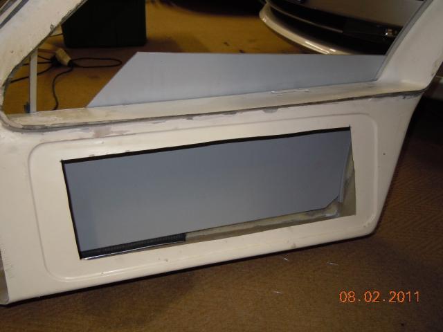

OK, so on draft 2 with a more full size window. Template rolled and working. Confirmed with glass supplier that they can curve glass to shape in 4mm toughened glass - street legal.
The side rails are rolled ali at this stage but will mill decent slides and front pillar from solid ali and also use as mount for front mirror. Found a Mrecedes winding mechanism that I will be testing and give feedback.
Looked at Mini and Crossfire mirrors, think both can work, but thinking of going the M3 BMW which has the two vertical mounts which one should be able to adapt.... but first things first, need to get the window (or ali template) working first. Then find suitable rubbers to seal etc - but many new cars Merc inclued have good rubbers and will adapt.
Herewith pic's of draft 2

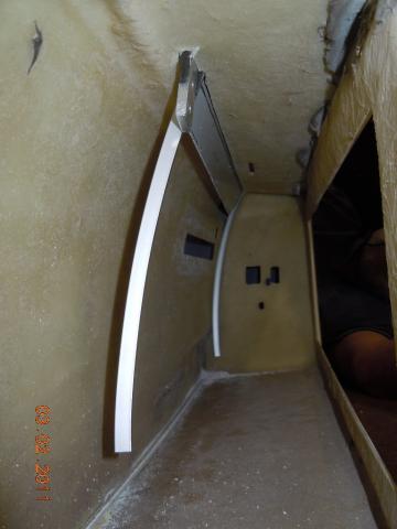

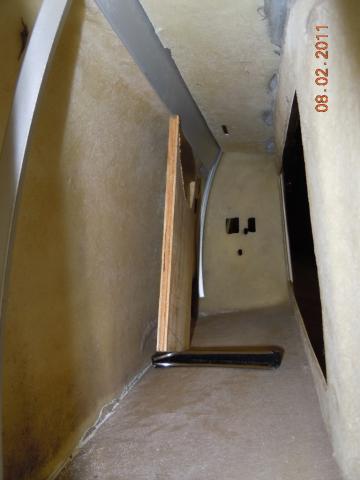

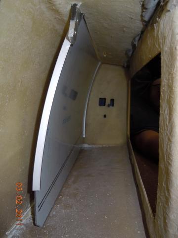

IT WORKS !:thumbsup:

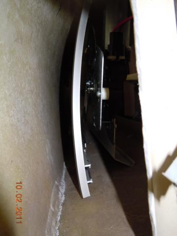

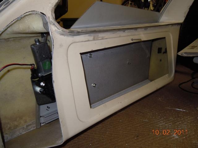

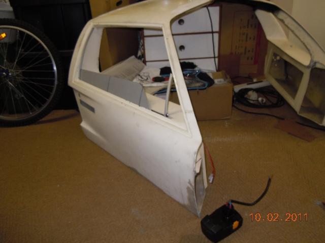

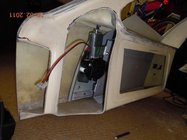

So after searching, found electric scissor mechanism from a Toyota Yaris and mounted them on a "float" mount to accomodate the curve of the "glass" - 545mm radius. The motor mount plate is bolted down on the bottom which can rock marginally to accommodate the movement. A top mount / guide pin has been done so as to limit / assist with the torque of the motor. This can be seen on the one pic.
The travel limits on the mechanism have not been set yet - physical stops on the mechanisms and easy to adjust. Will be done with final glass !
Touch of power and WE HAVE SLIDING DOWN WINDOWS ! Yes, still a lot of work but the principle works and the practical template / mock up proves it.
Now it is back to the detail planning of machining decent slides, front pillar etc. The power supply will be via contact pins - thus only two wires /contacts. The switches will be mounted somewhere.......:idea:
Space is limited bewteen the door skin and the glass but as a result of the gullwing type door, there are no door handles in the way, but i am sure it can be done on a normal door if one is prepared to go with solinoid remote locks ! (For the purists - can leave dummy door handle.:laugh:)

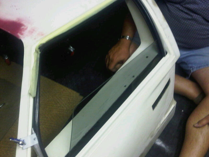

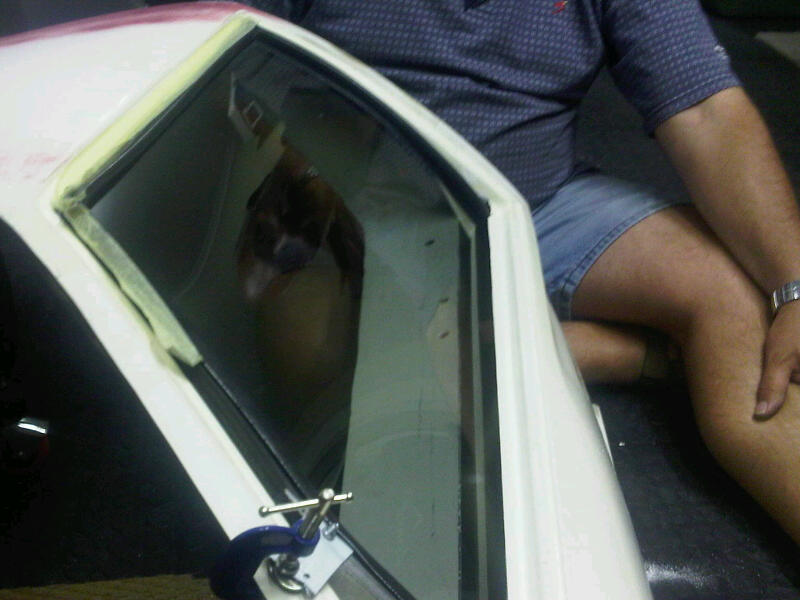

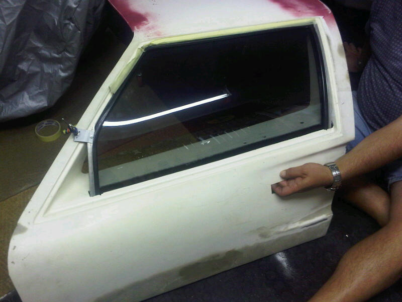

Hi Guys
Well last night we fitted the glass into the door with some temp channels and the rubbers in. The glass really looks good and the opening one gets is great.
Lot of work to follow to get channels fitted and some body contouring.
Here some pics with glass up and down...
Heinrich
