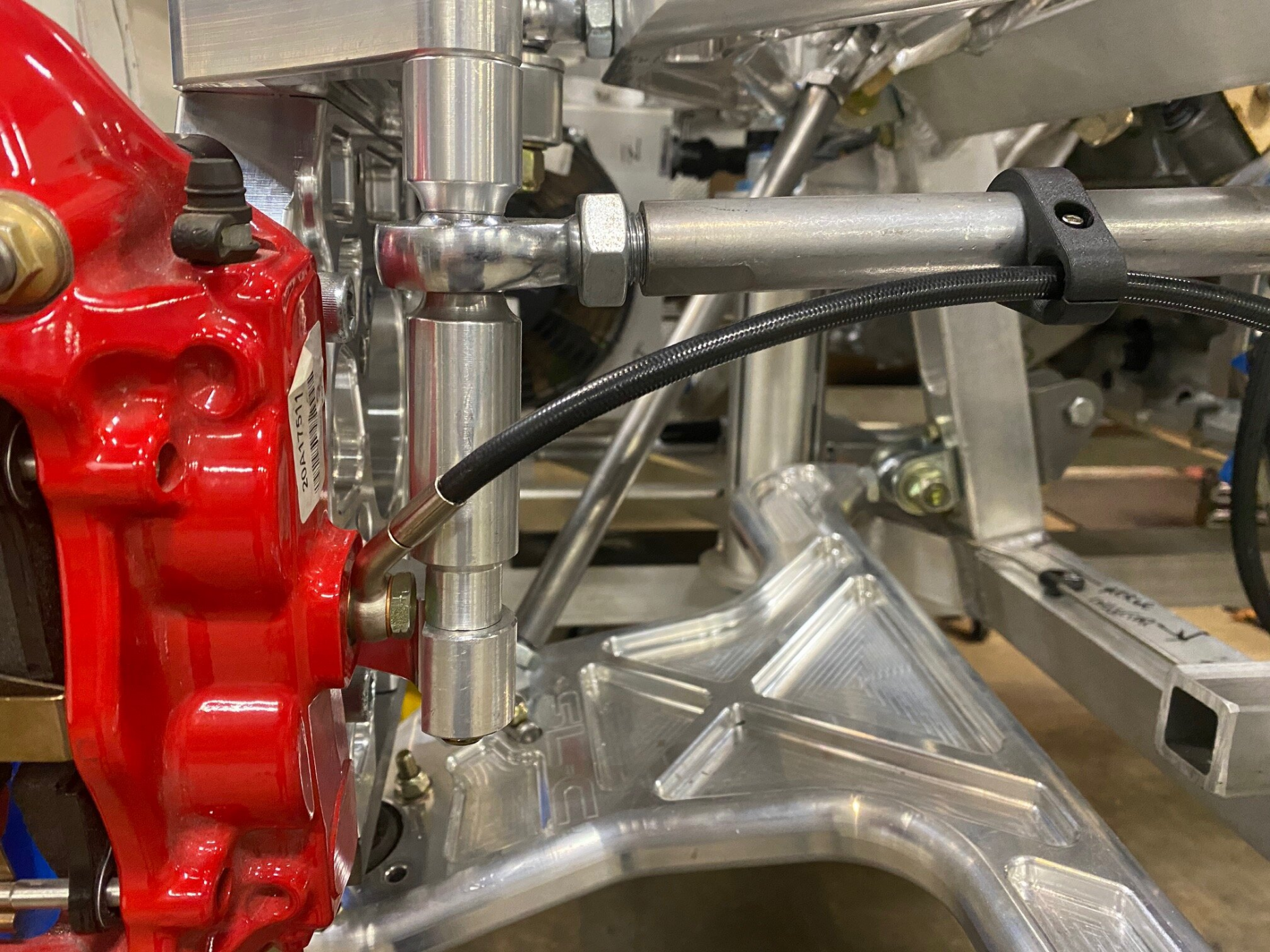

All of my flexible hydraulic lines are stainless steel encased in a rubberized coating. As you can see below the texture of the underlying stainless is noticeable. That said, there is no printing and I like it a lot better than the basic stainless line... it's really nice stuff. I cut it to length and my fabricator has crimping dies for each line size which are used in a hydraulic machine. The machine is something like $8k, but you can spec the lines and have them crimped for you. I'm pretty sure that the line is from XRP. If you're interested, I'll find out.

A marvellous build quality there if I may say so. Also your beautiful dog in your avatar appears to be thinking " :rolleyes: Pop is working in his operating theatre again"

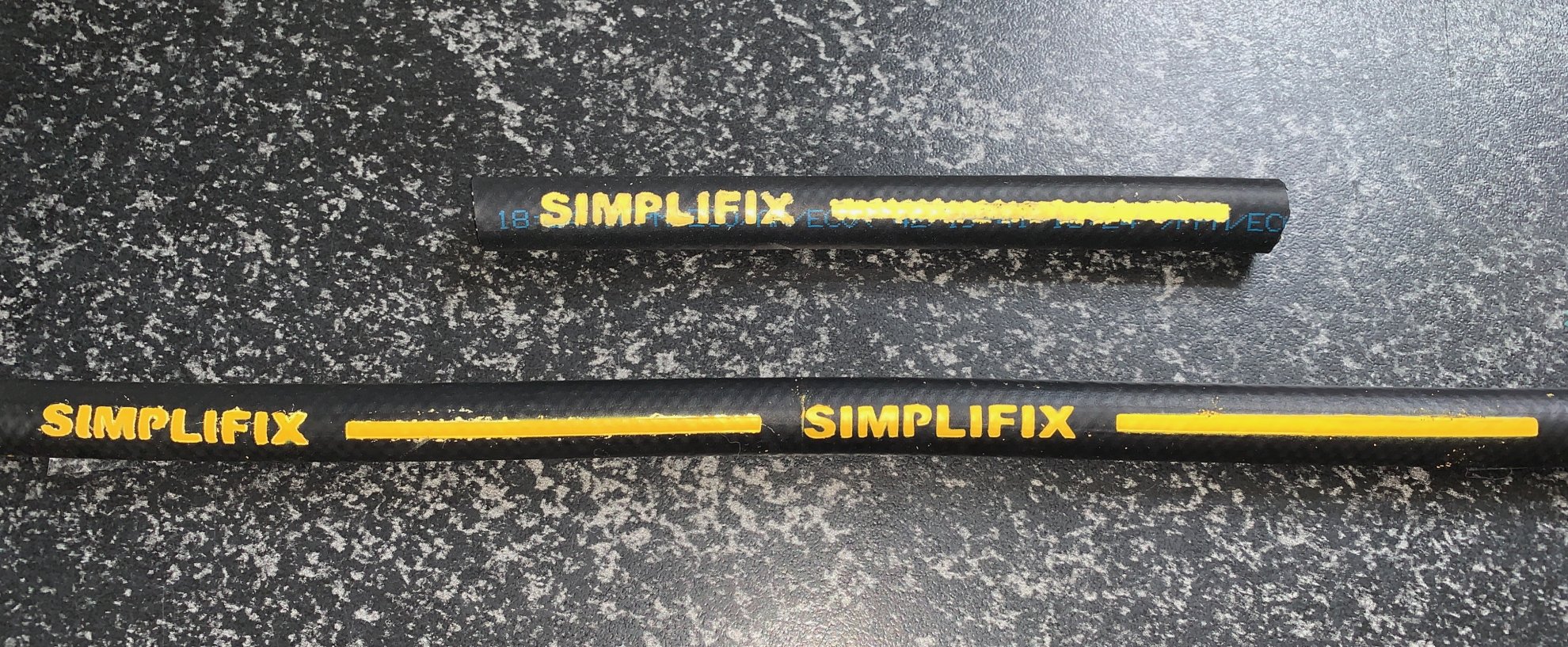

I am using Cohline 2400 supplied hose for my experiment which is delivered already printed with the R9 code specification in blue digitised print.
In the photo below you can see that the structural weave in the hose affects the lay down of my printing paint, and if I don't get the viscosity of the paint and the pressure of the applicator exact the wet paint bleeds into the low spots - the third attempt bottom right is my best shot so far.
Now I am trying to make my work easier by finding a smoother surface to print on as I need 40 feet of this yellow stuff.
