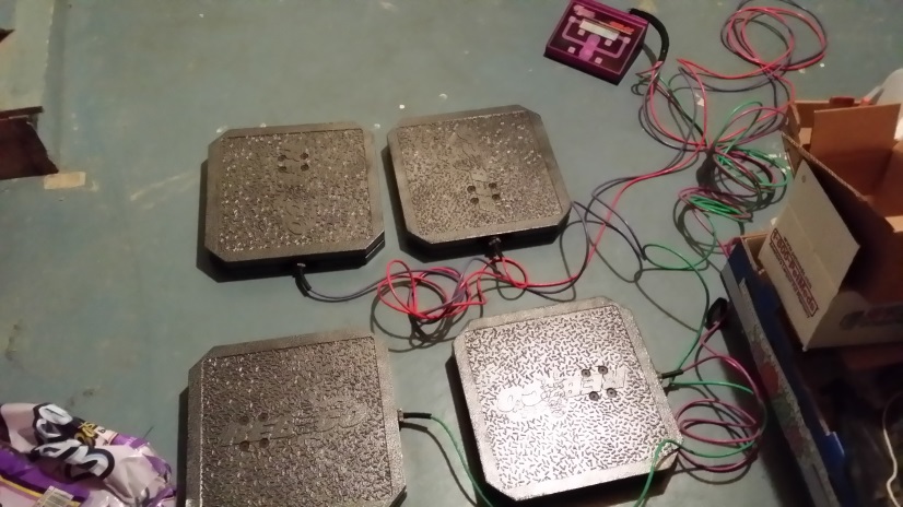

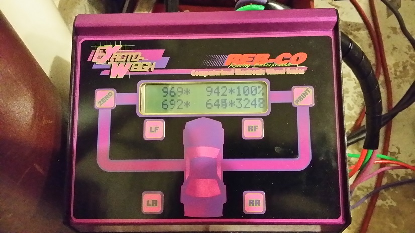

Heres the corner weights of the car as it sits right now with no driver. I do have to relocate the battery, but its clear there is an issue with the rear suspension. I believe the problem lies in the swaybar mounts. I will need to find some time to get it cornerbalanced correctly.
