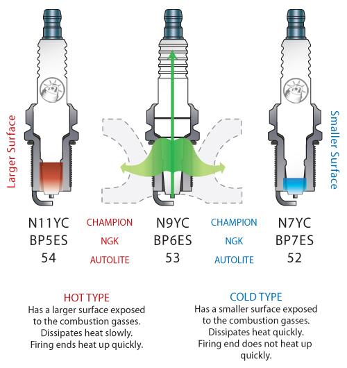

What part of the world do you live in, what fuel is at hand, what is the comp. ratio how do you want to drive the car. Just some of the factors. spend some time looking at heat ranges and apply to the factors/ questions you have answers to in order to decide.
forgot the pictures....
Edelbrock usually give plug type & heat range data in box, you can cross reference from that info to whatever brands you can purchase in UK . Be aware that some brands reverse the number sequence from hot to cold.
