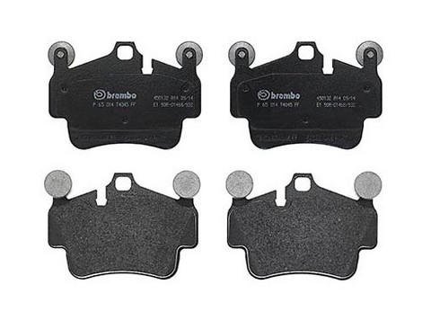

Porsche's answer to this problem is to have small weights on each pad that counteract the noise made. Its the pads that create the noise as they vibrate against your disc. I have this problem also and it is down to the pad friction material - harder pads tend to make noise/squeel/vibrate.
Paul’s photo shows the “roller skate” design. These pads originally had the roller skates added to the pads but were ground off due to clearance issues with the wheels. My reading has led me to believe this was an unsuccessful fix implemented by GM and the skates were later eliminated.
