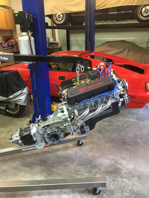

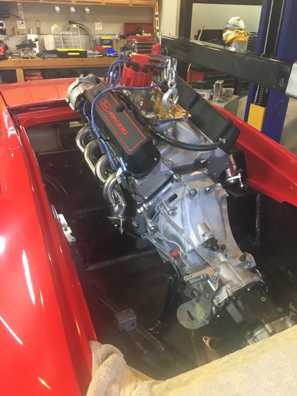

Just wondering if I should tackle welding up a custom stainless exhaust system (downstream of the 4-into-1 manifold and collector) for my bastardized Lotus Esprit project (with a SBF).
I'm a decent mig welder with mild steel - good penetration, strong welds, not the prettiest looking welds but not bad. I have a Miller 140 and it does a decent job even though it's not 220V.
Now, I've never welded stainless before, and I imagine it's more difficult. If I use some 309L wire with the right shielding gas....and a bunch of practice....I should be able to get a decent weld right? I notice the stainless Magnaflow mufflers I have are mig welded stainless (probably machine rather than human) and the welds look great.
I'm pretty good at cutting and shaping.....so if I should be able to put together a pretty good system downstream of the collectors to tie into the magnaflow x-pipe, then twin pipes out the back. What do you think? Get some practice in and see how it goes?
