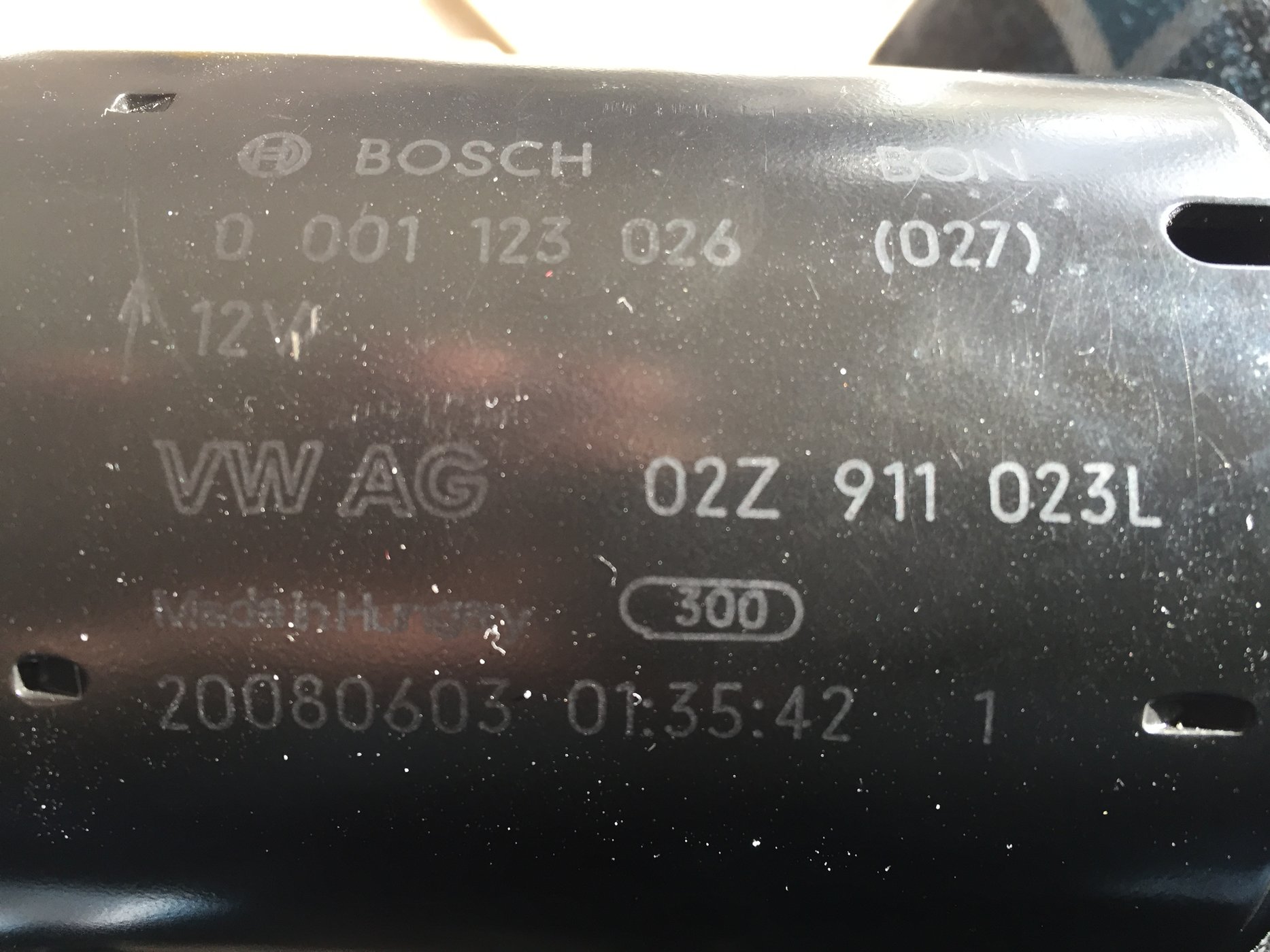

I think almost everyone is using the Jetta starter. The OEM Audi R8 starter goes by part #02Z9110231. Starters from 08 to 15 can be used.. The pigtail goes by part number #1K0973751. (Try not to buy a Chinese copy)

Here is a photo of the side of one I bought. I decided to go with the OEM starter due to the fact the one you mentioned was only for a 4 cylinder. It does sound like it turns over Cam's engine with ease though.
