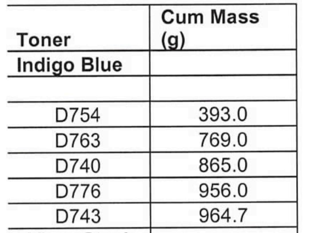

PPG Paints
Color Paint Toner Grams Per:
1 Liter 2 Liter
Indigo Blue D754 393. 786.0
(Code D763 769. 1538.0
WA9792) D740 865. 1730.0
D776 956. 1912.0
D743 964.7 1929.4
