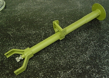

I've read the SVA requirements (rule to get a built car road legal in the UK) and it states that the steering column cannot be a single shaft assembly (from the steering rack to the steering wheel), is it ok to have a single universal joint somewhere between the rack and wheel? Or does it need to be in a specific place?

Photo of original steering column shown (from 'Original Parts' thread posted by JimmyMac)

Doc,
From my understanding it isn't just one UJ that has to be in place but actually having a steering link that is ofset by no more than 30 degrees. Also a collapsible column can also be acceptable. Looking at that it apears at first that it probably wouldn't pass muster, but I may be wrong. I have used Mick Sollis's steering column, which incorporates both features I've mentioned above, see my build thread for a bit of a pic. If not PM me and I will get some photos this weekend.

Andrew / Brett,
I did not get the gist of your first enquiry and reply as it appears to me vague and that you both presume the part in my photo comprises of the whole steering column.
This is not true as the upper column mentioned is linked to the steering rack via the lower assembly consisting of two universal joints - if you have the manual, see GT40 part number 11/6511.
A collapsible SVA compliant boss also fits between the upper column flange and the steering wheel centre.

Thanks James,
I was aware that the original column has another joint but didnt realise that 2 were used. With the boss and the 2 joints do you know if it will pass sva?

It appears that as long as the last link ie the rod between the rack and the end of the column is angled by no more than 30 degrees but is not straight so that any colission force is deviated away from straight up the column it is acceptable.
