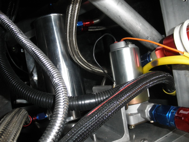

I made mine.

Ben, It is exactly the same, minus the the welding. I will open the shipping tube and post pics.
The one in the pic is mine, but I chose not to install it yet until I see if the sump will supply sufficient fuel flow.
