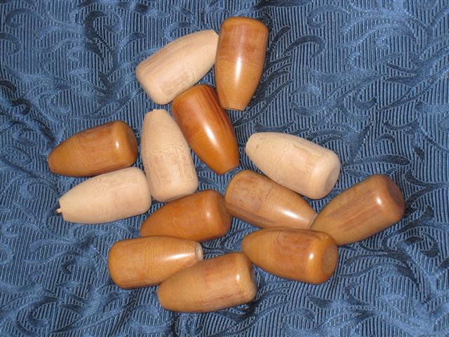

Now how about some nice rosewood "tulip" knobs to replace the black plastic ones?
#7
I would go for one of those especially if it came with one of the medallions like JimmyMac had made up. Only problem is I would need one of each color as I don’t seem to be able to make up my mind if I want red or black.
Didn't I read some somewhere where the new GT40R comes with one of these?

Rick, making wooden shifter knobs shouldn't be to hard at all.
Yes Richard, the GT40R comes with a wooden knob w/a GT40R medallion. But I think they are all RHD-right hand rod shift. So the thread size might still be an issue. Not sure if you can purchase it seperately.
