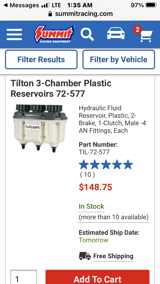

Gentlemen, is this still the preferred triple reservoir or is there something better out there ? If memory serves me correctly, the Wilwood units had a leaking problem. It’s for a RCR Lola.
Thanks in advance!!
Regards Brian
