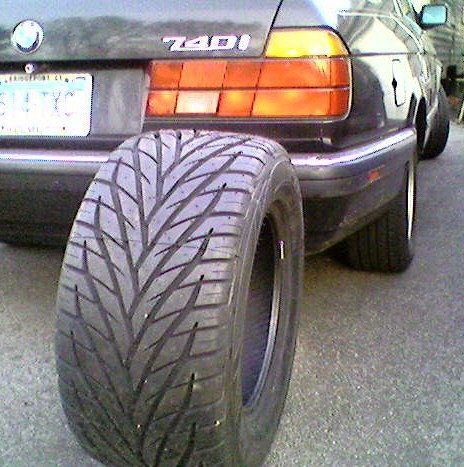

Yokohama AES 100's, 215-60-15 on the front, Toyo Proxes 295-50-15 on the rear. Tread pattern is a pretty close match. I believe 245-50-15 will work on the front as well. No guarantee they'll clear the wells, but you already have that size, so..... The Yoko's are stickier than than Toyos (minimizes understeer, easier on the G 50). If I remember correctly, Mike said he was running Hoosiers and said they didn't wear well but stuck like flypaper. Also, they were prone to picking up pebbles because of the gummy quality. These shown are strictly street, not intended for track days. If you want maximum adhesion, cough up the dough for the Avons or get Hoosiers and have them grooved.

We tried Goodyears. Not so good (on the back; we have another Goodyear on the front now, and I think Hankooks on the back which are temps until we get everything else sorted out) I think I am taking the car to a show on Saturday, I'll check what I have on there now. How are the Proxes tires for the back? the tread pattern looks a lot like the Goodyear gForce I have on the front, I think.
The Toyos are an SUV tire and thus are a bit 'trucky' in appearance. But reportedly they work quite well. You can't get a matching front tire, but Toyo does offer several other tires which are broadly similar in appearance but have a higher speed rating (the 295s are only H-rated).

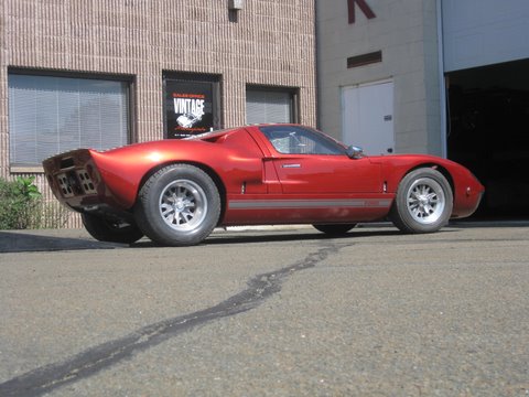

Hi, I'm a rookie and this is my first post. On my Cobra, I run Mickey Thompson Sportsman S/R radials in 26x12.00R15 and 26x10.00R15. They are about 1/4 inch shorter than the original 26.5x10x15 and 26.5x8x15 but they have the same tread width and section width. They look good, hook up well, and they are radials.......

I would love to see a picture of your cobra with those wheels. In the process of buying tires! Thanks

I tried to take a picture but the garage is too dark - you will have to wait till tomorrow. I posted some to my album.
