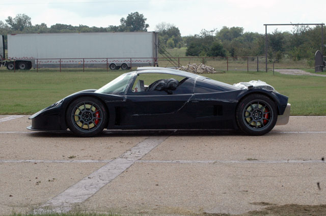

or 335/30/18; I wonder if 345/30/18 would fit. I've found some 345s, but I don't know - it looks like they might rub the control arms and poke outside the body. Hmmmmm.
Btw, if you want my opinion (doesn't everybody :laugh: ) I'd highly advise you to buy the upgraded 18s. Having owned both (the 19s and 18s) I think the 18s are a bajillion times better.
- Better fitment
- Easier to remove (with my 19s I had to remove the toe bar to get the tires off - jacking it up would cause them to roll forward slightly and wedge into the fender)
- LIGHTER. Almost 35% lighter at each corner. It's a big difference
- Better looks. At first I thought the 19s looked better, but not anymore. The 18s capture the car pefectly.

The "standard" wheel & tire sizes for the SL-C are perfect for the street. I only went for the optional CCW wheels and Cup tires "just because". Both look good on the car. Use the price difference toward the engine or gearbox!

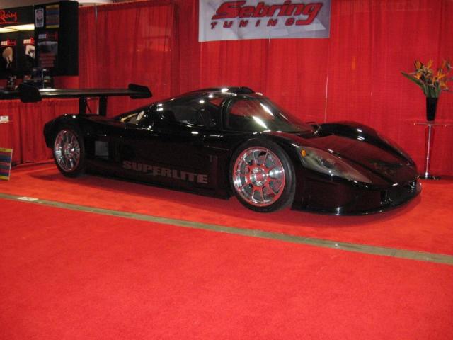

But you need some MASSIVE meats out back ..... at 325 you may as well go buy a Gallardo. 345 or bust, haha ;)
I guess I busted though :lipsrsealed:
Oh well, worked out for the better. I :heart::heart::heart::heart::heart: my CCWs now that I've had them for a while. Great rim choice for the car :thumbsup:
If I had the skill I'd find a way to fit rims like Rob has. Mmmm, massive.
I love my CCW's! They look like they were designed for the SL-C!
Standard cast wheels are well suited too. I simply had to have those massive 345's at the back!
