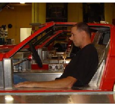

This guy needed only a Gurney bubble to fit into a stock RCR monocoque......Seven feet tall...and his legs are pretty outstretched...yikes.

I think Fran wins that one, I havent even tried to get anyone that size in a 40, come to think of it, I dont think I have met anyone 7 feet tall either. Frank

Leaving the seat out alltogether ( as appears to be the case in Frans '7 foot man photo ) would make a huge difference and allow an extra 6 inches or more I think.
