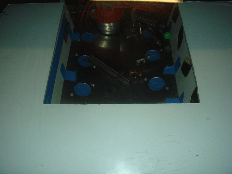

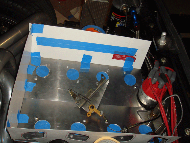

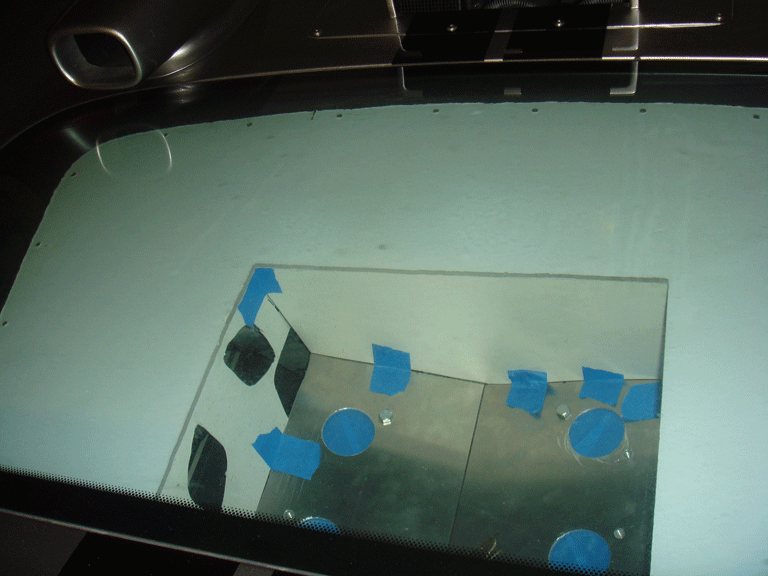

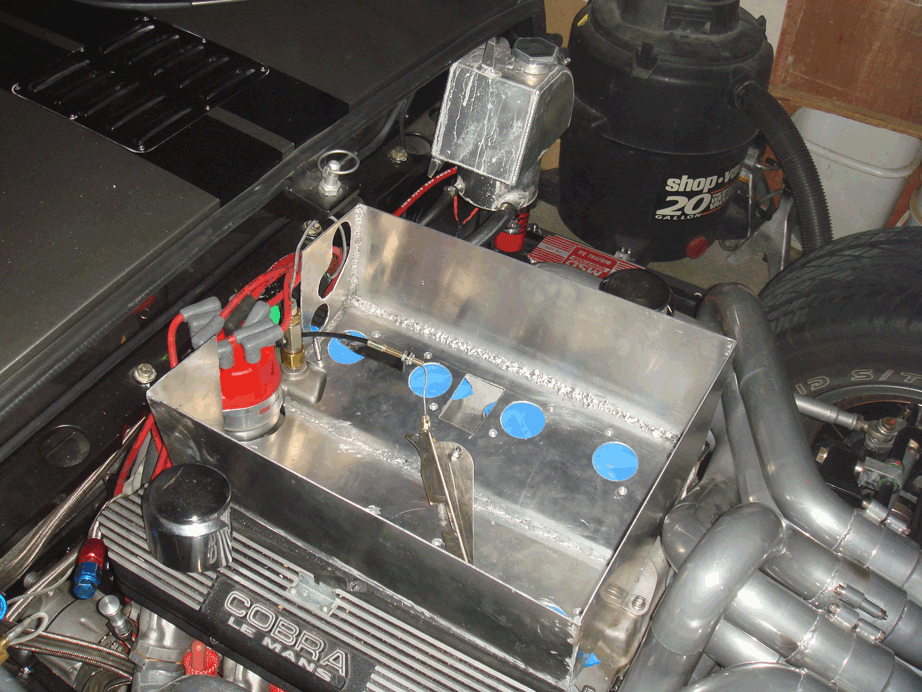

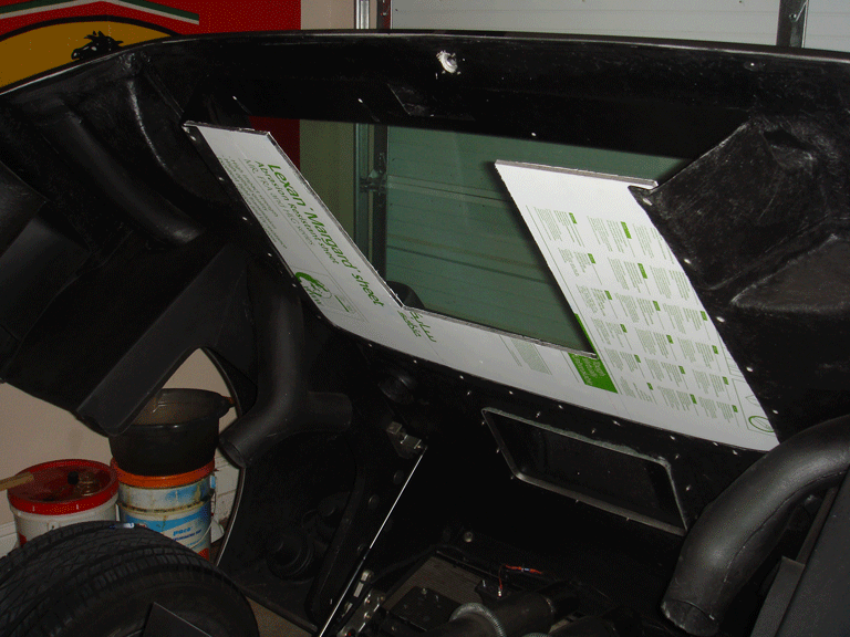

Couple shots of airbox and lexan cover in work. Major challenge is fact that I have the 10 degree cant on the IDA Webers.

From the looks of what I've seen about 16 gauge or .050.
Looking good Mark! I see you put a thick piece of polycarbonate thats the best choice, it will hold up much better to warping.
Kirby Schrader
They're mostly silver
Jack,
I don't know if you remember, but I used Lexan for the cover and it melted... Practically drooped down on top of the headers. Much as I liked it for viewing enjoyment, I ended up replacing it with a piece of aluminum.
As long as the car was moving, I didn't see a problem. When it got hot in the summer time here in Houston and I had to sit for awhile at a light in traffic, it didn't like it...
FWIW,
Kirby
Jack Houpe
Jack,
FWIW,
Kirby
Yep, I still have it in my garage, was I suppose to make another? I forgot....
Look at his Kirby, its 3/8 to 1/2 thick, it will hold up.
Kirby Schrader
Another one like that won't fit anymore since I changed to your see through air cleaners... they are offset different than the other ones I had for some reason.
I've never actually investigated what the difference is... Yours use a different filter, for sure.
I'll need to make another cover to fit. Even the aluminum one I have now doesn't fit right. And I certainly could try the thicker material....
Kirby

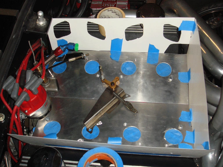

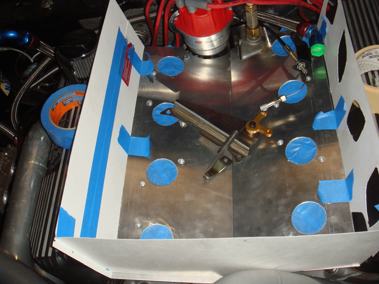

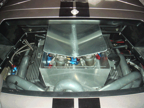

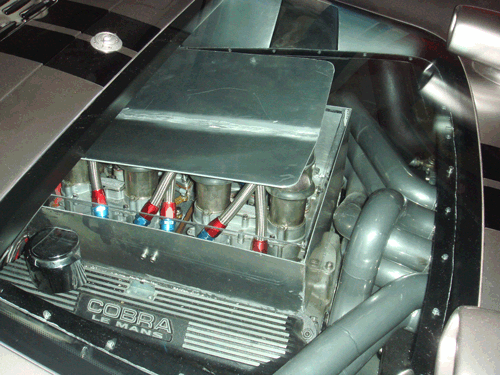

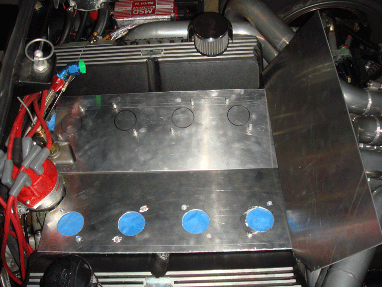

Few pics of progress (intake holes in pass side plate just template reuse).
Gathering together aluminum welding gear and argon gas. Haven't welded aluminum before so probably will need to practice a bit first.

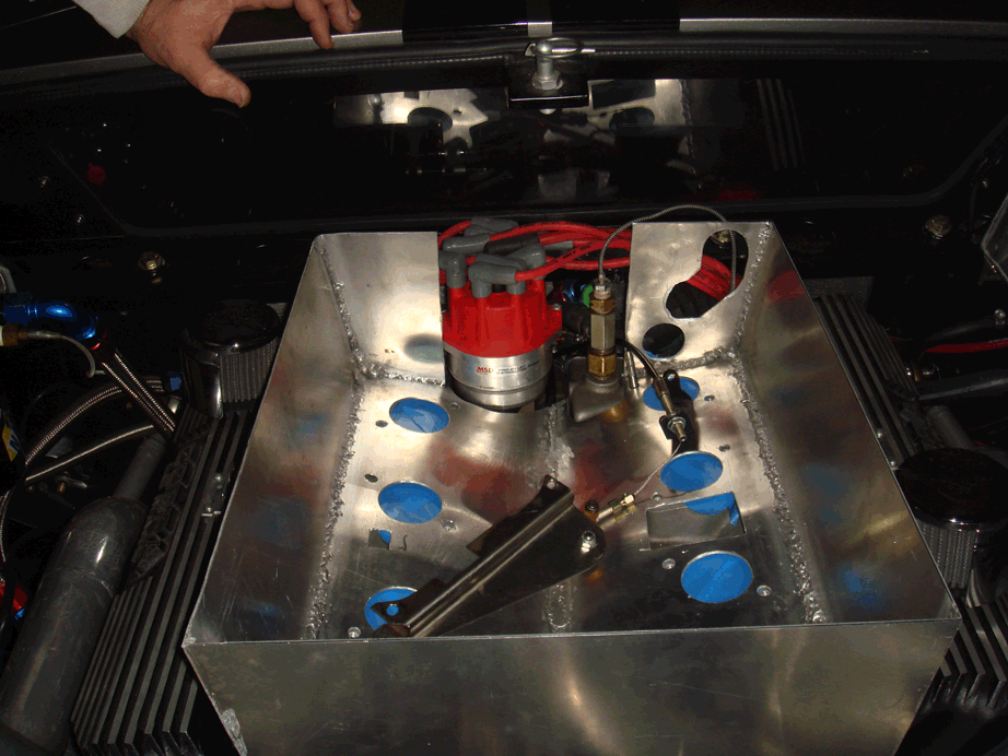

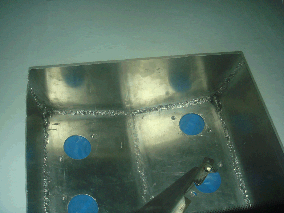

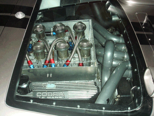

Update...box complete...will reassemble soon...welds rough need to grind...

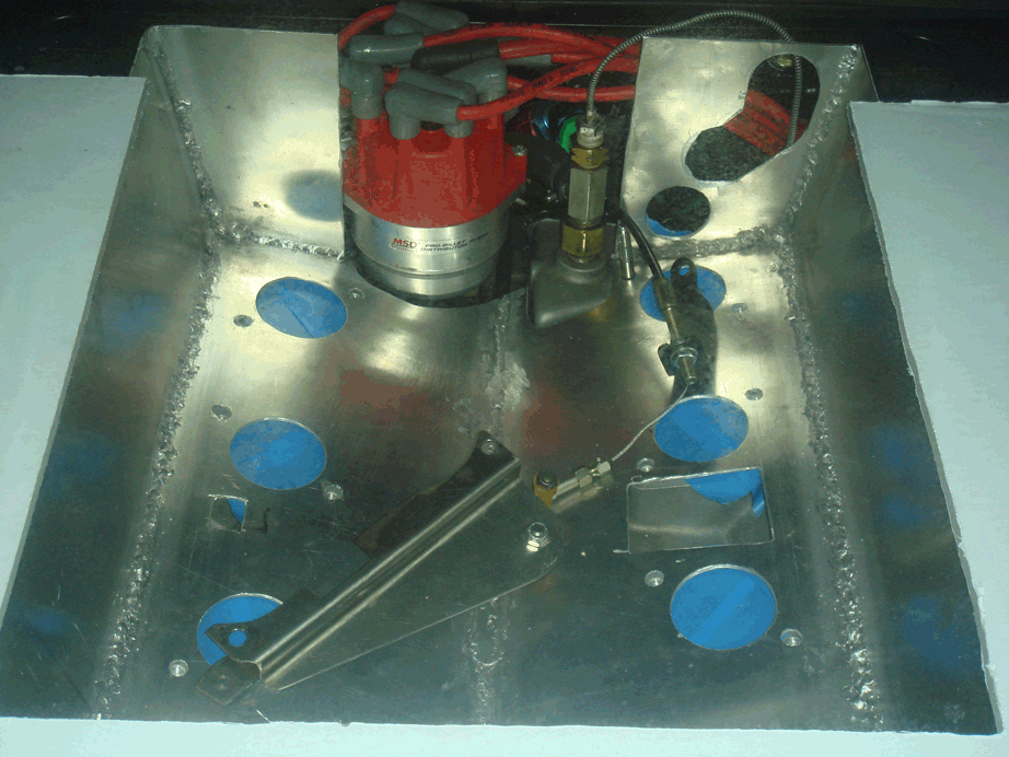

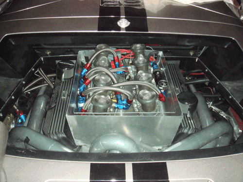

Just about done
- need to connect plate to carbs
- need to determine if it's worth it to trim lexan to match top of box or just leave it
- need to put in rest of bolts to hold in lexan
