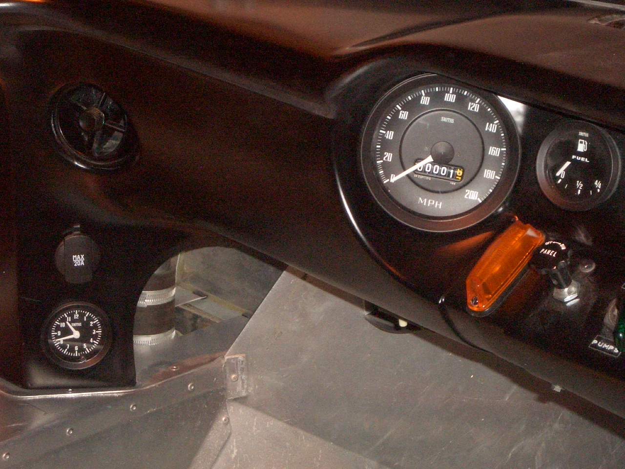

I've fitted one, together with a clock on the left hand lower portion of the dash.
I'll take a photo next time I'm up at the car.
I found that I really missed as clock when I drove the car last year.
It's quite unobtrusive, but easily seen from the drivers seat.
Geoff.
