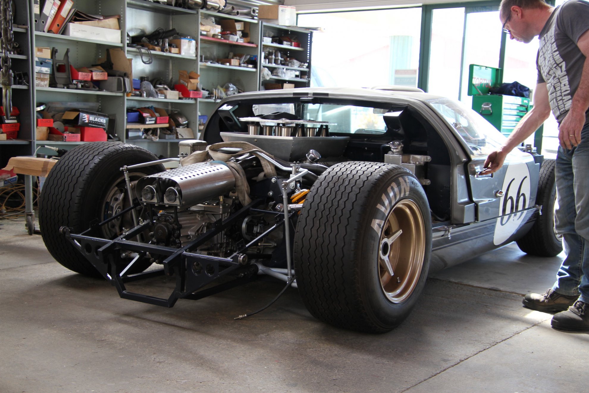

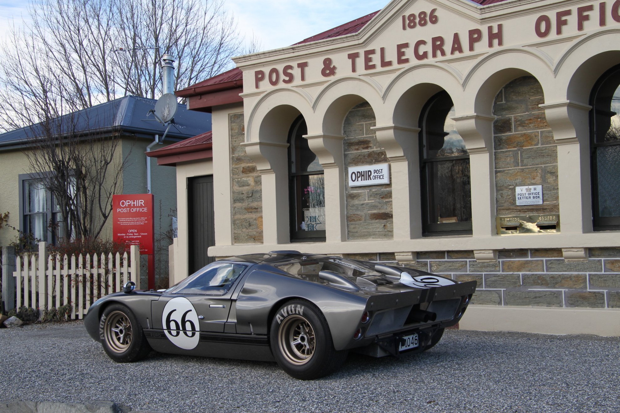

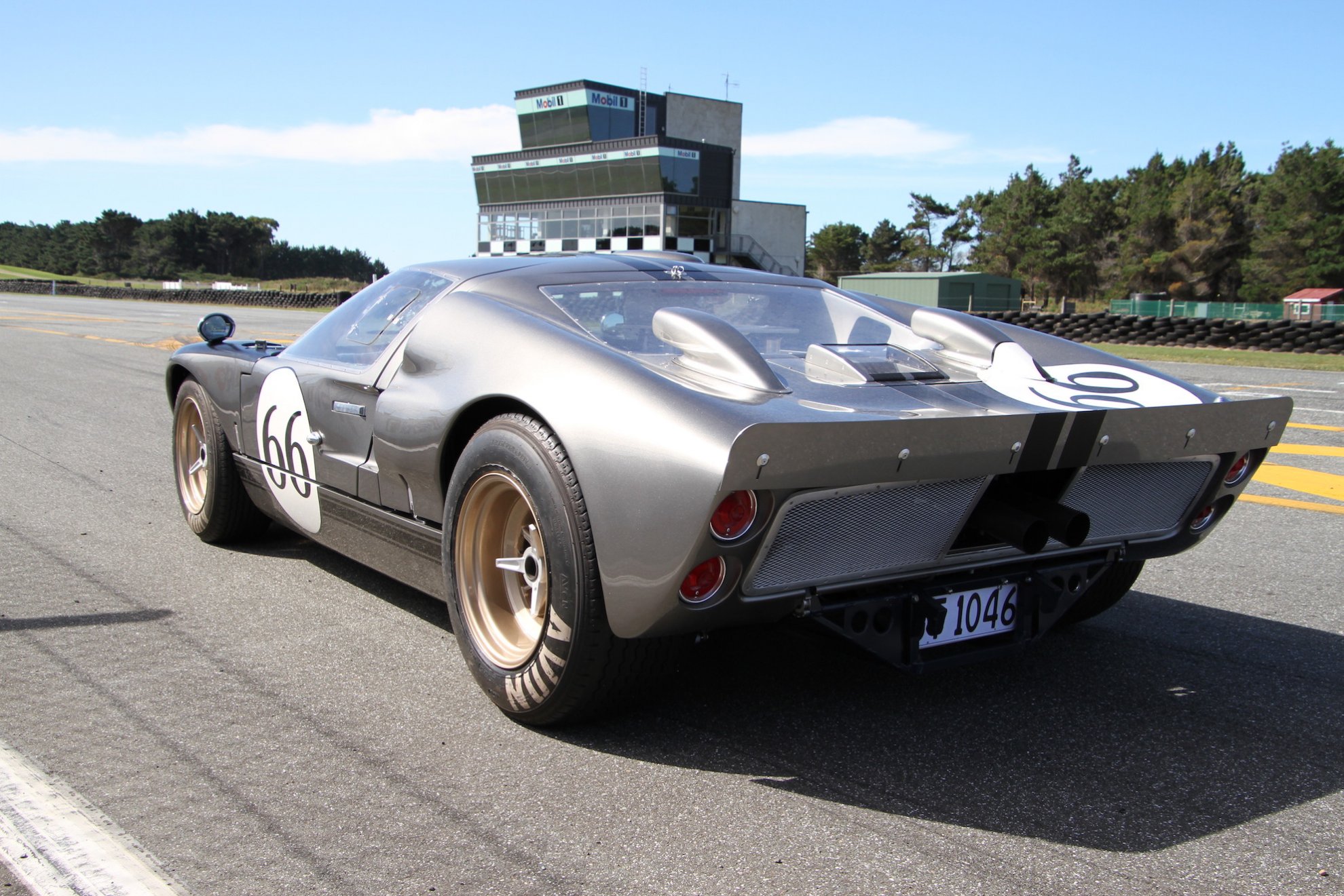

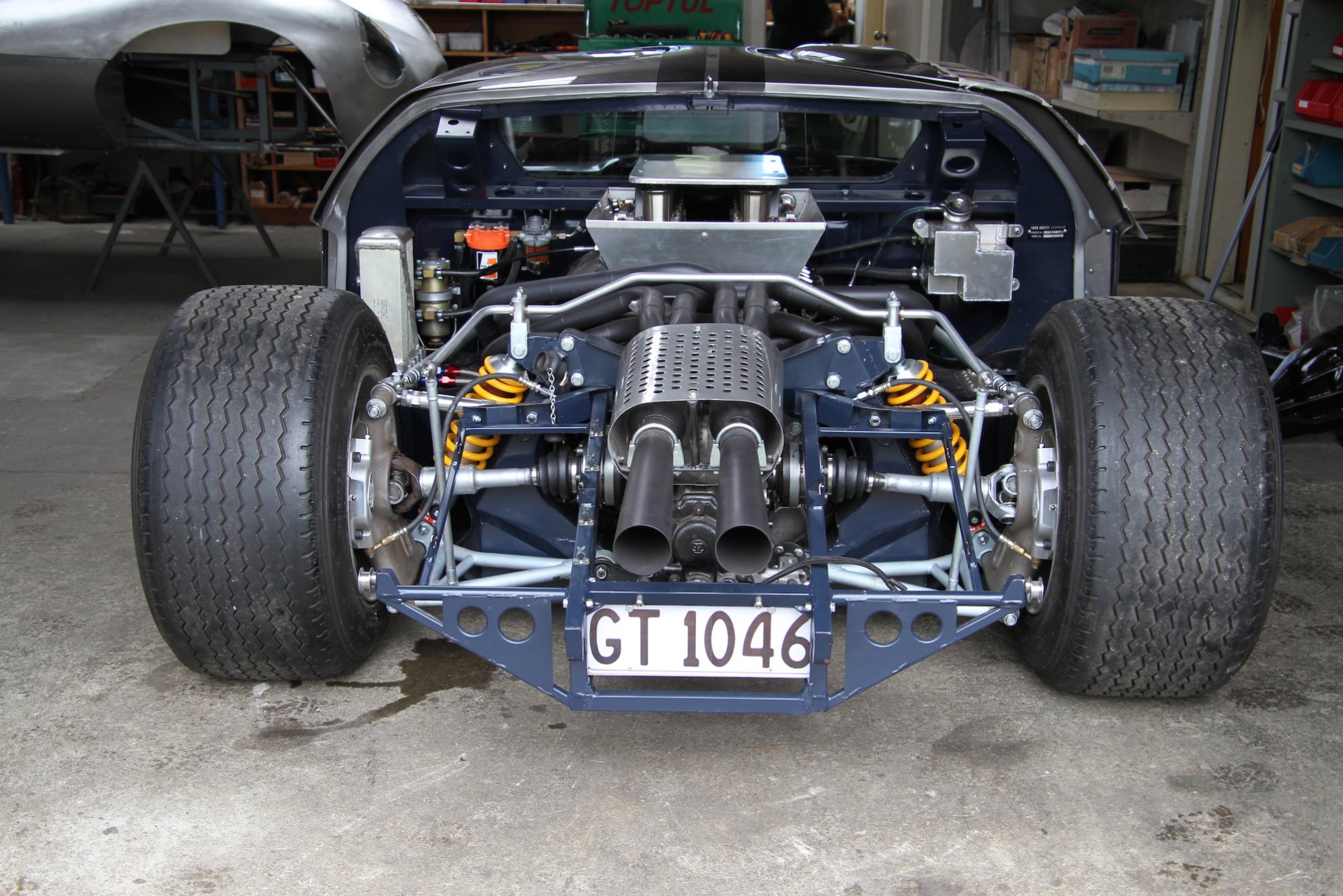

Brian Stewart
Hi, Attached are a few photos of my set-up.. These are Avon 295 on 15 x 12" rims.
Takis M.
Brian, thank you for taking the time to post these photos.
Wow, stunning car.....just makes me more impatient to start mine (knowing full well that its gonna be a long time before I can finish it).
So that's put my mind at ease. The 295 Avons on 15x12's have that classic look. I can rest a little easier now. Thank you again Brian.
By the way what finish is that on your wheels?
295 Avon’s on 12” rears for me too, take a bit if persuading to stretch on initially but not over stretched, decent tyres and look the part too imo.
