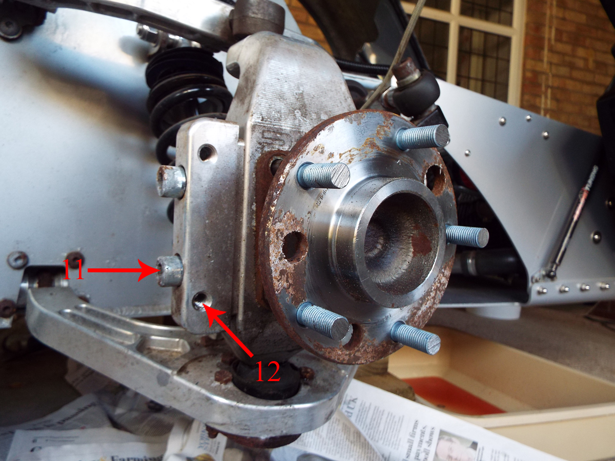

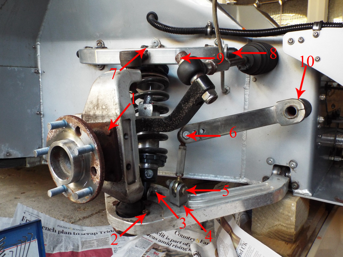

Hello ,
Please could someone tell me if all or any of these bolts should be grade 8 ?
Particularly the hub bearing mounting bolts (1) , at present these are 304 stainless passenger side & grade 8 at the driver's side, so probably swapped a hub bearing at some point and used the stainless bolts.
The others are -
Caliper mounting bolts (12) - grade 8 .
Lower ball joint bolts (2) - grade 8 .
Bottom coil mounting bolts (3) - grade 8 .
Lower anti roll bar link (5) - grade 8 .
All these are 304 stainless steel -
Lower wishbones to anti roll bar link brackets (4) .
Upper anti roll bar link (6) .
Top coil bolt (7) .
Both upper (8) - & lower wishbone mountings .
Pinch bolt ( 10 ) .
Caliper mounting brackets (11) unknown - zinc plated with YFS on head.
Track rod end (9) is grade 12.9 (metric) allen bolt.
Is there anything I should be worried about ?
regards,
Ed.
I wouldn't have any stainless bolts in the suspension unless they are some of the exotic allows and the one with yes that is only grade 2.

Thanks for the replies.
From what I can make out, 304 stainless steel are not even up to Grade 5 spec.
Most people say never use them on suspension components.
I don't want to change them all if it isn't necessary but on the other hand I don't want any wheels or bits falling off either while driving.
Someone probably thought stainless on the undercarriage won't rust - use them instead.
regards,
Ed.
Ed - go through everything and replace with grade 8+ steel bolts from a source you trust. Get the Zinc plated variety for areas that will be exposed to water or condensation (or get it everywhere you can). Stainless should only be used for attaching hardware, wiring, and other non-load bearing items. If it’s anything greater than 1/4” I would almost always assume it should be grade 8 steel or better.
Thanks,
I've been looking at the yellow zinc plated type.
The sizes in the photos range from 3/8" for the hub bearing bolts , to 5/8" for the lower wishbone mounting bolts.
So would you not risk driving it on the road at all with stainless bolts in these places ?
I have also noticed a few other places too , roll cage mountings and I think the four trailing rods for the rear suspension.
Probably plenty of others too.

Ed - I wouldn’t personally risk driving the car with those bolts in place. The yellow zinc plated type would be fine. I would recommend going to steel for roll cage and all suspension points.

If you've got stainless at a structural location (as OP does) change it out!

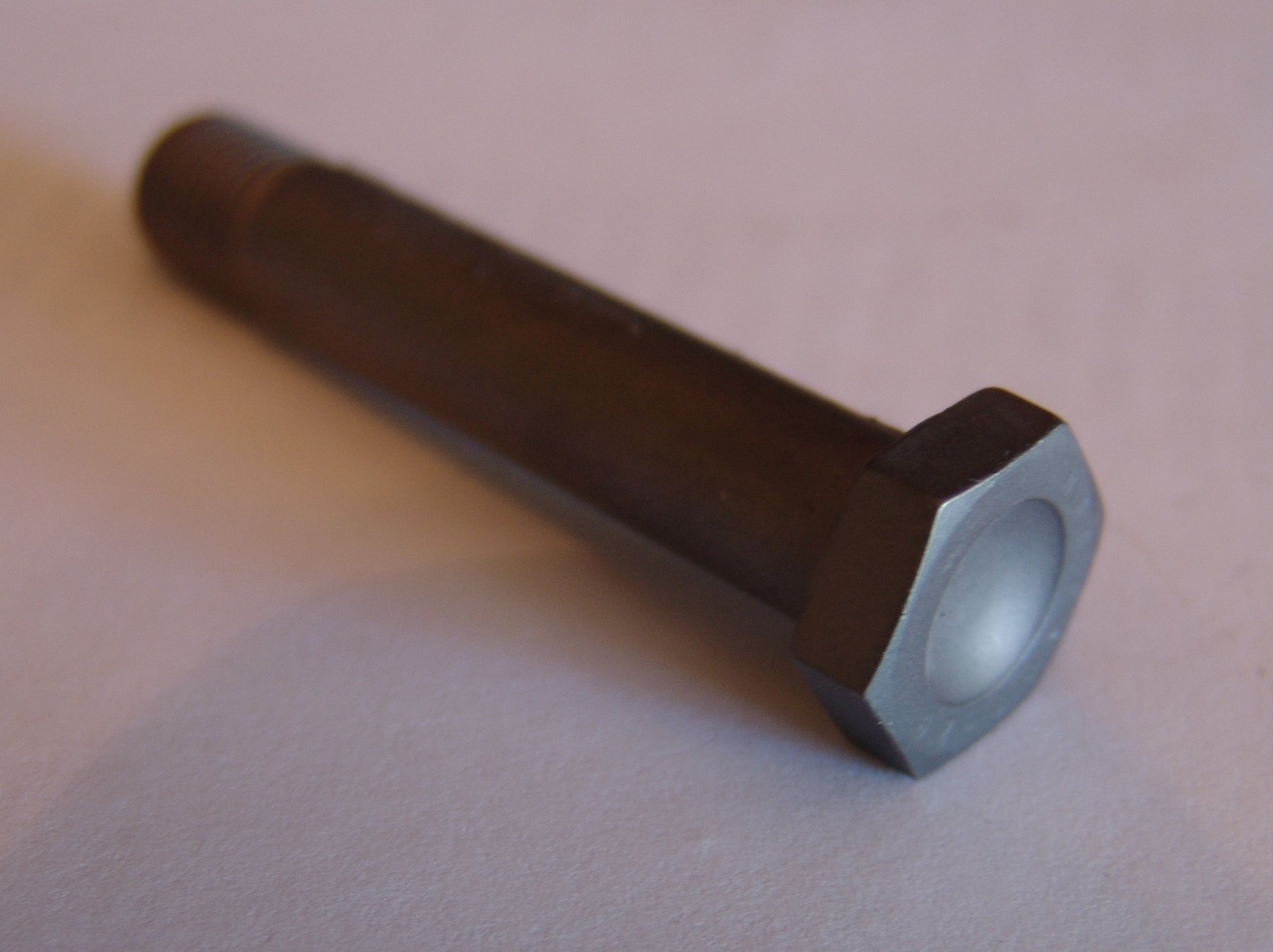

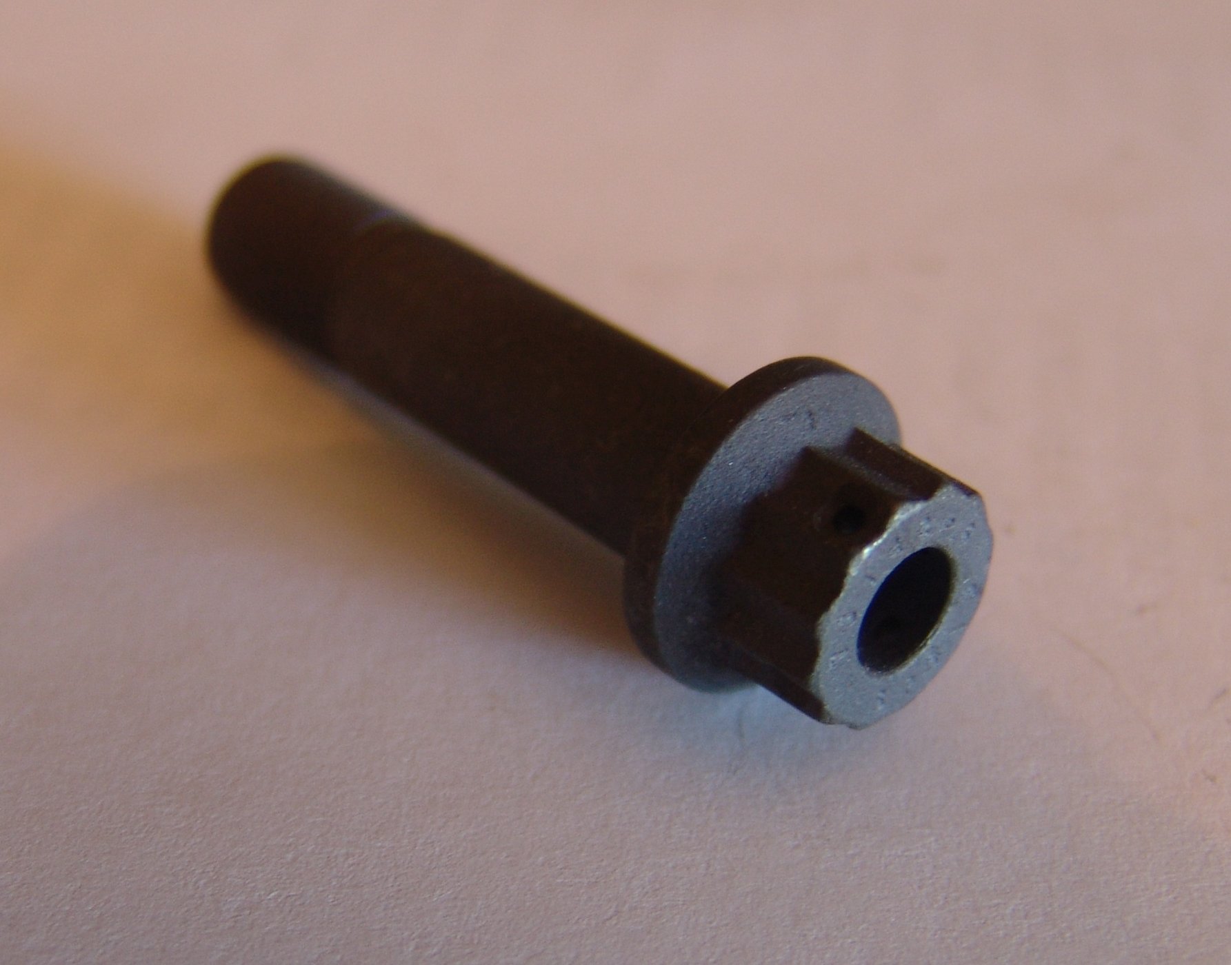

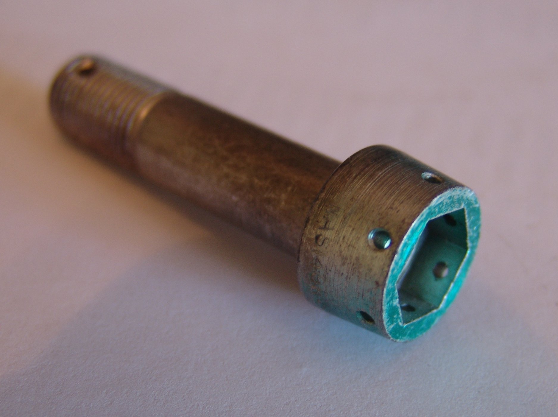

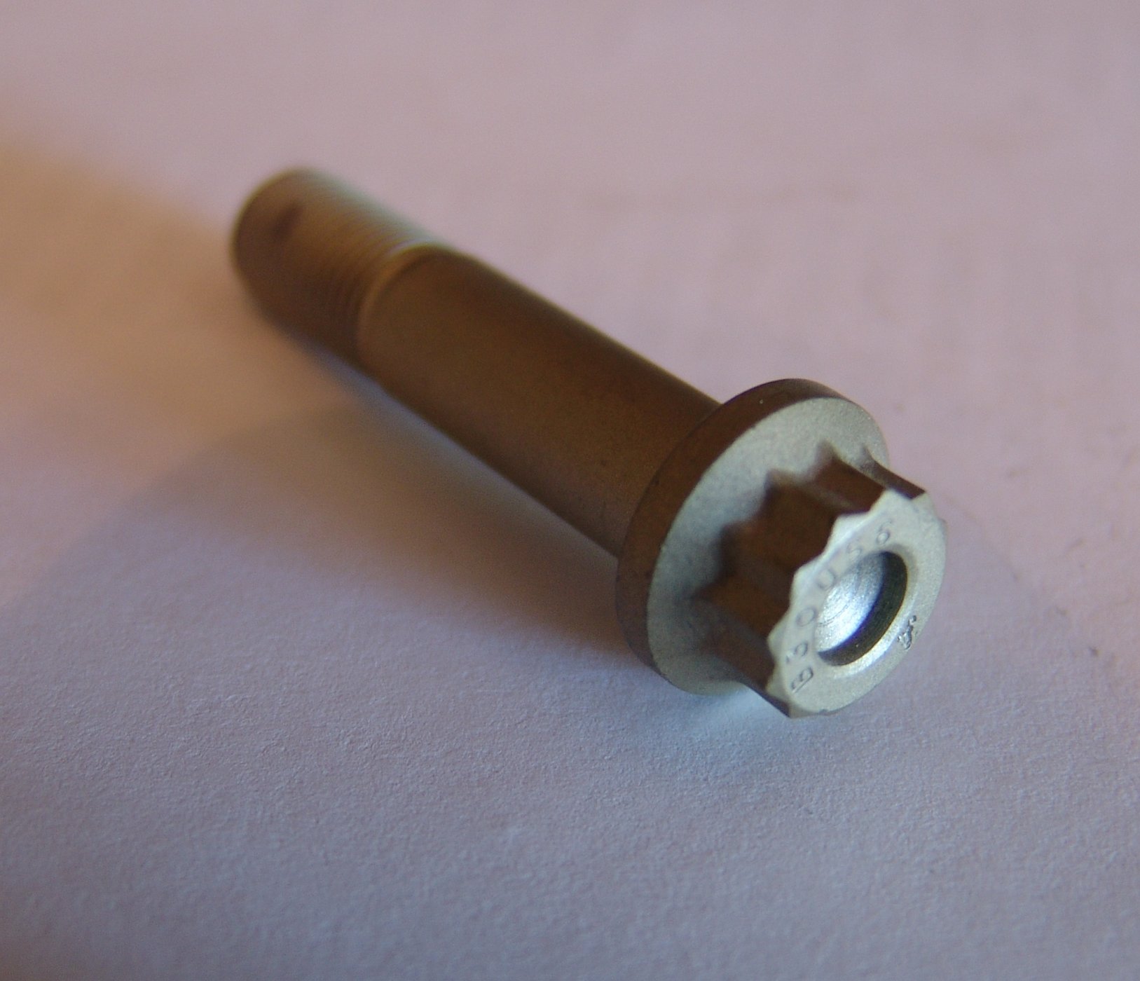

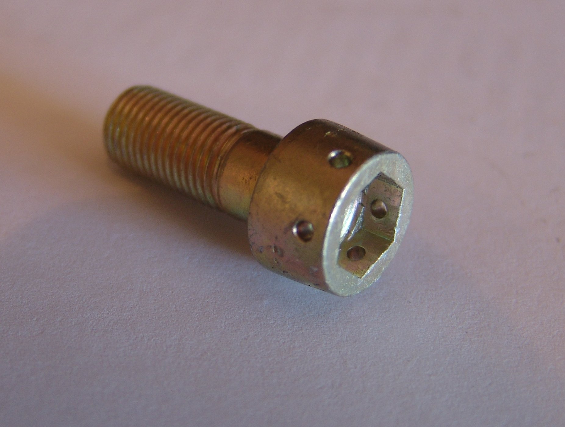

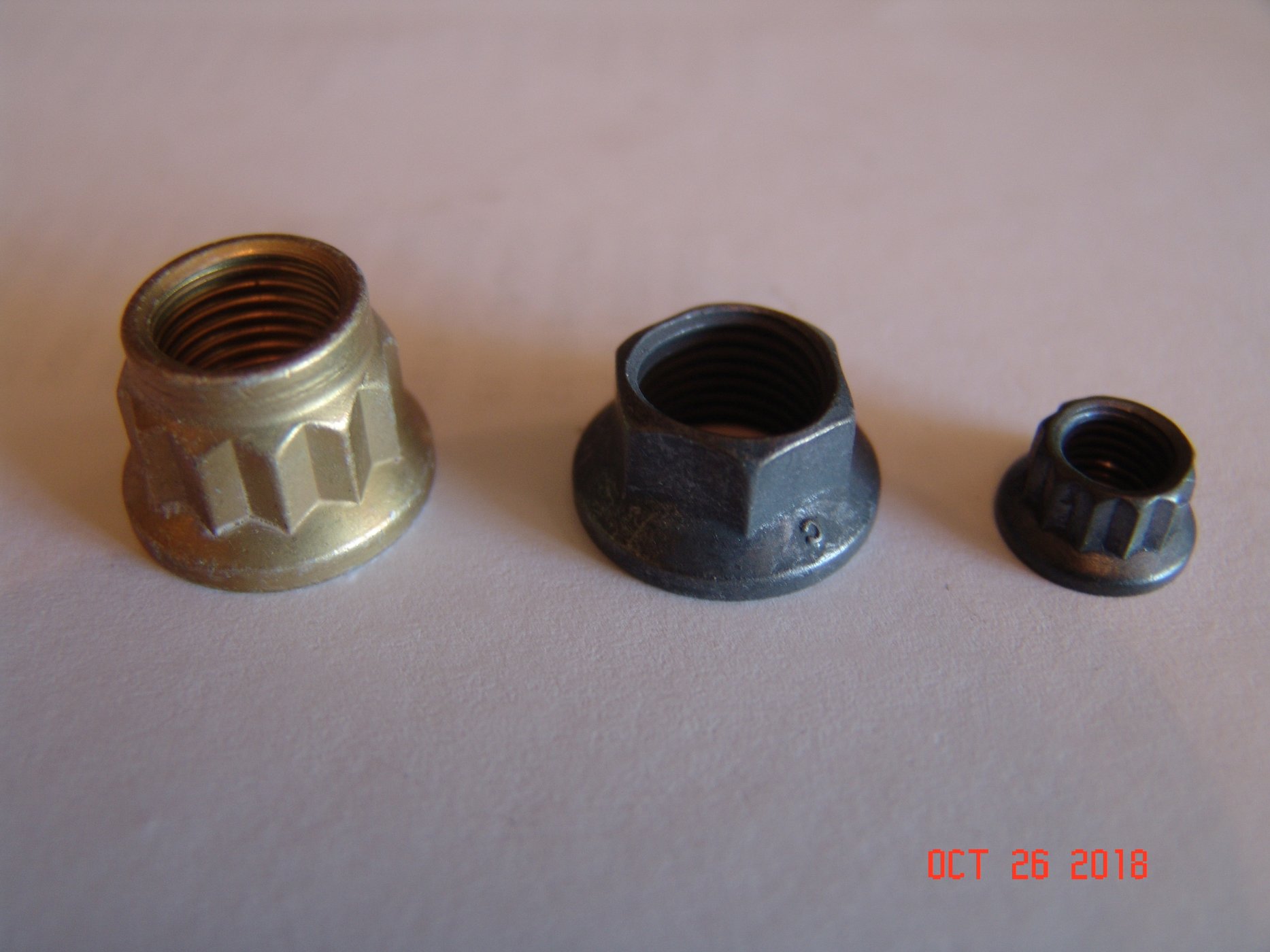

Just going back to the OP's question - ditto what's been said.....don't use stainless hardware in the suspension. Stainless is fine where it's not bearing a significant load, and can be helpful in those places particularly in a corrosive environment.
Good quality grade 8 from a reputable source is a good choice for suspension. I tend to use McMaster and Grainger for good quality hardware.
As has been said, best to get the zinc coated rather than raw as raw will rust quickly. There's different levels of zinc coating too....generally the heavier the coating the more corrosion resistance. In metric, use 12.9 for suspension over 8.8 or 10.9. Where bolts may experience some stretch due to higher torque applied to meet the tightened spec, best not to reuse those bolts. In really key areas it's not a bad idea to use wired/drilled bolts, particularly if you're taking your car on track. Suspension failure at 50mph is much different than failure at 130mph.
Regular inspection is important too. Once a month or so inspect your suspension - look for corrosion, look for wear, loose bolts, etc.
