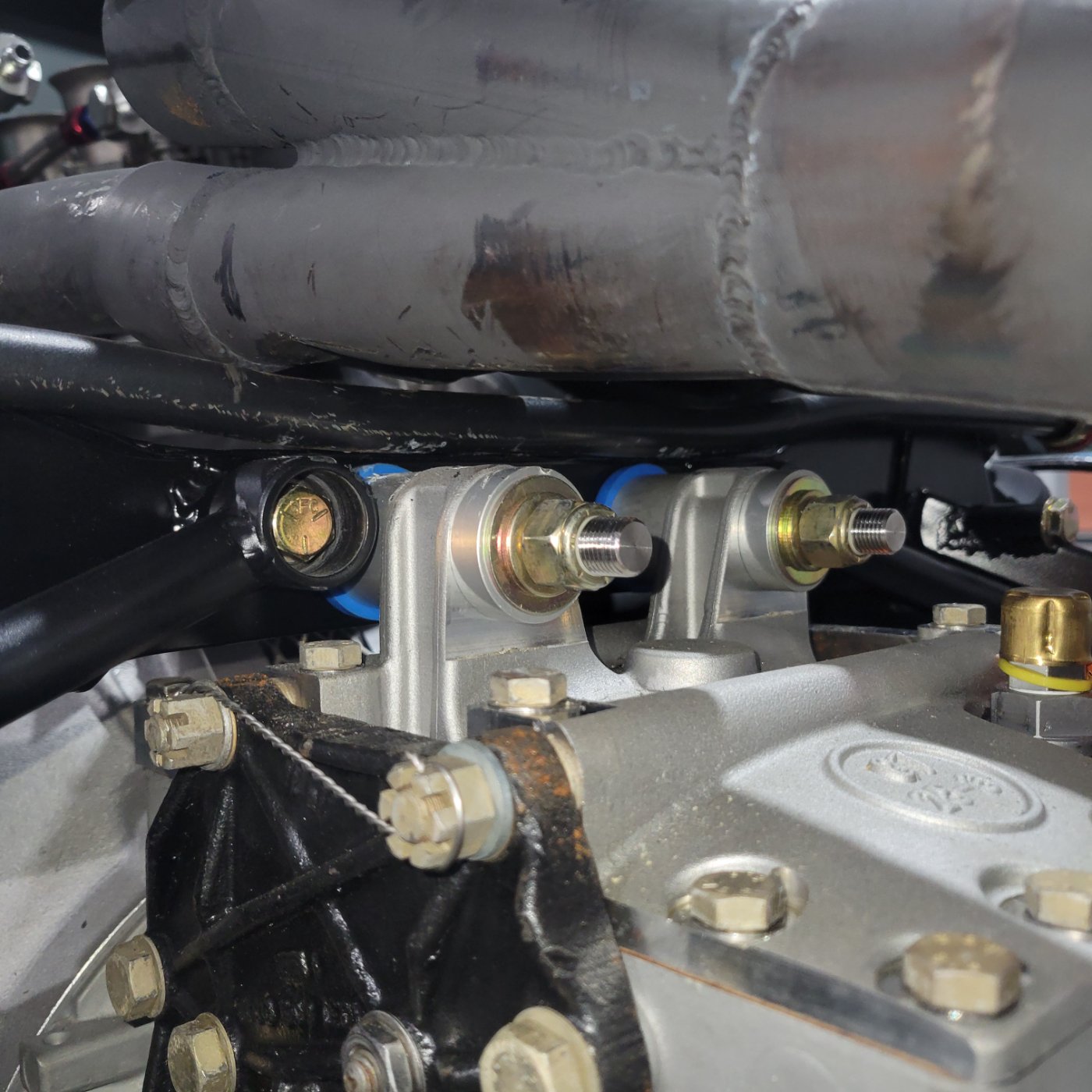

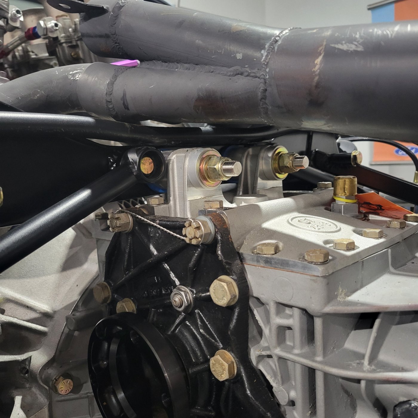

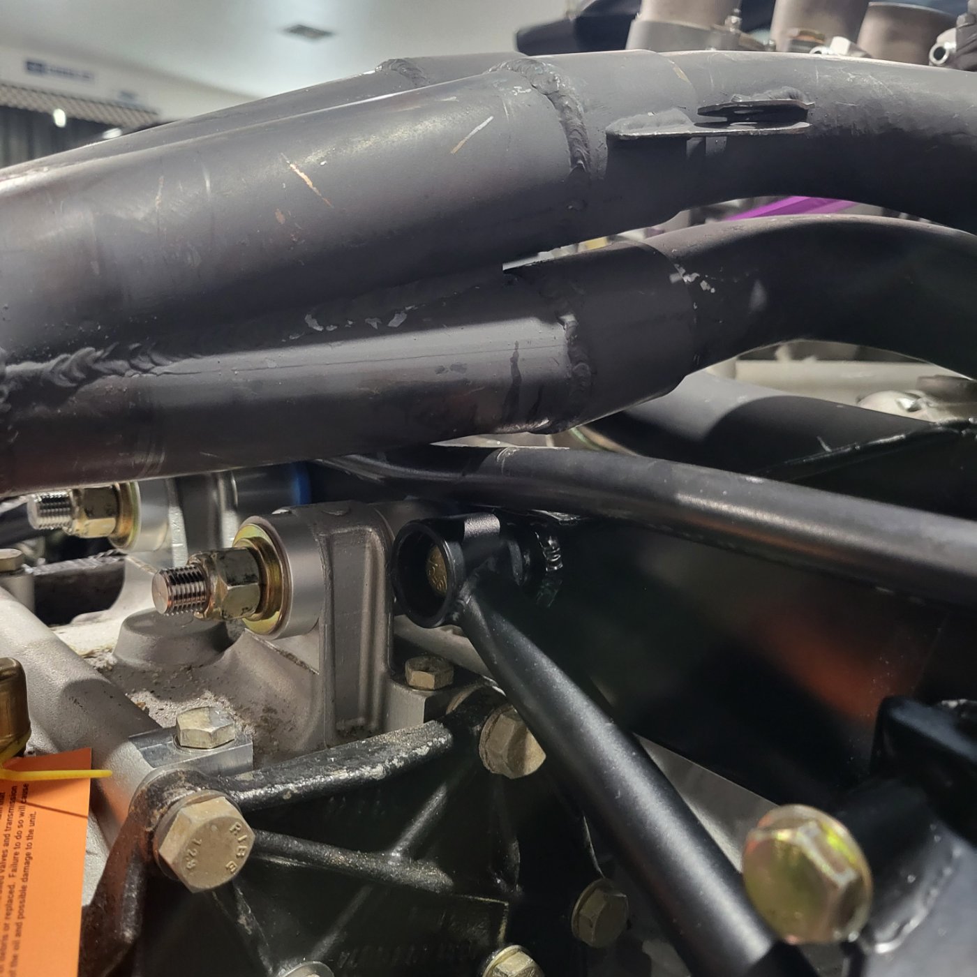

My recent exhaust test fit has me looking for the over the exhaust style rear sway bar kit . Must include all , Bar, Raised sway bar mount brackets , Bushings and links. Please reach out with what you have. Also would entertain a drop style mount bracket to use my under the exhaust bar I have. I have searched Safir site as well as Jay Cushman with no luck. Thanks for any help.

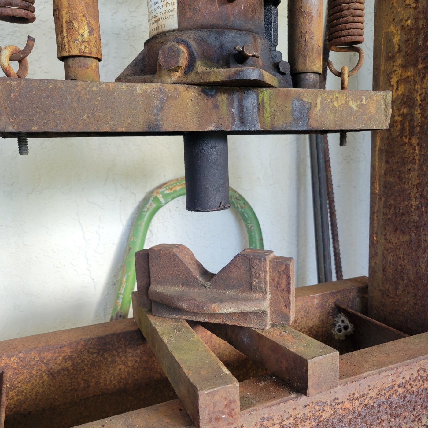

Simple slight bend with press and it fits underneath the collectors and above Trans mounts perfectly.
