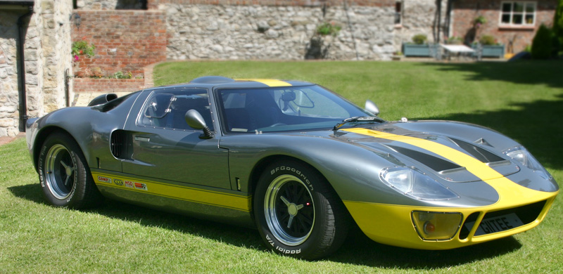

I have a holly on at the moment and am going for the looks and sound more than the HP so it is still a tough decision.
"Good luck and post pics of the "beast.""
Cheers Guys and Keep up the Chat :)
Alex
