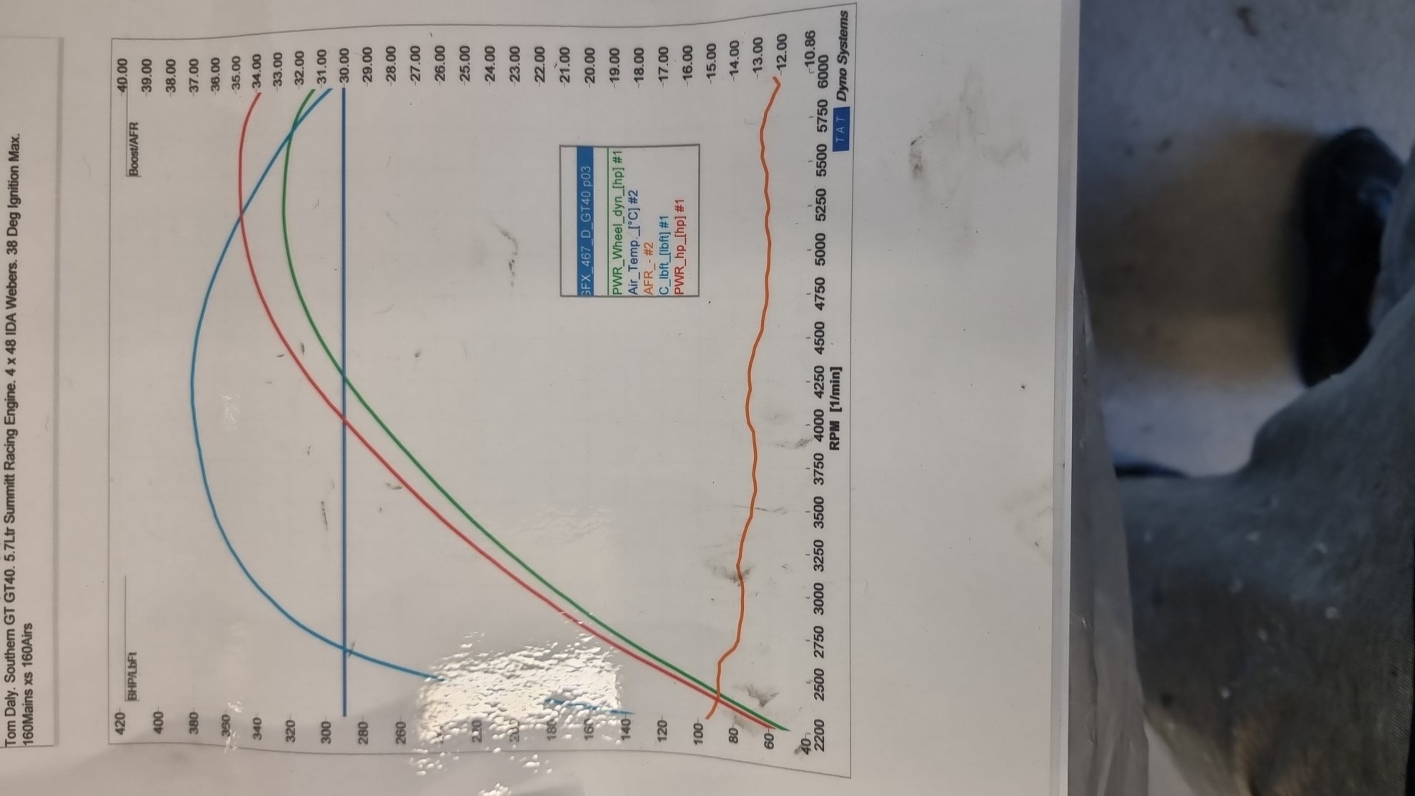

Its like a hesitation/missfire with popping/chuffing from the carbs. If I try to feather the throttle through its seems to go on for quite a while then it will suddenly clear and is great.
It definitely clears quicker if you plant the throttle.

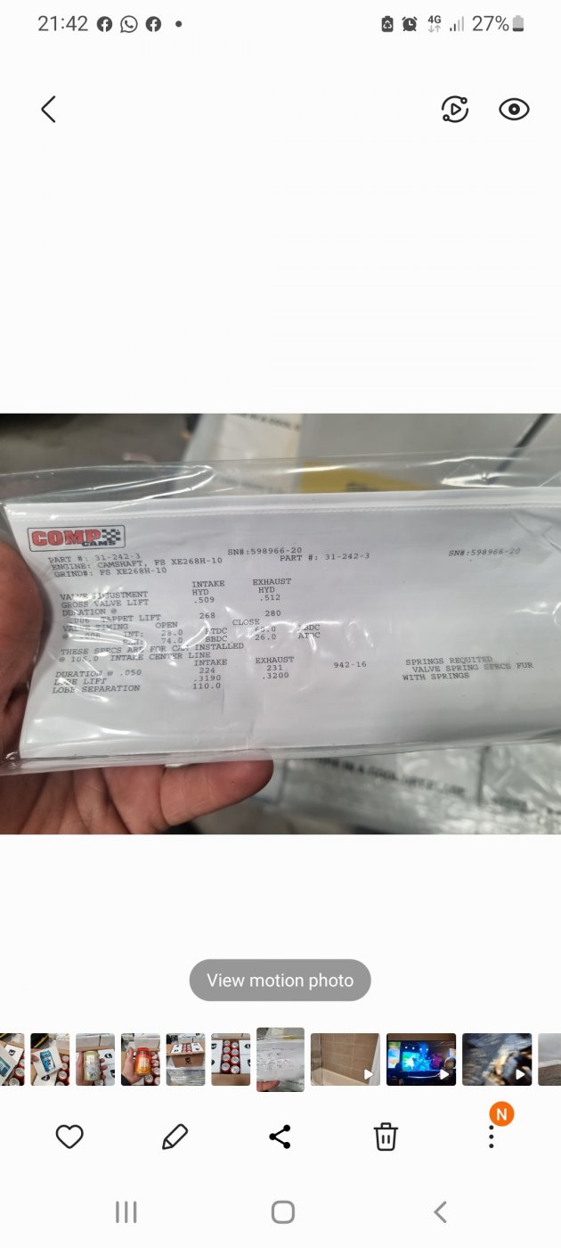

I have attached the power run graph and cam spec if that helps.
I have also ordered the 34mm chokes. This will hopefully be a temporary fix for le mans classic is a more comfortable drive.
I'm running quite a mild cam so down the line I will replace for one with more lift and then look into the third progression hole.
