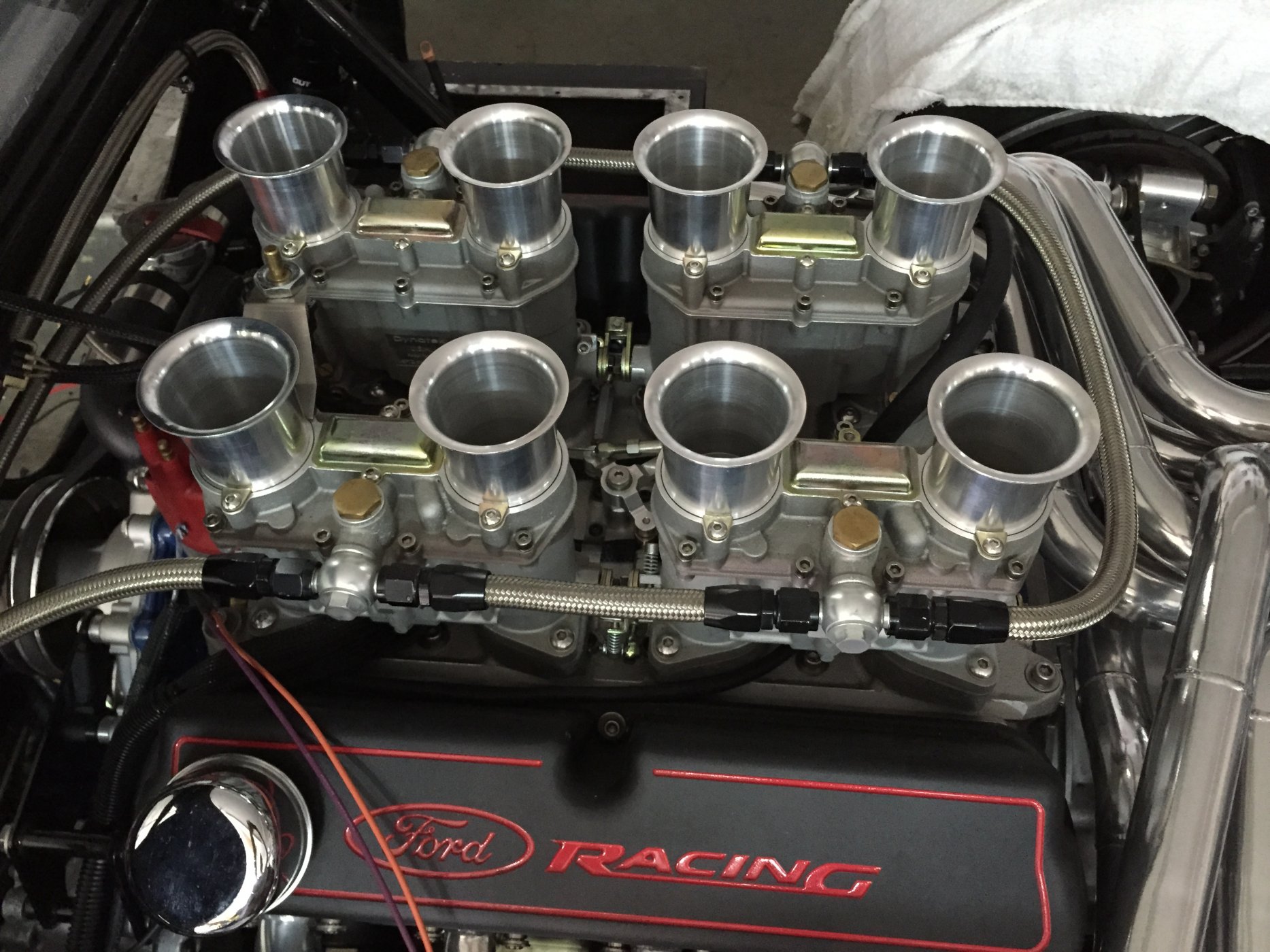

RCR GT 40 Gulf Livery 347 Eight Stack injection

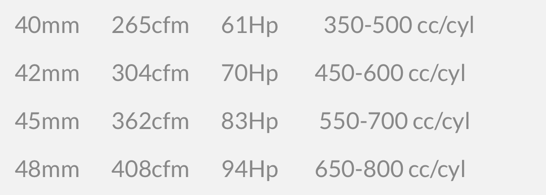

Can't recall or find what I used to calc for allowed HP with 48mm ITBs, but thinking it was 550-570. Mine start out at 58mm at the top of the ITB (where the tubes attach), and smoothly reduces to 48MM by the time it gets down to the throttle blade. My goal was 500 HP, so I knew I'd be under the max based on the calcs. My interpretation of information I've read is that the taper and the stacks (they were cut to a specific length as well for max tune at 6K rpm) are helpful as well.
Is quite a bit of science to work out things like that. All depends on how you want to use the engine.

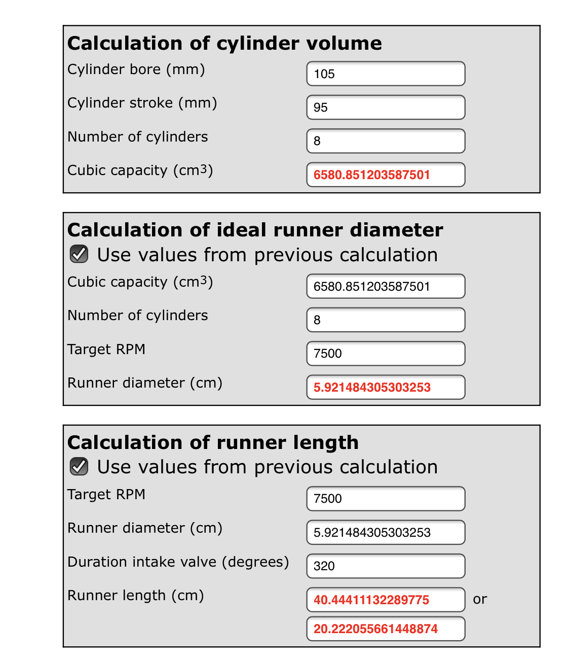

This is basic generaliststuff that I’ve found online before. The second is a calculation using my bore and stroke (3.750 and 4.126)
I have seen people staying wildly different figures for the above also.
