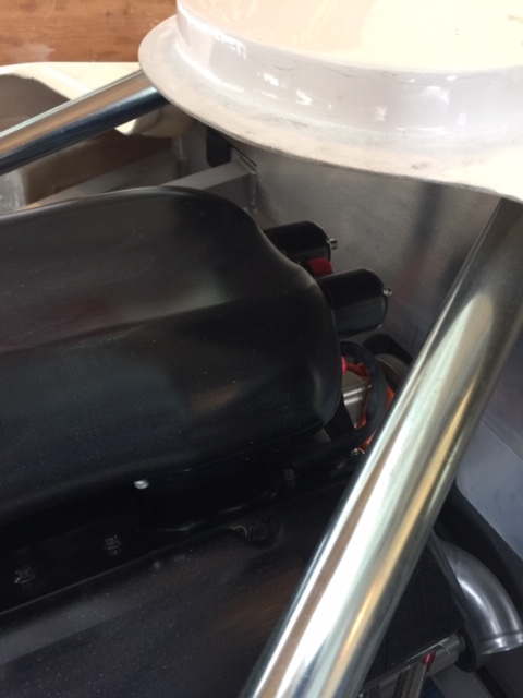

Wow... I have a meziere belt driven pump installed now. I have an Alien Intake and it blocks the traditional waterneck option for a SBC. There is a an-14 outlet which I assumed I could plumb in a remote thermostat. The lower hose is totally accessible. The firewall has already been modified to fit the pump. Its just the plumbing that worries me. Would you still recommend a remote pump?

My hoses are accessible, but when the pump fails the engine has to come out. Same as most of these builds. If you can get the pump off the front without moving the engine, you are golden. Being a stickler for ease of service, my car would have had a remote mounted electric pump in it had I thought of it way back.
Ok... I'm going to start researching tomorrow. I totally get it! I can tell you this... I don't want to take my engine out after I have this thing built!
