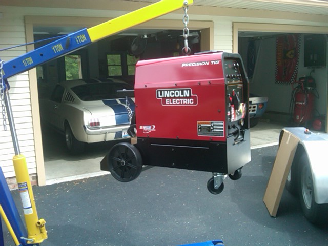

I bought a Lincond 225. I would do it again in a heartbeat. I have paid for it 3 times over by now. This was my first tig experiance. I was able to figure it out in a matter of hours.
I have welded everything from alum to stainless steel tubing. It has enought power to weld on the chassis of my SLC, 250 amps, and goes low enough to weld stailness steel water pipe, 20amps.
Very good machine. The pro welder who has helped me said it is all anyone would ever need. If I was to do a lot of high power welding all I would need is a water cooled torch.
Get a 35CF tank. Bigger is hard to move around and it is big enough to last many hours of welding.
The most important thing is a really good helmet with a electronic darkening eye shield. Buy a good one.
This isn't the cheapest way to go but you won't have to do it again.

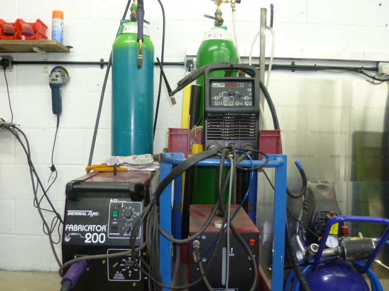

Last week I got myself a Cebora 220amp single phase Tig welder.
I had a demo of this and thought it was more than capable for anything I needed.
A few days later I set it up and tried welding thin plate. Forgot completely what the sales guy told me but after a phone call all was put to rights.
Except It's not as easy as mig welding and I seem to have got through the odd few tungsten tips and created some serious snot on the plates. That's all part of the leaerning process I guess.
Anyway about half hour later I managed to get a reasonable good weld on two 5mm ally plates.Adjusting the settings to what suits me.
Time will tell.
