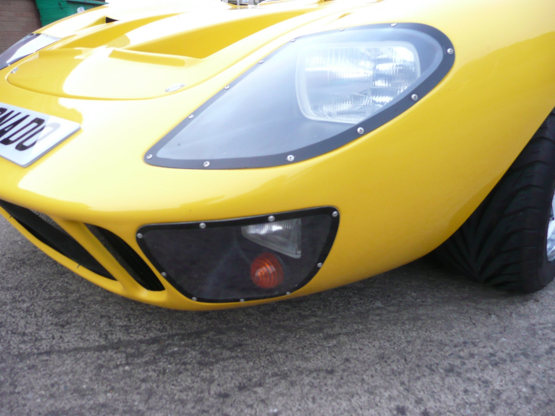

Hi guys, I still make the headlight and running light covers (over 20 years now) out of crack proof plastic. I've made them for all replica makes and some original cars such as prototype GT103. Email me at: [email protected] so I can send photos and details. Also, feel free to call anytime at: 816-286-6982 to talk about your car and the light covers. I'm asking $150USD/set of four covers shipped in the US and $180/set of four to overseas.
Thanks, Mark Clapp

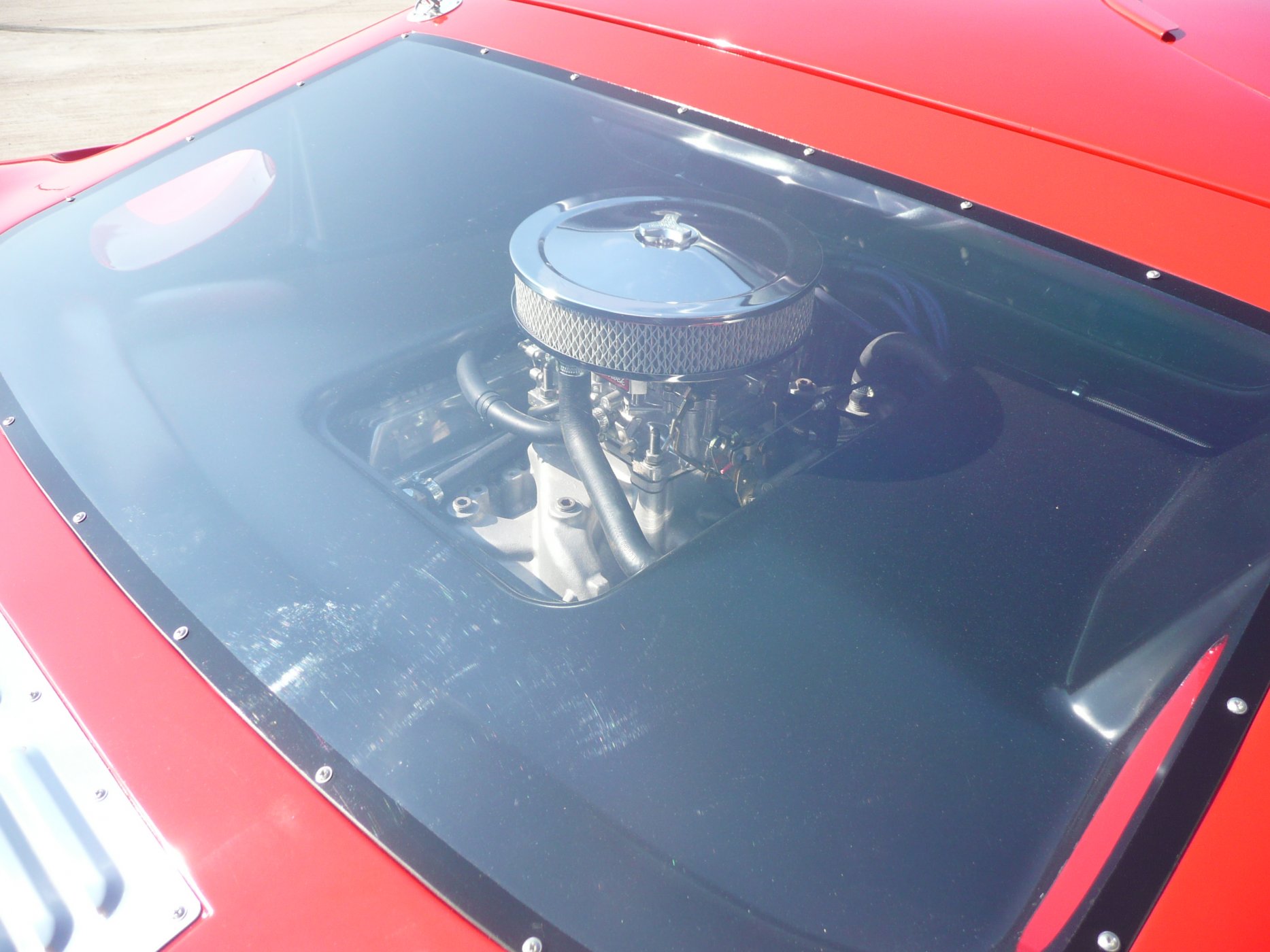

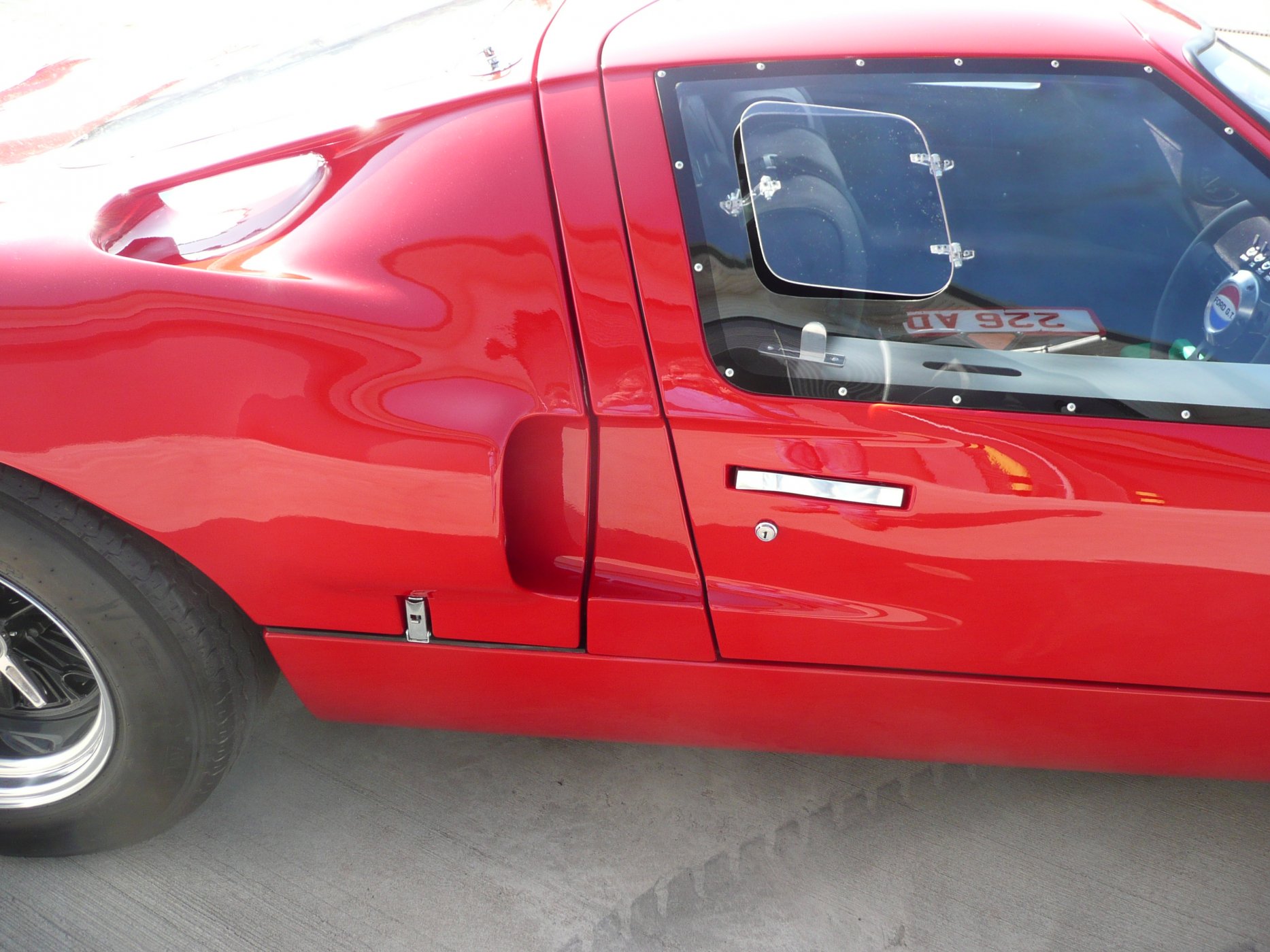

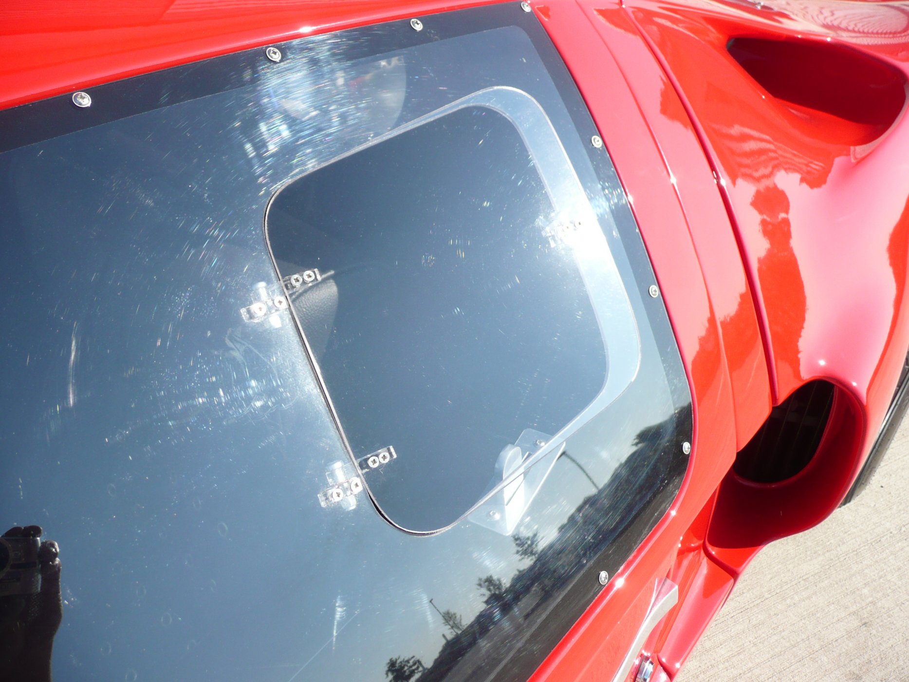

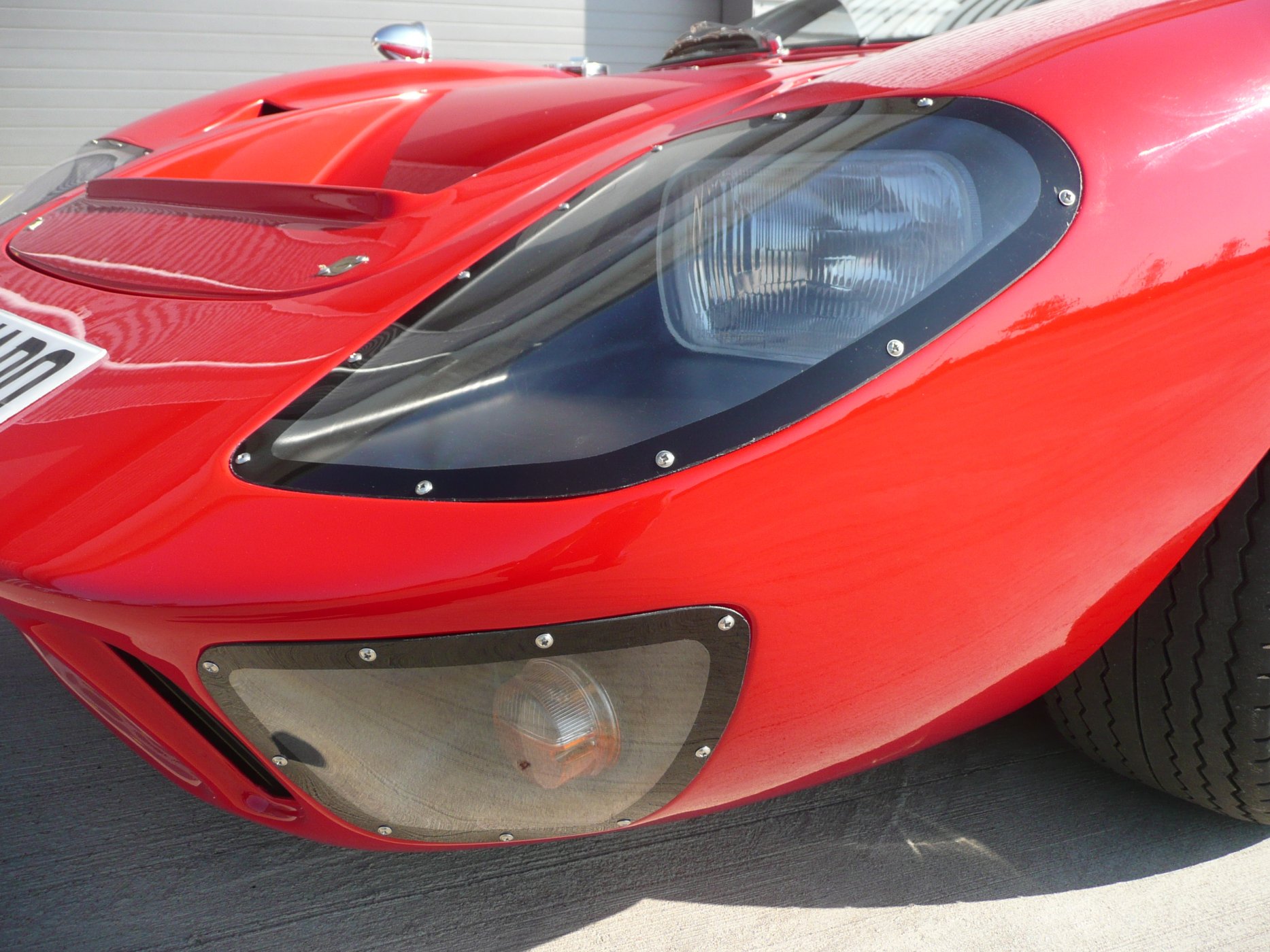

We are also able to supply full sets of headlight covers, spot light covers and side windows.
The side windows are available with a choice of plastic or Aluminium flap hinges and catches that are very similar to those used on original cars.
In addition we are also the only supplier of a curved rear window in plastic which eliminates the all to common rear window sag issue.
Andy

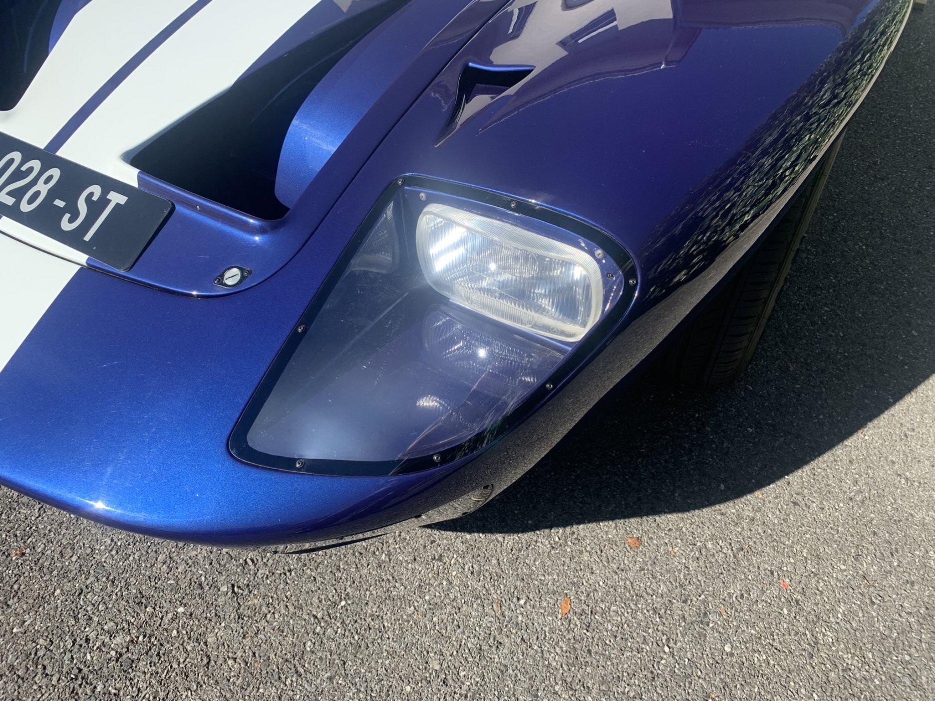

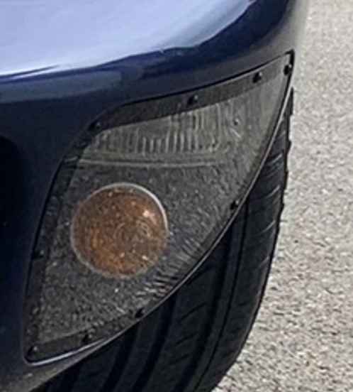

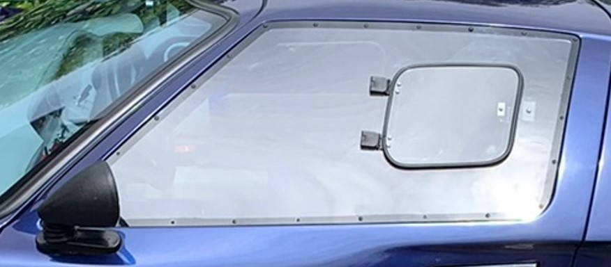

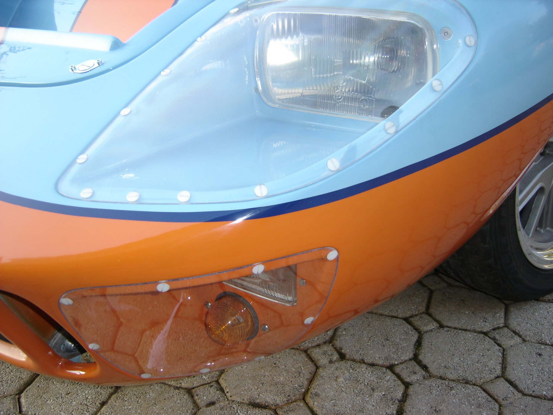

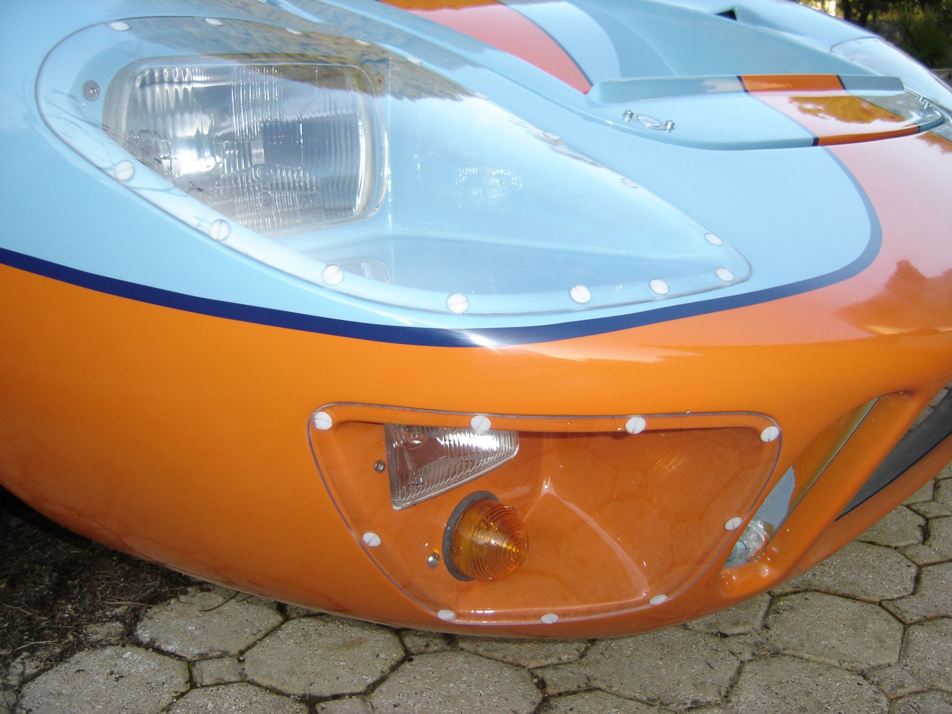

Hello, I have a GTD from 1991. I bought the 2 mm covers from Tornado for the light covers some weeks ago and after some adjustments I was able to fix them. They were bigger, no holes, no painting.
I put a screw on 2 as I think it gives a better look. I was looking to fix them without any effective screws but I didn't succeed.
For the windows and turn light covers I did them by myself with a 3mm polycarbonate thickness. Even if they were flat, it fits well for my eyes.
For your information, Franck from France
