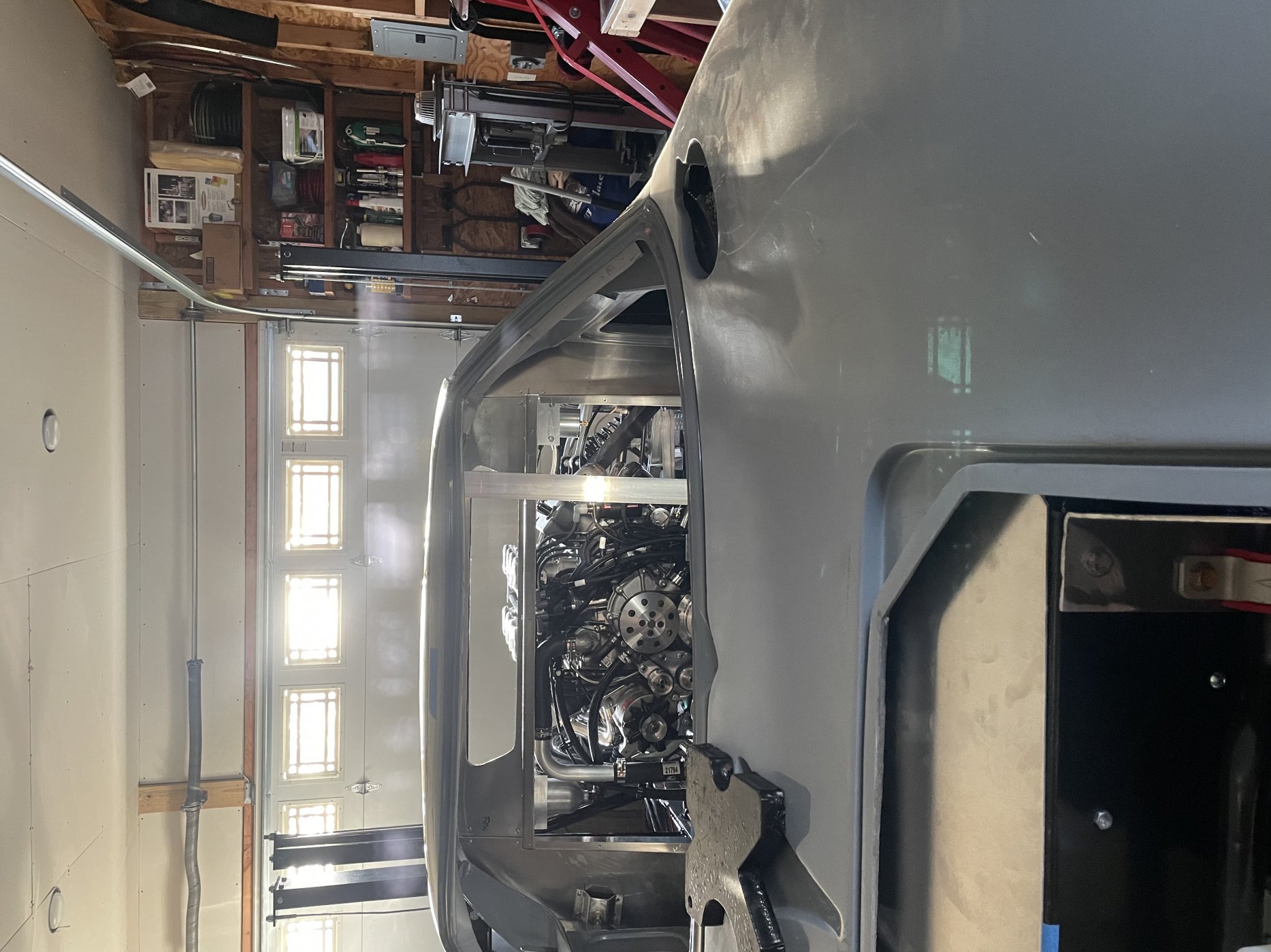

I had to raise the left side of spider to fit windshield and make car even. Once WS is set and i remove prop do i have to worry about it cracking from the pressure or it be good?

I used infrared heaters to heat up the spider and rechape it using some timber between floor & roof to raise the spider so the screen sits flush.
Heat it up, bring it into shape and cool down quickly with towels soaked in water.
It might need a few attemps.
Got this tip from David Hart Racing crew after Oliver Hart ended up on its roof with their Gelscoe forty and the Gelscoe replacements pannels didn't fit.
Wow - I heated my spider up to 200F to get it to go back to where I needed it to. I let it cool slowly though rather than chill it. From that point forward, I had a prop holding up the center of the spider until I welded mounts to the top of the roll cage that the spider was then fastened to..

I’m trying the heat.I don’t have full roll cage to attach front to, I’m going to try another direction with it. Instead of of Propping left top up I’m going to try to pull bottom right down if that makes sense lol
