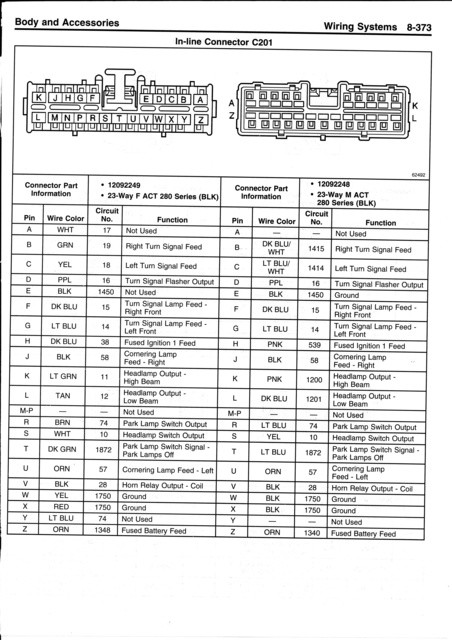

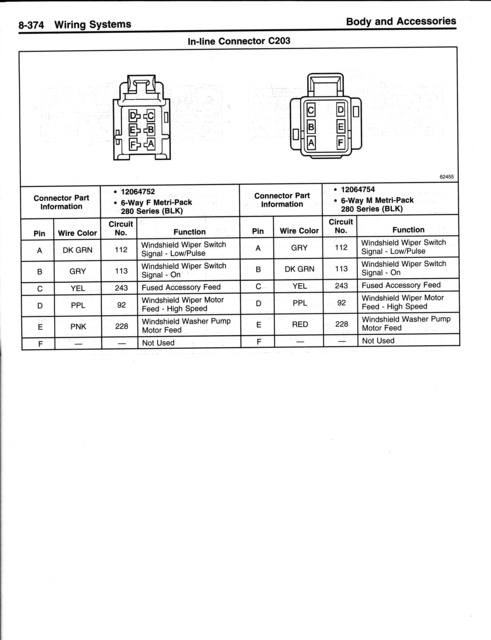

On mine, also delivered in 2014, I had to re-pin a few of the steering column pins because they were incorrectly wired when I received it. I can't recall which ones, but have attached the pinouts of the connectors so you can check.
Tony
