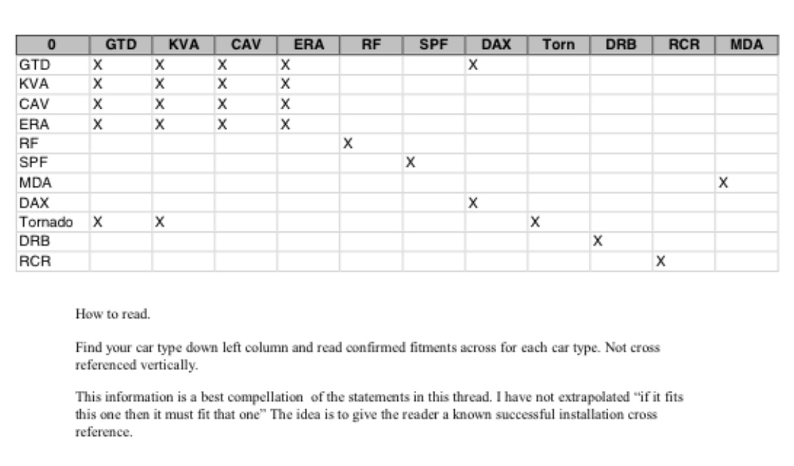

The document came up for me so I took a snap-shot.
This chart does not guaranty that there are not still more valid combinations, just that they had not been documented.
IE - RCR and SPF may well be interchangeable, but no one has tried it and come forth with the information.
I don’t think you’re going to find a $200 Safelite windshield that will fit as the GT40 windshield is unique to the GT40 Mark it was made for.
Some time back, there was someone who checked the fitment of the 1st generation Factory Five GTM windshield in an RCR. This was confirmed at the time by the owner of RCR as a suitable fit.

The chart above explains why my replacement windshield from SPF (from Hillbank) four years ago cost $1,800!
Thanks for the chart. I can get a new windshield from the company that made my spider shipped for $1,000. Does that seem like a fair price?
Based on the cost of one from Superformance, I think I’m ok.
