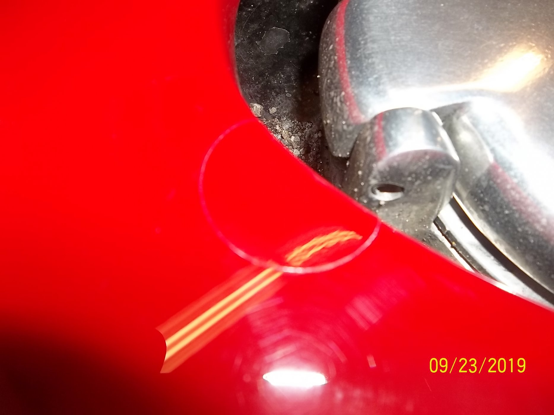

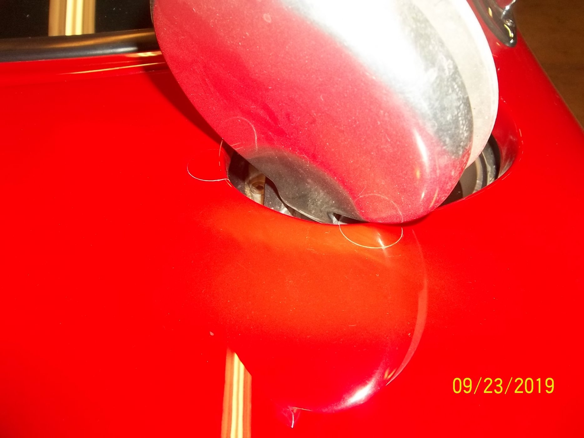

You put two round pieces on the gas cap opening where the cap will contact the paint when flipped open. The under nose is a good spot to protect. My MK II has the upper nose done as well. I will post pictures later. Olthoff can handle this and they know the spots to protect.

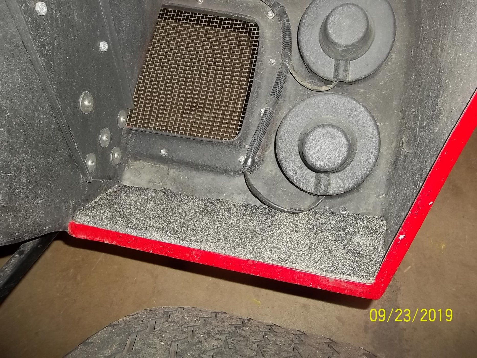

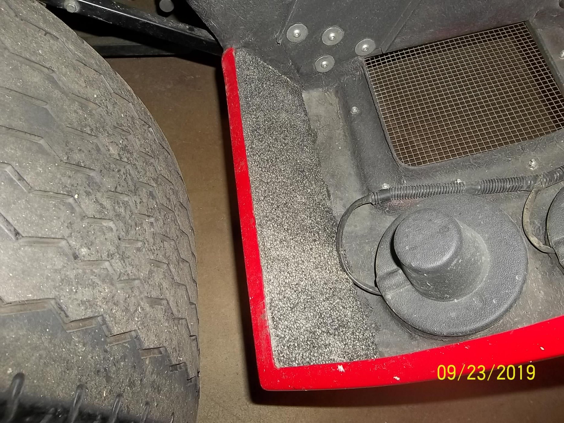

Here are the fuel filler protectors and also foam fillers you cut and glue to prevent the rear clip returns from filling up with stones and gravel.
