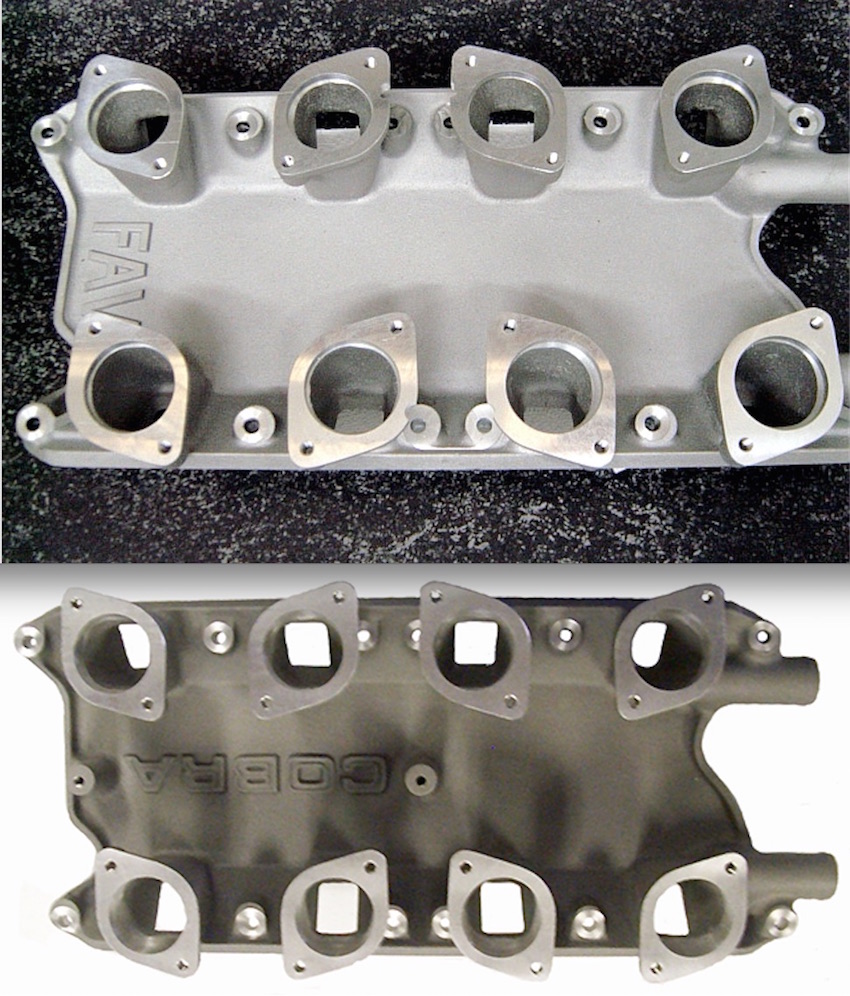

I don't think there is any difference in Weber orientation. However, I believe this water outlet is peculiar to the GT40.
Brian Stewart
One other point of difference is that Weber orientation is different on the twin outlet manifolds vs most single outlet ones. i.e. fuel line is on outside for both banks on single outlet manifold while fuel lines are on outside for one bank and inside for the other with twin outlet manifolds.
That is interesting information. Thanks for the pics too! I noticed most intakes are designed for 48 ida carbs will 44 idf carbs bolt to the manifold without modification?
The manifolds with carb fuel inlets both facing outboard favour the idle and part throttle mixture being biased to the upper part of the port runner, whereas the manifold with all carbs facing left or right will have one bank bias the flow to bottom of intake runner and other bank to top. Two outlets seem to work better for race applications, for cars n coffee applications it probably wont matter to much and most of those guys are more concerned about heater operation along with A/C.

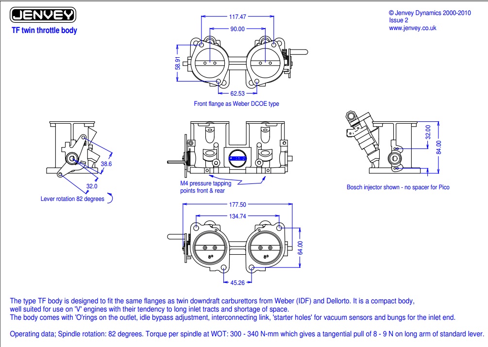

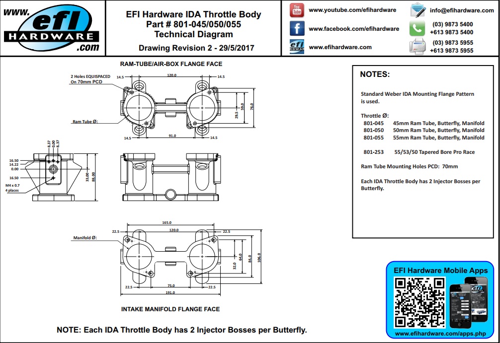

Gents
The IDA vs IDF fitting is quite different
I have attached a couple of pictures for your reference
IDAs have 120mm centres where IDFs are 90mm so no they don't fit on an IDA manaifold
For the average guy IDFs are less fussy to look after in particular with regard to accelerator pump as they use a diaphram which is less likely to give trouble than the IDA piston system.
In either case good filters and good fuel solve those problems.
For personal preference go for an intake with built in thermostat housing unless you have enough gear to build all that.
Regards
KB

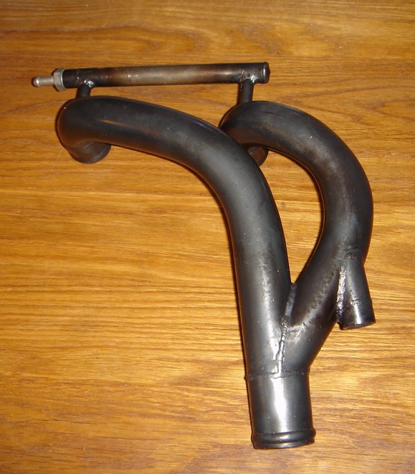

A remote thermostat housing could be built and put in place where the two outlet lines merge into on pipe. I wouldn't think that would be too difficult to fabricate.

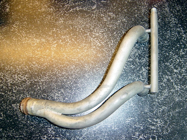

mine is a 'cobra' twin inlet with this made to order....
Doc what is the little pipe that connects to the top of the two main outlet pipes? Also what is the extra outlet above and to the right of the main collector? Excuse me if I am wording all of these parts poorly, I have zero experience with this type of cooling system.

You see very little and what you do see, it is a struggle... Frankly, I feel its one of those components of originality that can be overlooked for more modern convenience and packaging of an integral thermostat and a single hose. It will change nothing in terms of performance or efficiency to run dual hoses.
