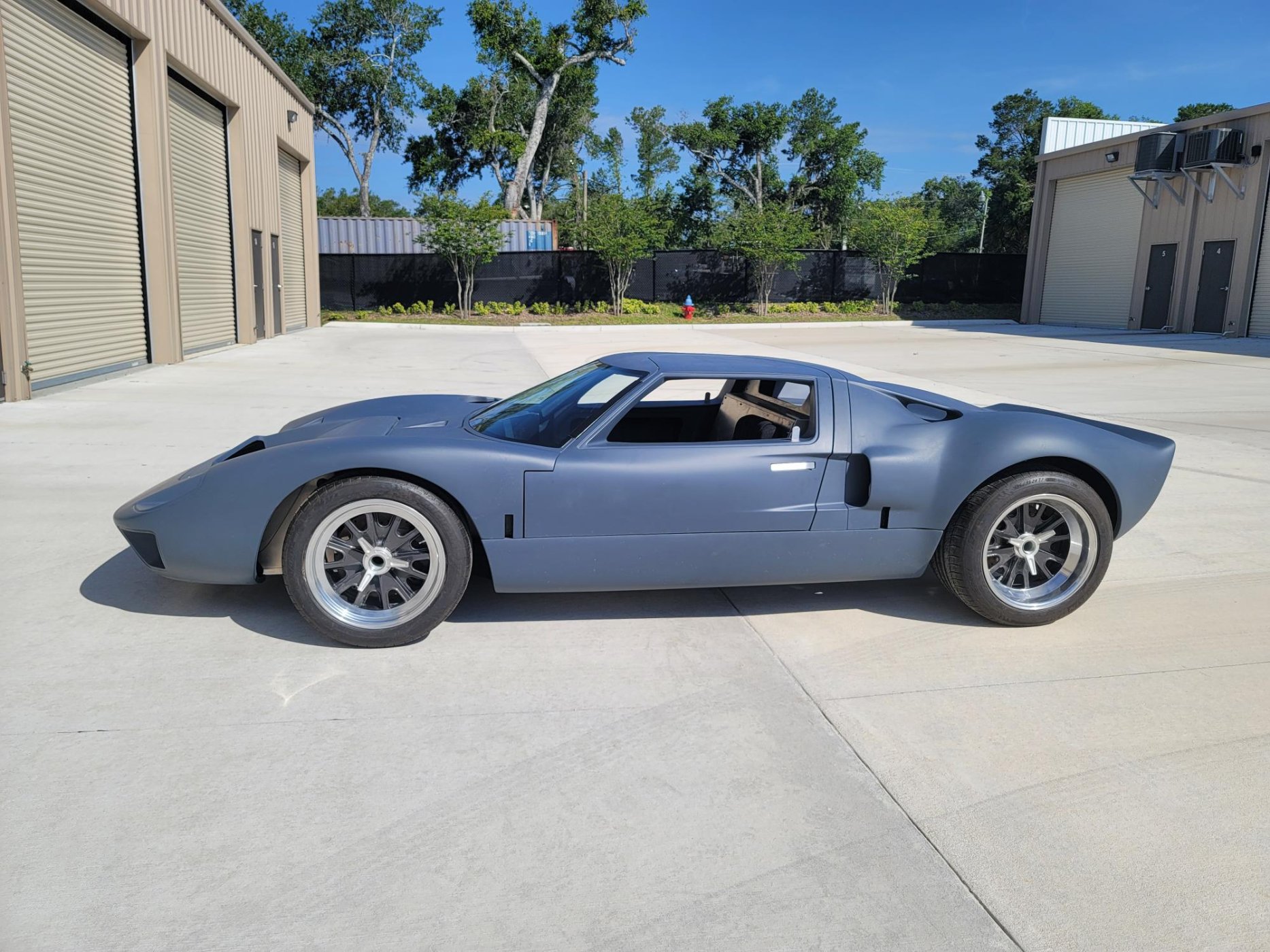

This is the Active Powercars +4" inch car. I'm not tall, but the cockpit is built for taller people. You can see the door is "longer" but, it still looks GREAT..!!
Ben

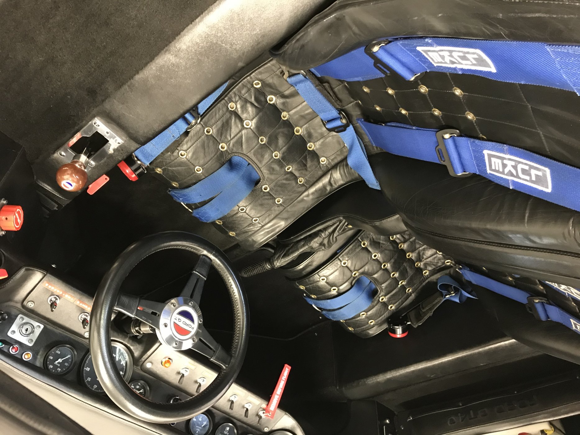

I’m 6’2” and 99 kilos. I fit OK in my GTD. Seats are aluminium tubs fixed to the floor leather covered - this really adds to the space. No Gurney bubble. No seat padding but being set up for road and race it makes no difference then Frank Catt moved the pedal box forward for me.
I‘m in East Yorkshire. I seem to remember Frank telling me he had lowered the floor for someone 6’4”.
