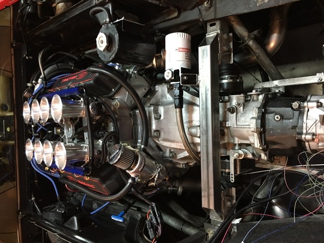

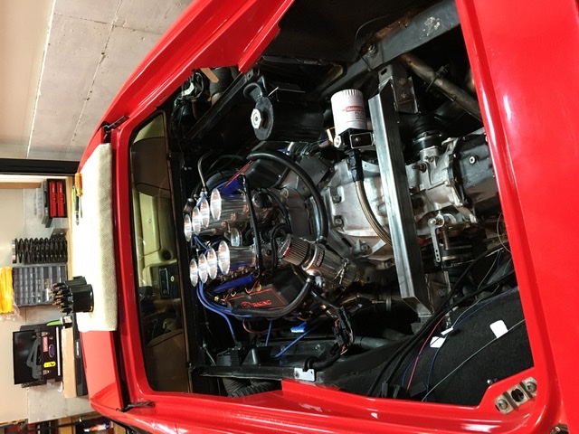

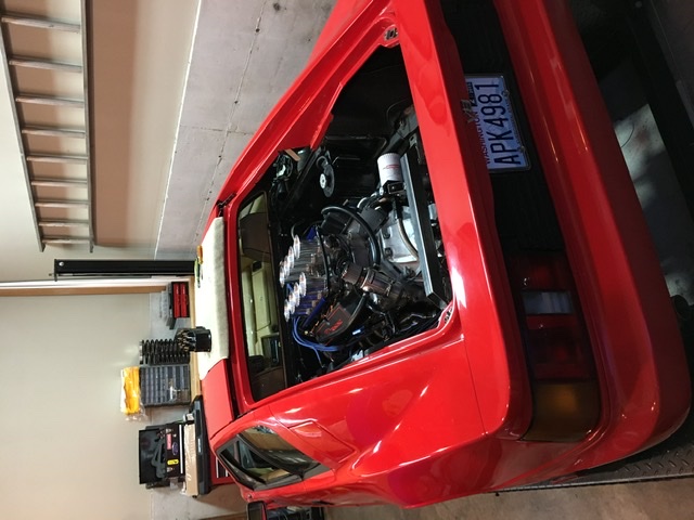

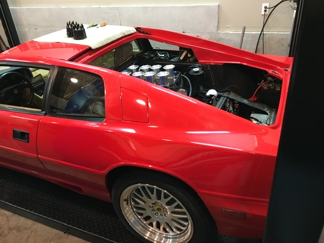

As my health is improving I'm starting to get back out into the garage and want to complete the improvements to my Lotus Esprit 347 ITB Ford project. I have a number of things to do including improving the shift linkage, adding some further cooling, powder coating some parts that'll need to come out/off the car (engine mounts, chassis cross bar, door handles), adding some insulation, etc.
One thing I really need to improve is the gearing of the particular 016 in my car. It's an old Audi 016 (with a porsche lsd installed) with trans code AAZ. I really like these old 016's as they're light weight, easy to shift and can be made relatively strong with the addition of an LSD from a porsche 944. The problem with the AAZ coded 016 is that it's pretty high geared....on the freeway at 70mph the engine is turning 3,300rpm.
I think there may be a different (lower geared) CW&P available for the 016 out there somewhere, but I'm not sure....will have to research it.
For the moment, does anyone have an 016 sitting around their garage they would like to get rid of? Perhaps one with a code of 5N or AFC?
I'd be interested in hearing from others still running 016's for their experience. Thanks in advance.
the pics are a bit old....the car is fairly complete and running now....will add some new ones.....
