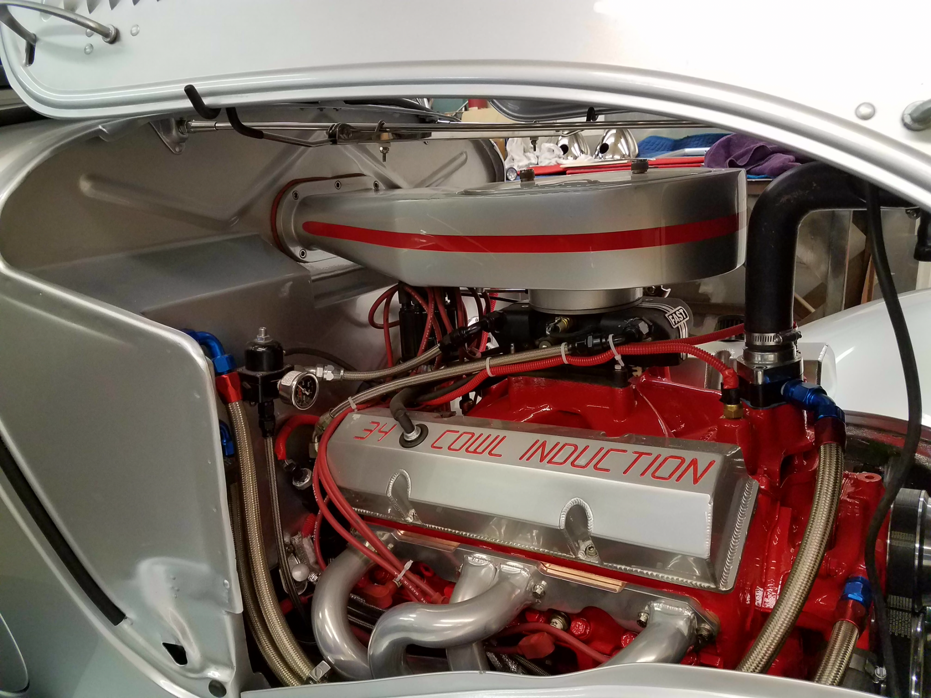

I was originally going to use a mechanical stack injection on my car but decided that it was another thing with a learning curve that I did not want to tackle. I finally settled on a Proform 850 racing carburetor- mechanical secondaries, no choke, etc. It is essentially a modernized & upgraded Holley 4-barrel. It worked right out of the box on my 383 Donovan running a Crower 00427 cam. The Injection sure wins on looks!

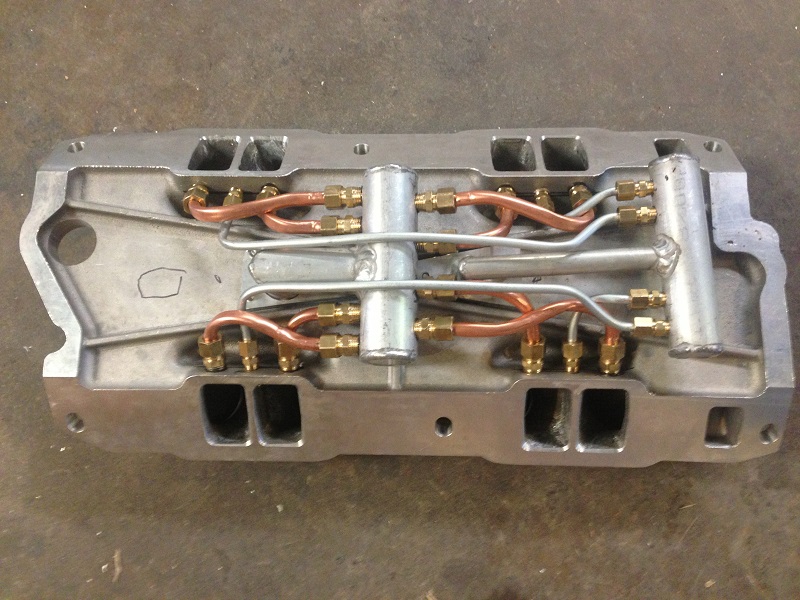

I did modify the manifold by adding 2 separate chambers in the valley. One with large 3/8 tubes to each port and to a Ford solenoid type idle air controller. It gives the added benefit of letting a lot of air bleed from port to port making the sync on the throttles far less critical. The second chamber is with small 3/16 lines for a good MAP signal.

The 3/8 copper tube on my setup gives enough air to make the sync not critical.
But you are correct in saying it is critical without this provision. Far more so than with 4 webers because the EFI will dump the same fuel in each cylinder. With 4 webers, 2 may pull harder or less, but they will at least have a consistent AFR. with EFI, the AFR will go all over the place at idle unless the throttles are perfectly synced.
