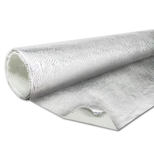

Hi Steve
This stuff?
It looks odd in the restoration photos...no discernible weave to the fabric.

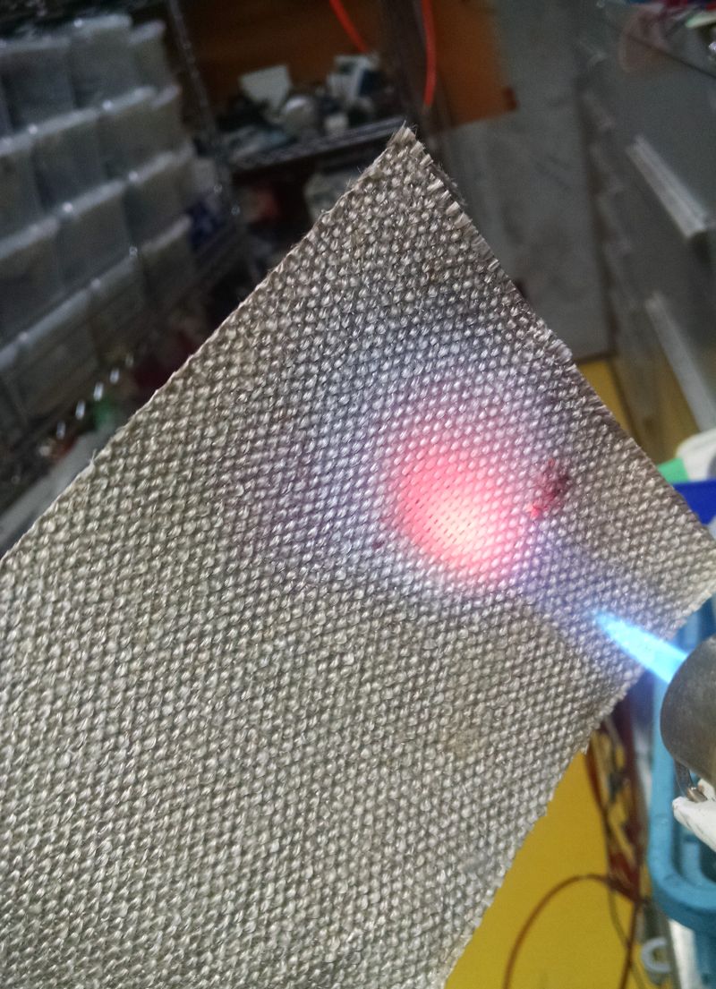

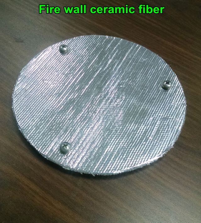

I used a woven ceramic fiber that has a thin aluminum foil facing that is similar to the material sold by Aircraft Spruce. I found a 75 foot roll on eBay about ten years ago and bought it to cover my firewall for additional thermal insulation. The circular part shown is an access plate in my extended firewall. To test the fiber's temperature resistance I applied a propane torch flame as shown.
